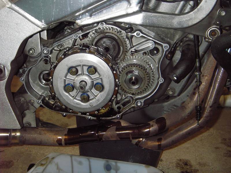

swapping balancer gears.
Just waiting for parts to arrive. The sprocket, with the springs inside, located on the crank, is going to be swapped for a raptor 700 sprocket. The benefit of the raptor sprocket is that it is solid, therefore no chance of the balancer getting out of sync with the crank.
Next winter i may want to split the cases and rip the balancer out, i´ll see how it goes.
