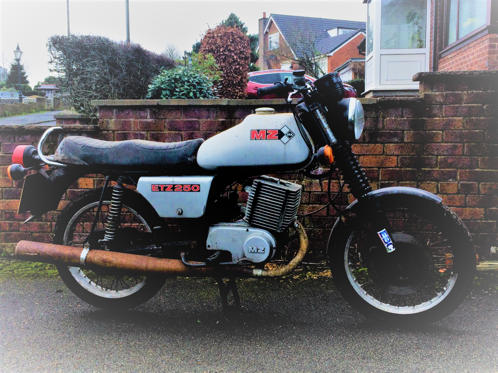

Postby Blurredman » Tue Jun 30, 2020 6:02 am
nice2day wrote:I will be riding the preferred MZ ETZ 250.
Speaking of which, I would like to see some pictures :) :smt006
1987 MZ ETZ300 - 40,000 miles
Posts: 1264
Re: Pipe dreams and conjecture.
Postby nice2day » Tue Jun 30, 2020 7:34 am
Appreciate your interest Blurredman...All I can find at the moment is a sellers photo of it. I might find more but when the rebuild continues I will take some updated ones. I have to say just looking at this photo spurs me on...I reckon the ETZ 250 looks wonderful... :P
Les
nice2day
Posts: 250
Postby Puffs » Tue Jun 30, 2020 9:57 am
Nice!!!... but it would benefit from some clean-up, as you are doing.

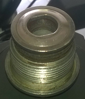

Coming back to the wandering & hesitant steering (viewtopic.php?f=19&t=10745&sid=e6de041668dde1213c024bcde9a7fa13#p52114) you perceived Les, I was looking inside my fork the other day, and I found some washers I had put between the stop and the (standard, original) spring. That extra thickness will give a preload, which will increase the ride hight and alter the steering angle slightly, making it less twitchy.
I looked in the forks as it dived too much on braking. After the forks were rebuild, they had an oil level of 32cm from the bottom = 42cm below the top, which is a more practical indicator. I had also given it 8.35mm preload with those washers:
Preload washers, 8.35mm.jpg (30.98 KiB) Viewed 2351 times
(The one on the spring is steel, the rest are fibre.)
Now I added 2 more washers at each side, raising the preload to 11.5mm. I also added 50cc oil to each side, raising the level to 35cm from the top (=39cm from the bottom). The preload changes the ride height, the higher oil level makes the spring action more progressive.
Adding a few washers might improve how your bike handles. It's an easy thing to try.
The other question would be: in what way are those racing springs different? Was it better with the original springs?
