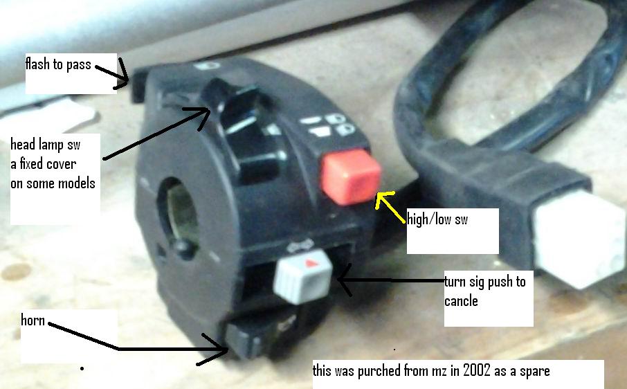

Postby DAVID THOMPSON » Sun Feb 15, 2015 6:22 pm
on the left side some have a headlamp on off switch
on my rt125 from 2002 it was a locked dummy on all the time
due to a lack of dealers back in 2002 i ordered some extra stuff
the spare looks the same but the switch works its not a dummy

Postby suzukix7 » Wed Mar 18, 2015 3:39 am
Hi, thanks for the replies, I forgot to mention that my bike is 1979 TS150.
The switch I want to identify is on the left (as you sit on the bike) handlebar switch cluster, in between the horn switch and the pass light switch.
I'm pretty sure it is a kill switch. If so should it be switched down or up to enable the bike to be started?
Many thanks Dave

Postby Agronski » Wed Mar 18, 2015 4:25 pm
Got a photo? Because even on the "Luxus" model there should be only one switch on each bar: the indicator switch on the right (three position toggle) and the light/horn switch on the left (2 position toggle for high and dip beam, plus 2x push-buttons for horn and high-beam flash) - you can double check by looking at the simplified wiring diagram: http://www.sweller.co.uk/mz/images/wr_tsd.gif
If there are other switches, they're after-market and added by an over-zealous owner ;)
The TS150's never came with kill-switches, you just turn the main ignition key off to kill 'em. Check how many low-tension wires are connected to your ignition coil - more than 3 and you might have a problem...

Postby therealche » Wed Mar 18, 2015 6:48 pm
Agree with Agrnski... think we need a picture. The TS had the MZ up and down chrome boxes with a couple of small buttons on the left hand one

Postby suzukix7 » Thu Mar 19, 2015 11:06 am
Thanks guys, that has answered my question. It is the high beam switch!!!
At the time of asking none of my lights were working so assumed it to be a kill switch but now I know it's a high beam switch.
