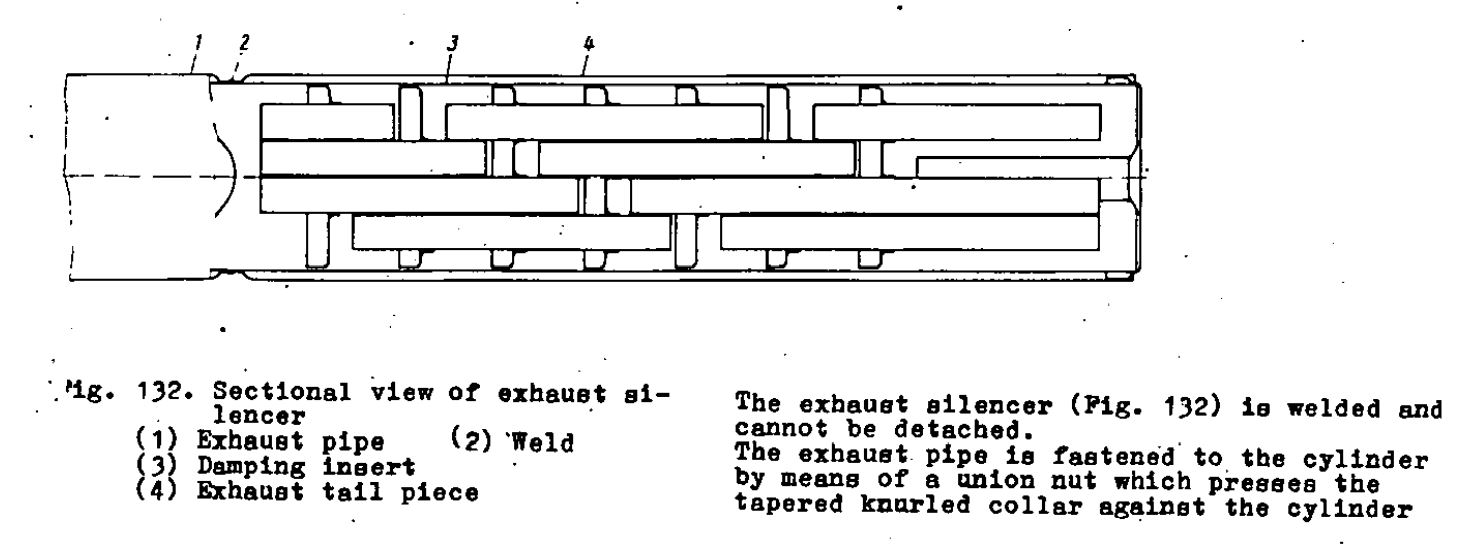

When you study the factory diagram of the the complexity of the original baffle system shown below, one gets a worrying feeling that the aftermarket copies aren't going to be anywhere near the same inside. It's very clever how the various length internal tubes are arranged. Each one will have a different resonant frequency and also different path lengths to the exit hole. This will blur the bang of the exhaust pulse after it has passed through the front and middle section of the silencer*, yet at the same time there is not really any barrier or restriction to impede the gas flow. The vertical bars are actually steel discs with a series of holes by the way.
*NOTE: This complex baffle is fitted right at the END of the complete silencer very much like a tail pipe muffler on racing bike expansion chambers but much wider. Indeed, the long front taper and midsection of the silencer are completely open/empty and unrestricted so what you have is a tuned expansion pipe system but disguised as a normal looking silencer....Ingenious as most things are with MZ design... :wink:

Exhausts and their tuning are a very important, particularly for 2T's. Resonance-wise, normally (tuned) expansion exhausts, but those do not damp the noise very well, so baffles & tuned pipe lengths is what you find inside road-approved silencers. And yes, details matter.
Also, while the engines of the ETZ251 and the ETZ250 are largely identical, there are some differences in the port timings and the header pipe, hence also the silencer. In aftermarket silencers this may be ignored - one size fits all. Of course at a price you can buy a dedicated silencer.
