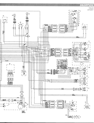

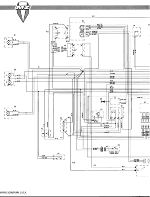

Postby DAVID THOMPSON » Fri Aug 13, 2010 3:00 pm
files for the wiring drawings
and i am looking at drawing to see what is shorting out
explane where the fuse is that blows again

Postby MattyP » Mon Aug 16, 2010 8:58 am
I beleive it is the 15a fuse in the box labeled 25 in the file. It runs from the battery to
what appears to be a relay (K7) and the 'rectifier' (voltage?)
thermal switch for cooling fan
one of the big plugs under the gas tank.
But again, this (electronics) is not something I know anything about.
Thanks
matt
