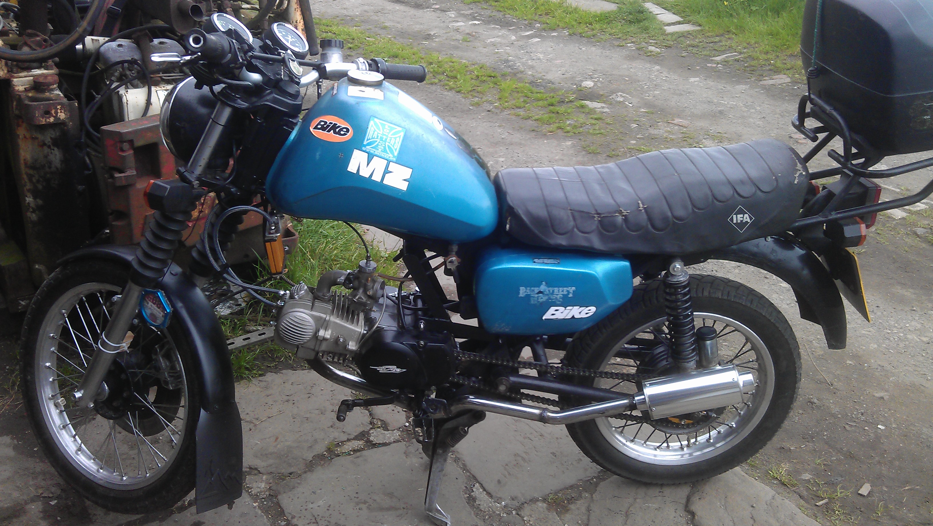

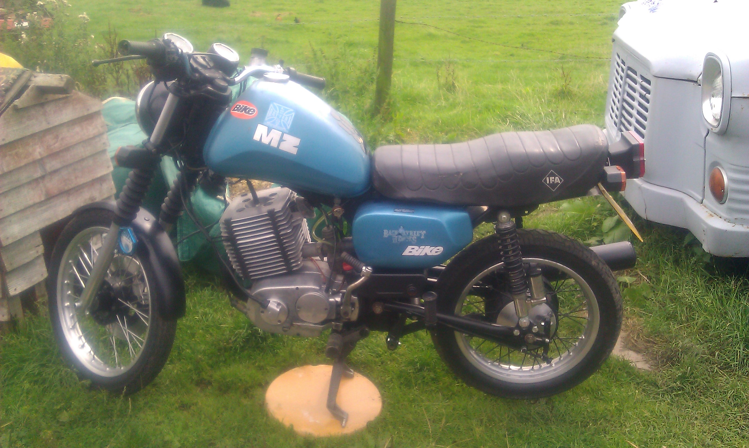

I got my mz back on the road in September.worked out its doing 30 mpg.does anyone want to swop for a Honda ss90 or a riders cub.before I do somthing like this.

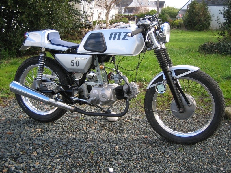

yes it is English gallons Dave.going to strip and clean carb and reset.but not expecting much more.Geting a 140cc pit bike motor next week.need to get and make a few bits so it will go in mz.then put me and the mz on a diet.

some of the guys over here are making the homemade bikes using the pit bike motors
and some are going to extremes
try this
http://www.motopeds.com/
site has a lot of info thats of use

yes the motopeds look good.fx bikes are another.not keen on the mountain bike wheels.I have only seen a couple of the home made ones.when my kids where younger I put a Honda c 90 in yamaha dt 80 frame.we called it the hahaha.

new rings 3,000 miles ago.polished the piston top and head back then.the exhaust is very old.
