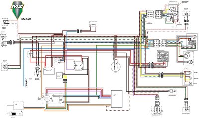

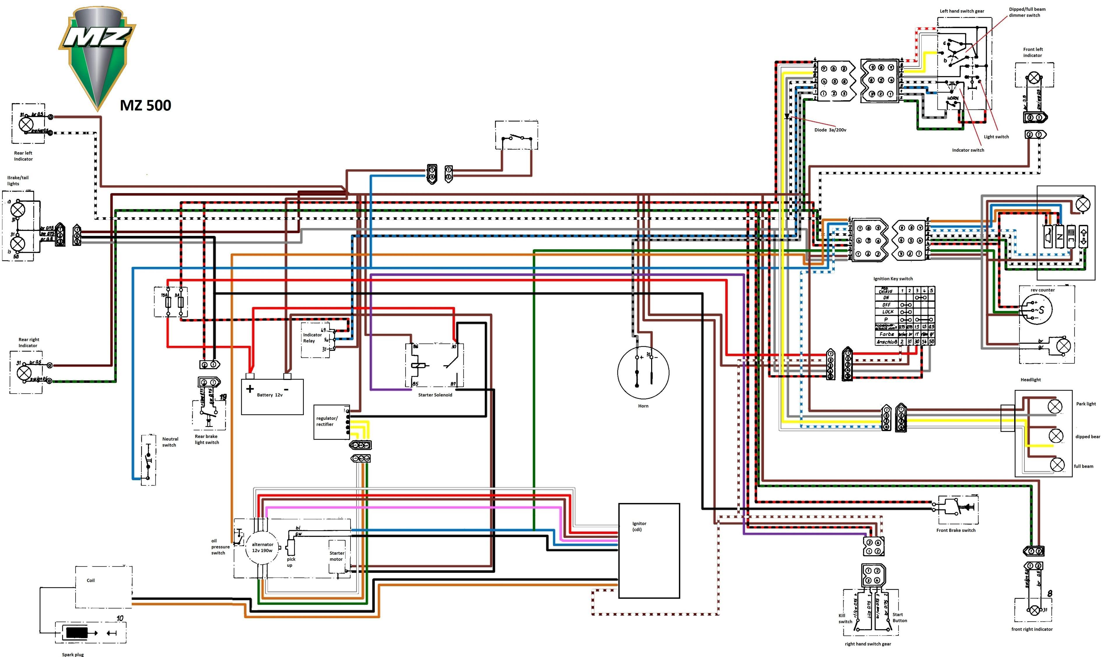

Postby DAVID THOMPSON » Tue Feb 26, 2019 4:11 pm
check the big ground wire (minus) from engine to battery mine came loose at the engine
and caused a small BROWN wire to smoke when i was starting the bike
