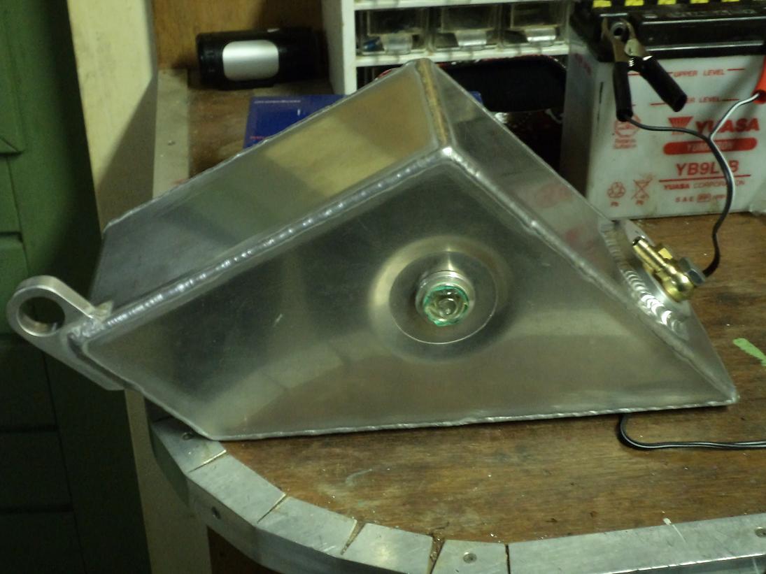

Postby texoot » Sun Mar 25, 2012 2:56 pm
Or make a custom oiltank with a spy.I don't have a dipstick anymore.It contents 2liter to the spy,total contents about 3 liter.

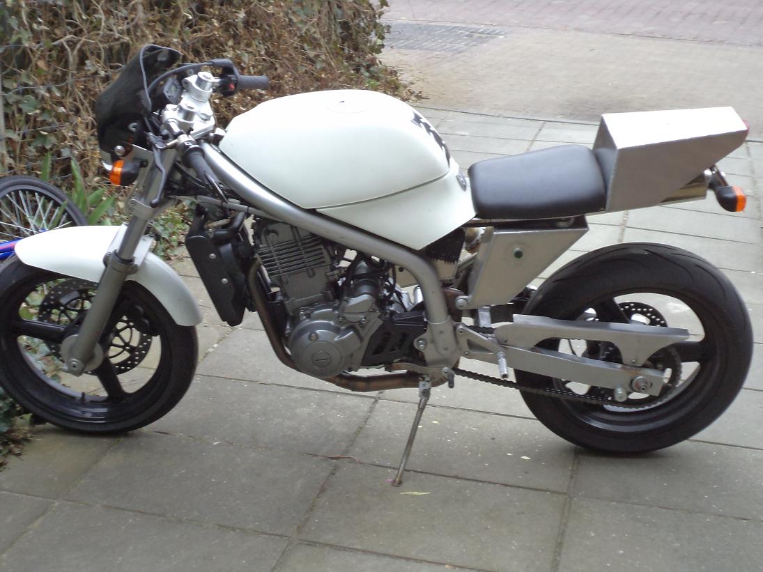

Re: Trouble checking oil on Baghira
Postby basser23 » Sun Mar 25, 2012 3:15 pm
now that is nice!!!
is this on your Skorp?
Postby texoot » Sun Mar 25, 2012 3:24 pm
Yes,it replaces the stock plastic tank.
Postby harold » Mon Mar 26, 2012 5:01 am
That is a nice tank. On a Baghira though the tank is the front down tube of the frame, that the Skorpion doesn't have. More oil in a tank that releases the heat is always better.
