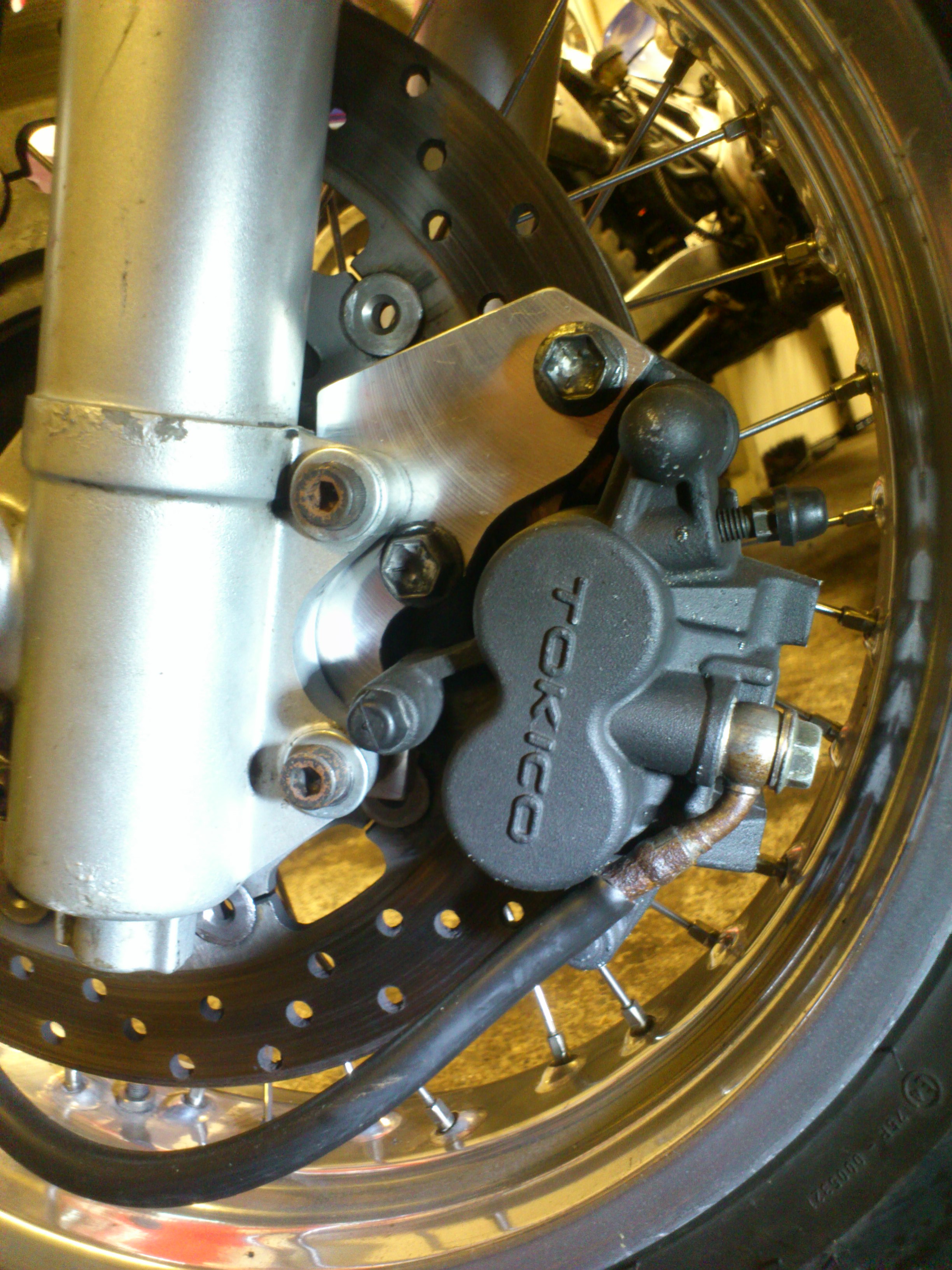

I've used a left hand Tokico 2 pot slider from a K6 650 Bandit. I had to make an adapter plate with some 9mm alloy plate but it was well worth the effort. Stoppies are no bother now as the set up works so well.

Hmmm, did you change the remote res as well? From some experience it's hardly ever the caliper that is weak it's the movement of fluid and that's controlled by the lever/remote res.

Is the mounting plate flat? (No milling needed.) Do you still have the template (the cardboard/paper) that you used? :)

Yes I'm using the origional resevoir and the plate is flat. I milled it to 9mm but I only used what I had kicking about. I don't have the template but I'll whip it back off over the next couple of weeks and do an update with some dimentions.

Thanks, that'll be good. Tokico is a good option, alternative to an expensive Brembo caliper.
