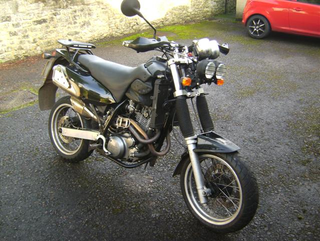

Hi.
I wouldn`t call mine a brace but simply a mudguard mount as it`s only 3mm (?) thick and only secured by four M6 bolts.
I`ve had rubber bellows type fork protectors on my Mastiff since new rather than the sort you have there and the fork legs look like new.
Cheers.

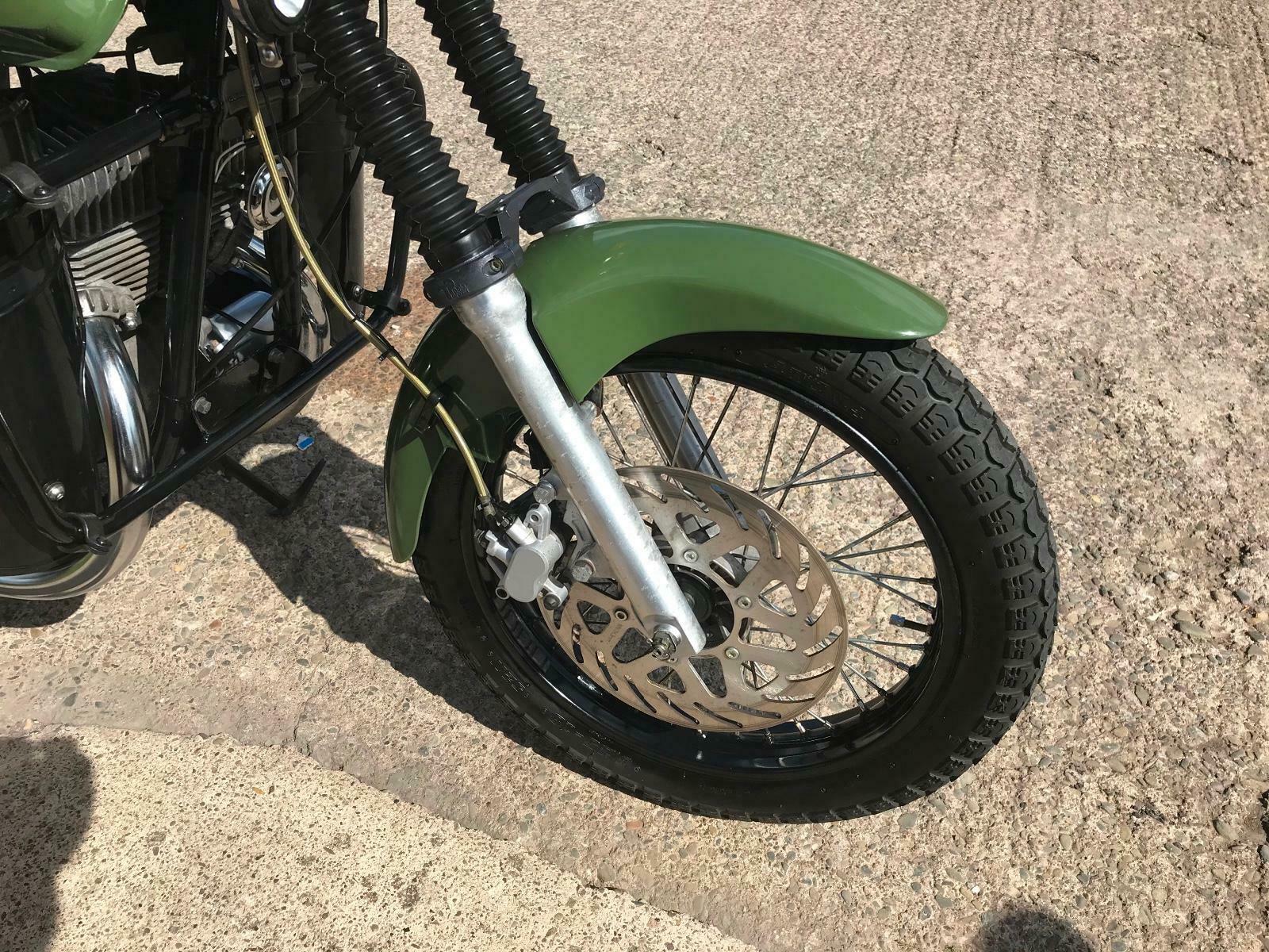

PS. This is much more of of a fork brace -

i like the rubber fork covers.. it is very dusty and dirty where i live in summer
and the forks chrome suffers a lot
i did it to my R90s in 1974 the first week i had it
Dave
