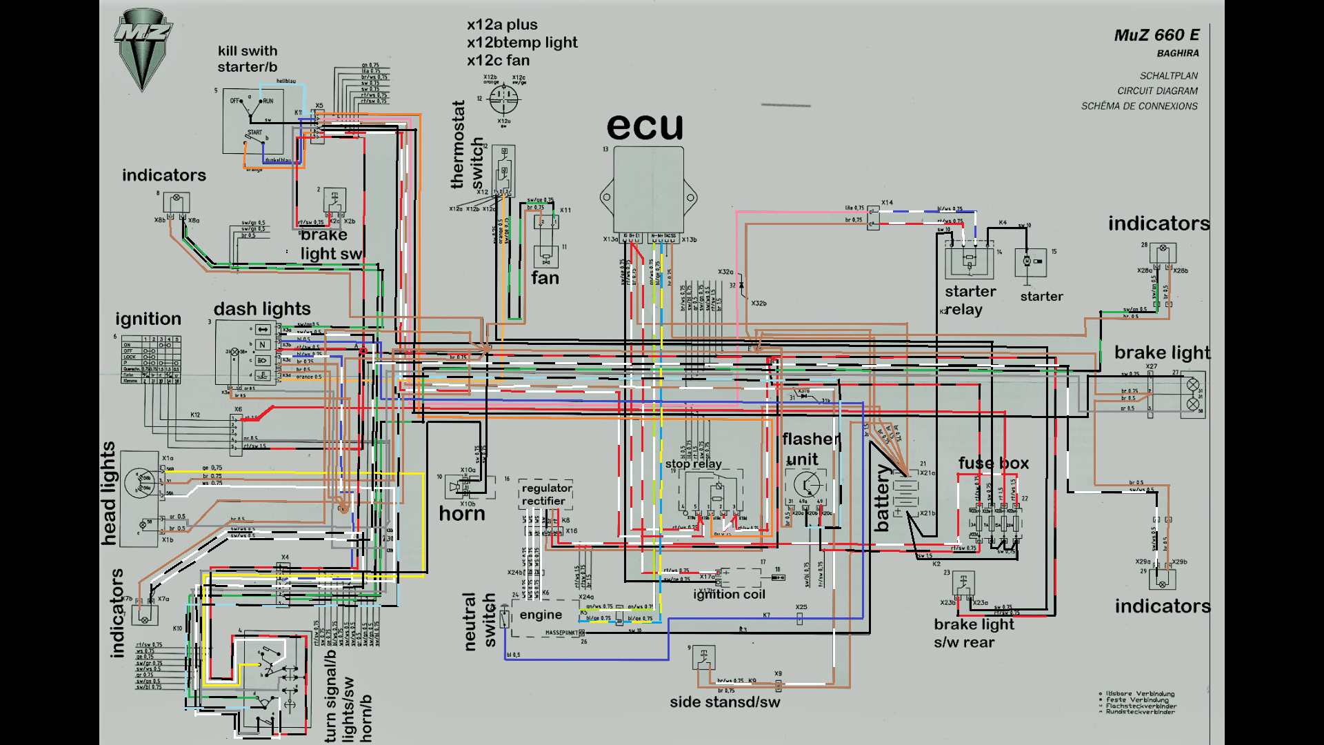

Postby funmonkee » Tue Jan 25, 2022 5:46 pm
looking to confirm which component this is on the attached... electrics schema
Which relay is this ?
which relay is this?
funmonkee
Posts: 133
Joined: Sun Nov 16, 2008 5:25 am
Location: edinburgh
Re: 2003 butchered wiring
Postby DAVID THOMPSON » Wed Jan 26, 2022 10:16 pm
the green wire gives it away its relay right in the lower middle
of the wires drawing and carries every thing it is relay 19
when it closes at power on the red black and red white get connected
and the bike is on
the green wire goes to transmission switch

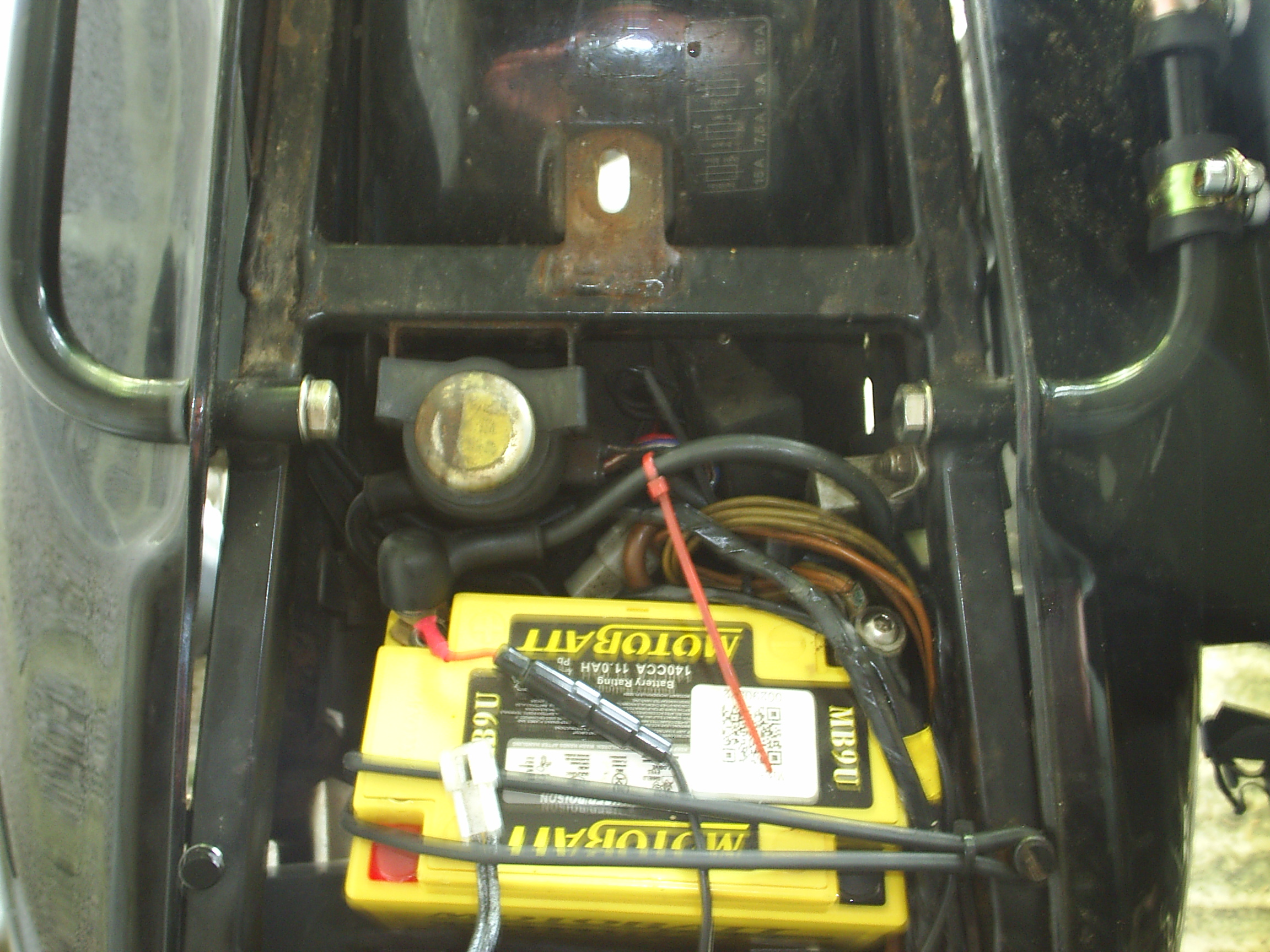

Hi.
Do you still want photos? Out in the garage later so can take them of my 2004 Mastiff.
Cheers
Postby funmonkee » Fri Feb 04, 2022 3:45 pm
Would be useful yes.
Would be good to see something other than my mess
cheer
funmonkee
Posts: 133
Location: edinburgh
Postby breakwellmz » Sat Feb 05, 2022 8:23 am
Hi.
Hope this helps, not the best of photos i`m afraid -
Cheers.
Postby funmonkee » Sun Feb 06, 2022 2:29 pm
thank you. that looks very clean
Postby breakwellmz » Mon Feb 07, 2022 2:56 am
funmonkee wrote:thank you. that looks very clean
TBH I'm getting sick of spending time and money on this bike.
anyone look for a clean example; but butchered electics... take it?
No worries.
Clean, really? I`m not one for cleaning and the wiring hasn`t been touched from new because it hasn`t needed it to be honest (new in 2004)
Perhaps you ought to step away from it for a bit before coming to a firm decision, i think you`ll get hardly anything for it as it stands.
Happy to supply further (and better quality!) photos if and when needed.
Cheers.

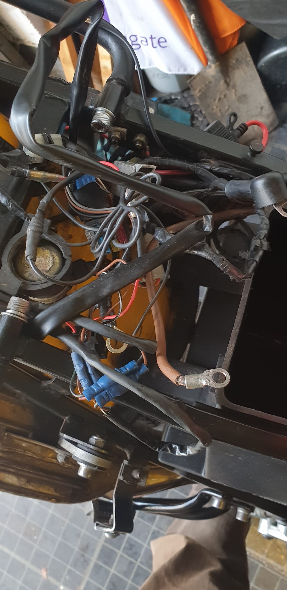

Postby Rizla215 » Sun Jun 26, 2022 10:09 pm
You call that butchered? May I submit:
Rizla215
Posts: 5
Joined: Thu Aug 13, 2020 1:21 am

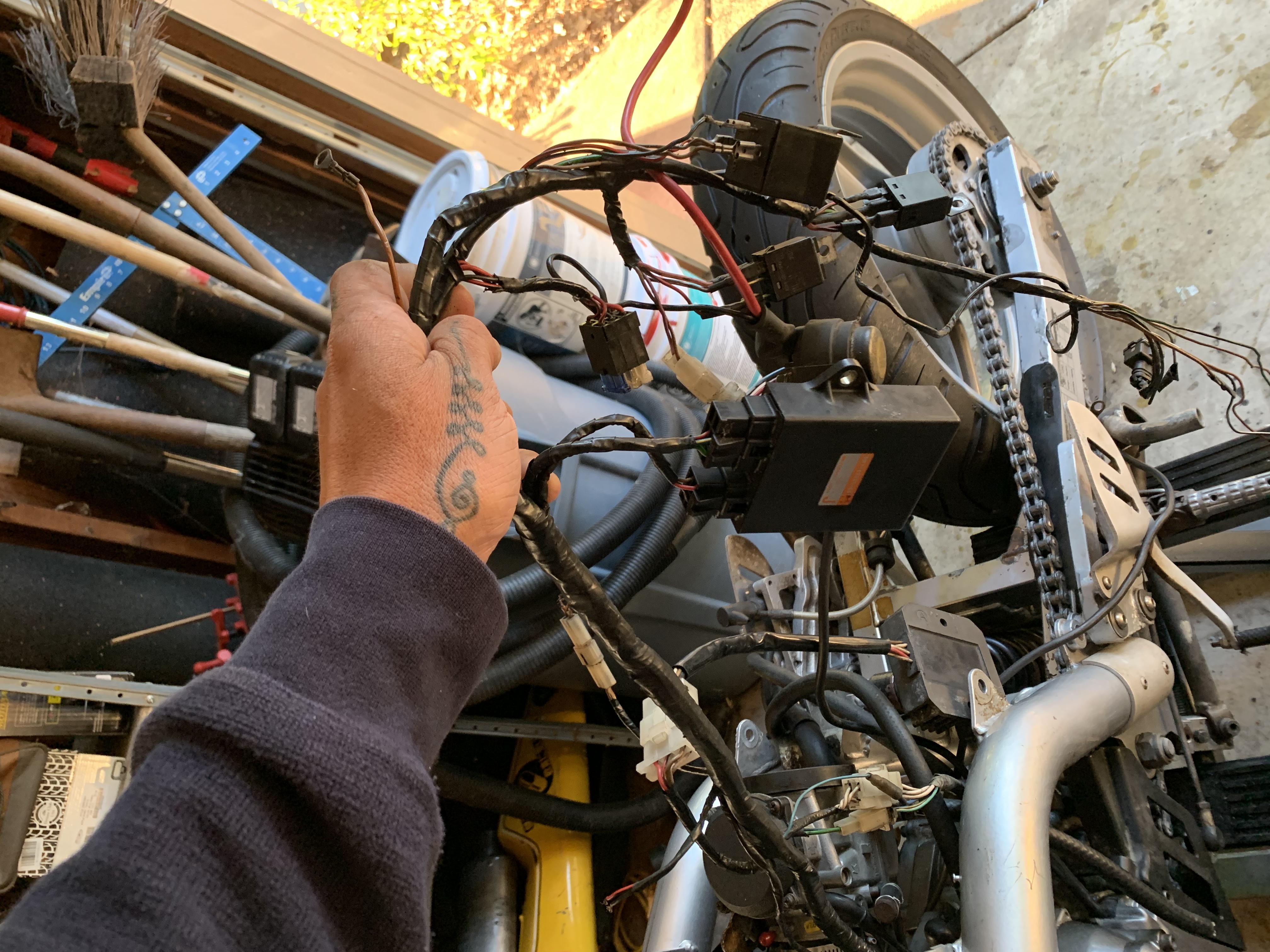

Postby Rizla215 » Sun Jun 26, 2022 10:10 pm
There’s more…
Rizla215
Posts: 5
