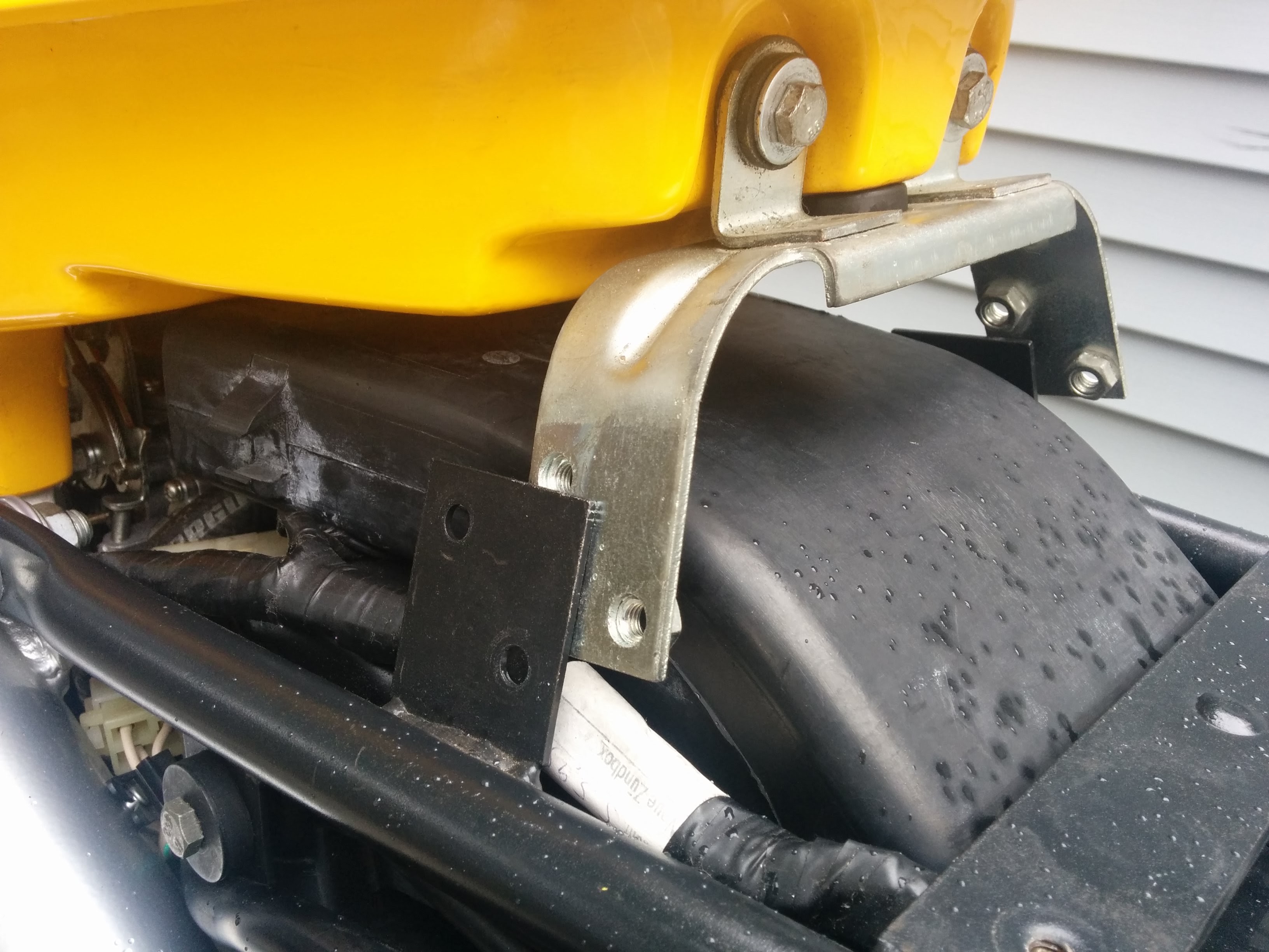

I have a quick question about reinstalling the gas tank - Is it necessary to remove the rear chrome bracket at the rear of the gas tank in order to install tank?
I fiddled with the two screws a bit, but they just turn and turn without loosening the bracket itself.
And if removal of the bracket is not necessary, then it seems to me that in order to have the chrome bracket to be seated inside the black metal tabs (see pic), some forcing is necessary and that would bend and weaken and someday even break the rear end of the gas tank where the chrome bracket is fitted to.
Any advise will be greatly appreciated... I am on the last stretch now :-)

Postby DAVID THOMPSON » Mon Sep 28, 2015 5:36 pm
removal of the tank bracket is NO the screws will not hold in the tank and its very hard to fix
and tanks are very high on the list of unobtainable items even when waving large amounts of cash

Postby WaiNYC » Mon Sep 28, 2015 5:52 pm
DAVID THOMPSON wrote:removal of the tank bracket is NO the screws will not hold in the tank and its very hard to fix
Thanks David. So, I just... force it in? Has anyone got any learned lesson for me to for installing the tank?

Postby basser23 » Mon Sep 28, 2015 7:47 pm
Be sure you push the tank FORWARD until it wont go any further into the front holder!!!! it is the possible to work 2 bolts into the rear most holes..you may need a drift to center the one side, then put bolt in loosely and do the otherside....eventually you;ll get them all in...no fun

Postby billr » Tue Sep 29, 2015 7:24 pm
WaiNYC wrote:I fiddled with the two screws a bit, but they just turn and turn without loosening the bracket itself.
Yep, they do that. I noticed on mine that the washers were spinning, also.
Try a pair of Channel Locks on the washers under the bolt heads.
Hold the washer with the pliers and turn the bolts with a socket.
I was able to get mine out that way, then lots of anti-seize...
Good Luck.

Postby WaiNYC » Thu Oct 01, 2015 2:28 pm
basser23 wrote:Be sure you push the tank FORWARD until it wont go any further into the front holder!!!! it is the possible to work 2 bolts into the rear most holes..you may need a drift to center the one side, then put bolt in loosely and do the otherside....eventually you;ll get them all in...no fun
Perhaps I did not try hard or long enough, but the holes on the bracket and the tab do not appear to be aligned. Of course, this cannot be! And so I only managed to put in one bolt on each side. I think I will leave it like that for now. I really just want to take the bike out for a ride, finally!!!. I will just have to check the bolts frequently in the meantime.

Postby samandkimberly » Thu Oct 01, 2015 9:27 pm
Oh yes it can be. Nylon tanks expand slightly on exposure to the alcohol in modern gas. This is a one time only expansion, about 5-7%, and it doesn't go back if you get rid of the alcohol. It is why most Skorpions have cracked or repaired paint, the faring side pieces don't fit together at the bottom of the tank in front of the seat, and the bracket doesn't fit w/o a lot of effort.

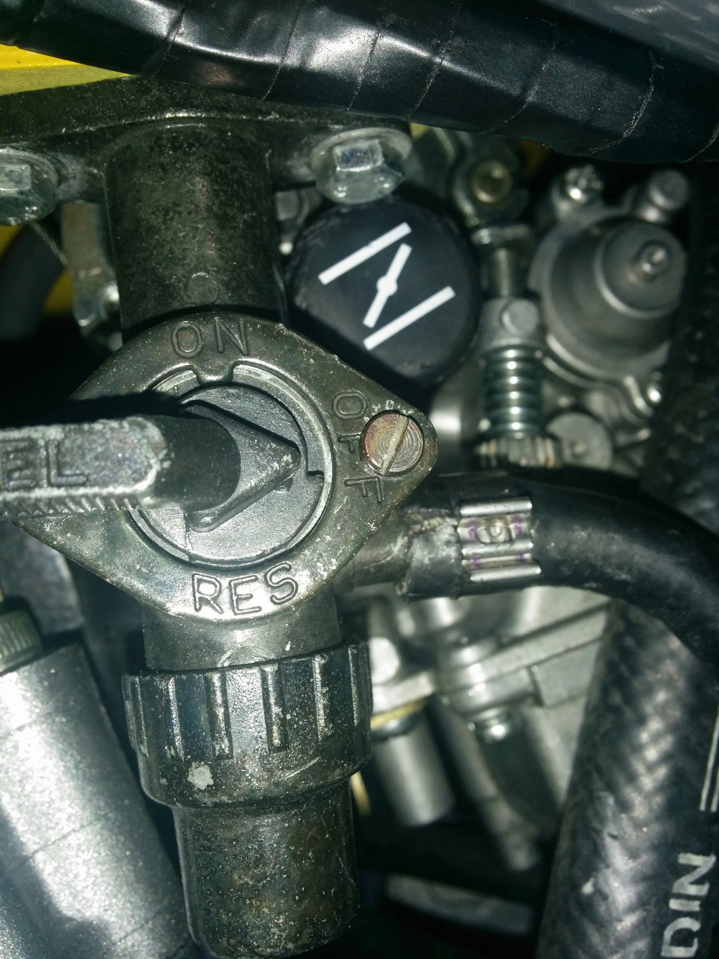

Did you install a Yamaha plunger? I did, after losing the choke assembly's spring. But the plunger is blocked by about 1 mm by one of petcock's screws. To engage the choke I have to pull the plunger downwards and outwards, a maneuver that I am quite uncomfortable with. I plan to shave away a small bit of the plunger handle to make pulling it out easier.
Do you have this problem too? How do you deal with it?

Postby edfmaniac » Tue Oct 20, 2015 10:02 pm
The stock petcock is garbage and will restrict fuel flow at wide open throttle settings if you get on it long enough to drain the bowl. It just can't flow enough fuel. The Acerbis universal will fit and should allow you to operate the plunger without modification.
