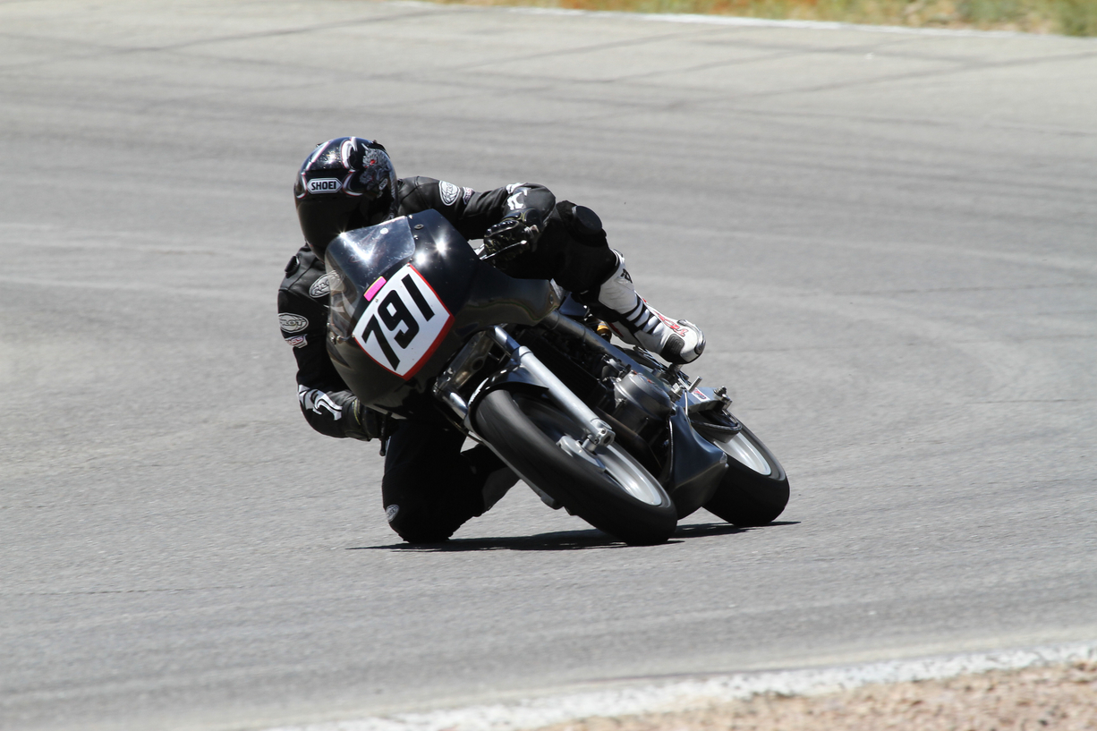

Postby morbidelli17 » Thu Jul 22, 2010 12:38 am
Not terrible for a first crack at this. I need to tinker with the shock and forks a bit, lower the seat (I adapted an SV650 seat and tail section), fiberglass in the huge hole in the belly pan and then re-mount it. New brake pads probably a good idea, too. And a new battery. The poor bike was so beaten up when I got it. My first trip down the block, I couldn't steer the thing. Pulled the steering damper off, and it felt like it would stick hard every inch or so. So I had to run without one this weekend. To save weight, he'd put aluminum bolts where aluminum shouldn't be, and they stripped when I tried to un-screw them. I spent hours just trying to clean it up and make it look presentable at tech inspection and for my sponsors.
Serious carb question - local tuners say twin 39s are too much, that they'd rather me get a Yamaha Rhino 2-1 manifold and use a single 41mm FCR flatslide. Anyone try the single 41 setup? How's it working?
Enjoy the pic.
Heading for second place, BOTT Light, WSMC, July 2010

Postby basser23 » Thu Jul 22, 2010 9:34 am
Nice Michael!!!
About the FCRs,unless you have a hotter cam,do head work,and run at least 700cc it may be overkill...otoh,if you do a Rhino manifold
you'd need to get one of those carb spacers for the Raptor to get the intake track longer to increase velocity...but a 41 would be sufficient
for sure.
Bikeworx had a single manifold using a Mikuni HSR42...no manifolds are available from what I've heard.
Bill Jurgenson has used a Grizzly manifold with a port matching adaptor he made and ran it with a tm40 Mikuni I think...
MORE pictures please!!! I'd like to see the SV seat adaptation :)
