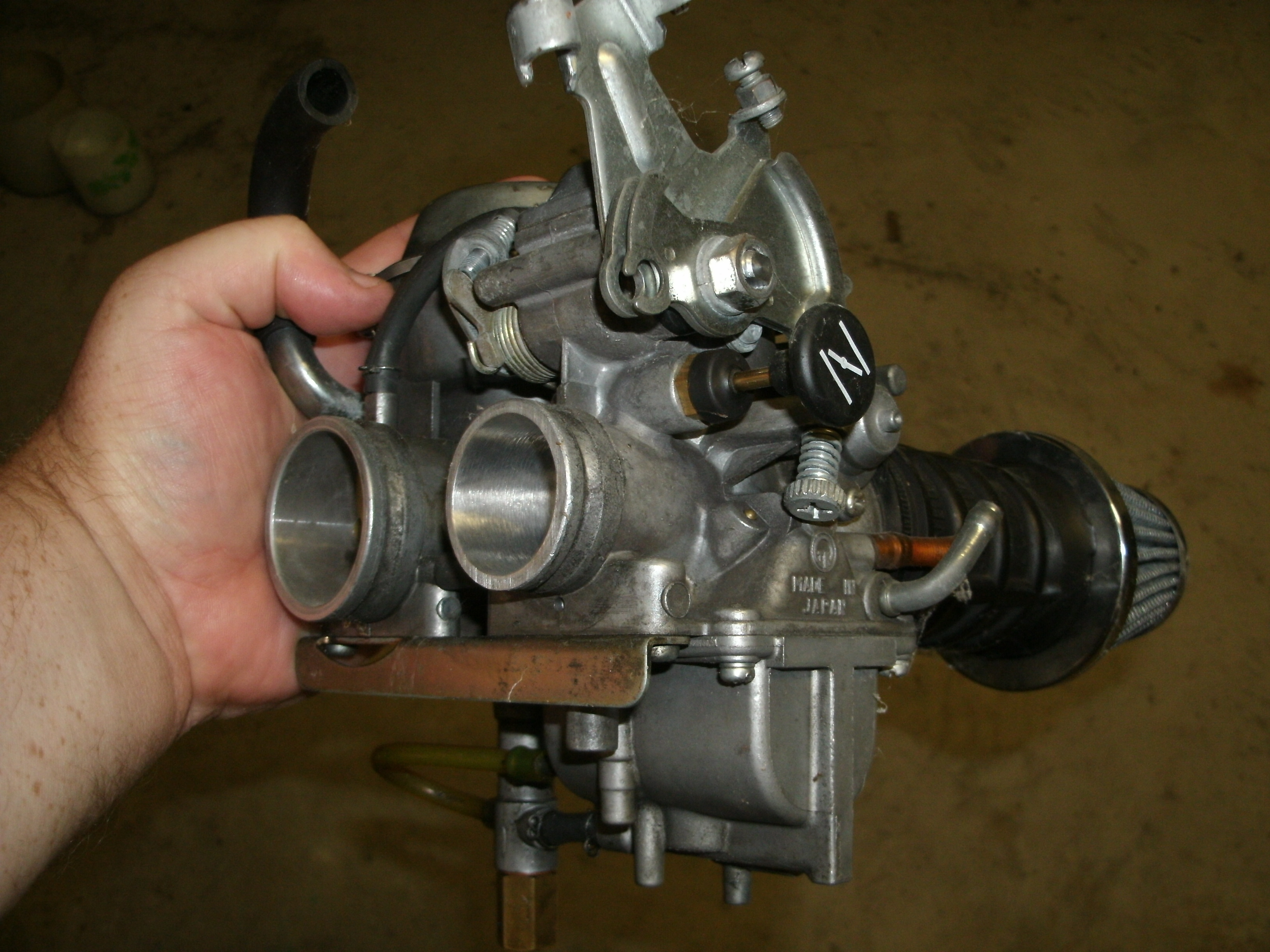

some background, the bike was running fine when I put it away in October last year, due to medical issues I wasn't able to ride the bike until August.
Before putting it away I filled the tank and added Stabil.
Now the bike starts right up and idles normally but it won't accelerate past 3500 rpm under load, until that point it runs fine: no hesitation, sputtering etc.
When I back off the throttle it runs fine.
The bike will rev to 5000+ rpm sanding still in neutral.
When I use the enricher(choke) it has a fast idle and when I take the choke off it idles normally.
Thing I have checked and done:
drained the gas and added fresh gas
checked that gas is flowing from the tank to the carb (I do run a fuel filter)
removed the drain screw on the main carb to see that fuel drains freely, it does.
on the secondary carb I checked that the diaphragm assembly is free and that the diaphragm is intact.
also removed the main jet on the secondary carb and it is clean and gas is flowing to the secondary carb.
checked the valve clearances
new spark plug
ran it with out an air filter, still won't go past 3500 rpm
I am stumped what do I check next.
thanks for any help
Bill

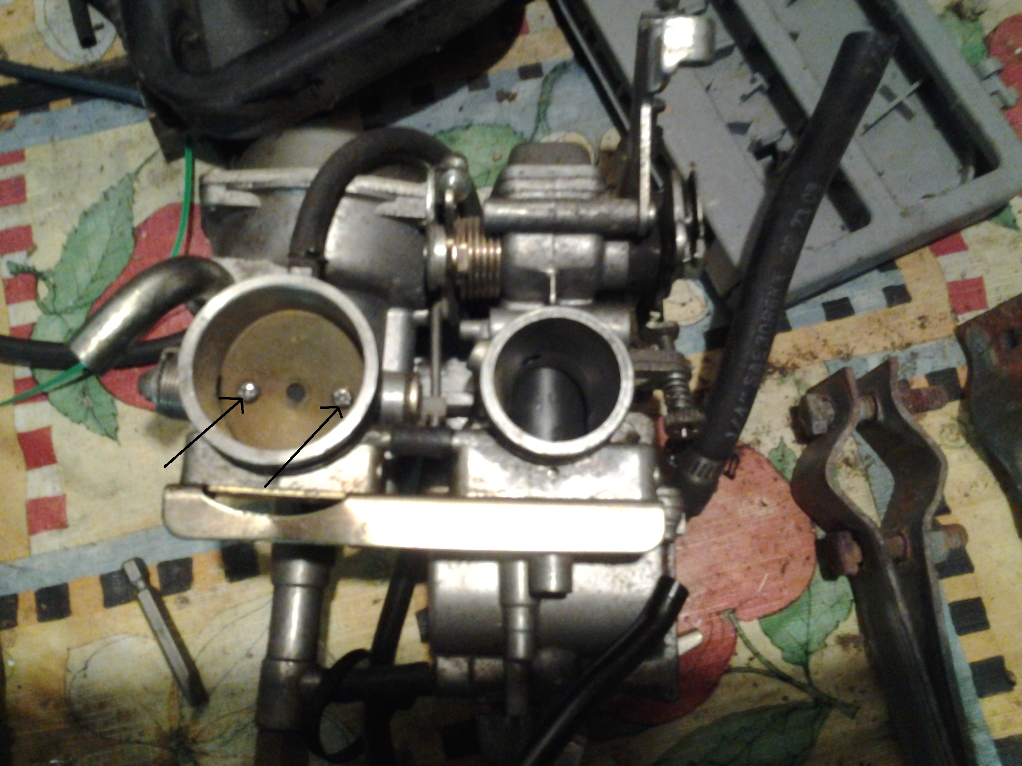

2 screws on left side in the brass butterfly may have came loose
or the second carb may not be opening the brass piece at correct time
the brass piece controls the vacuum if it not working or out of time things will not work
i hate this type carb it always seems to have some kind of problem

I have checked the screws holding the butterfly and they were tight.
I checked that the carb rubber manifolds had no cracks and that they were tight.
I checked the operation of the primary carb slide and secondary butterfly when the primary slide is at the top, the secondary butterfly is wide open.
The carb throats are surprisingly clean .
The secondary butterfly operates smoothly.
