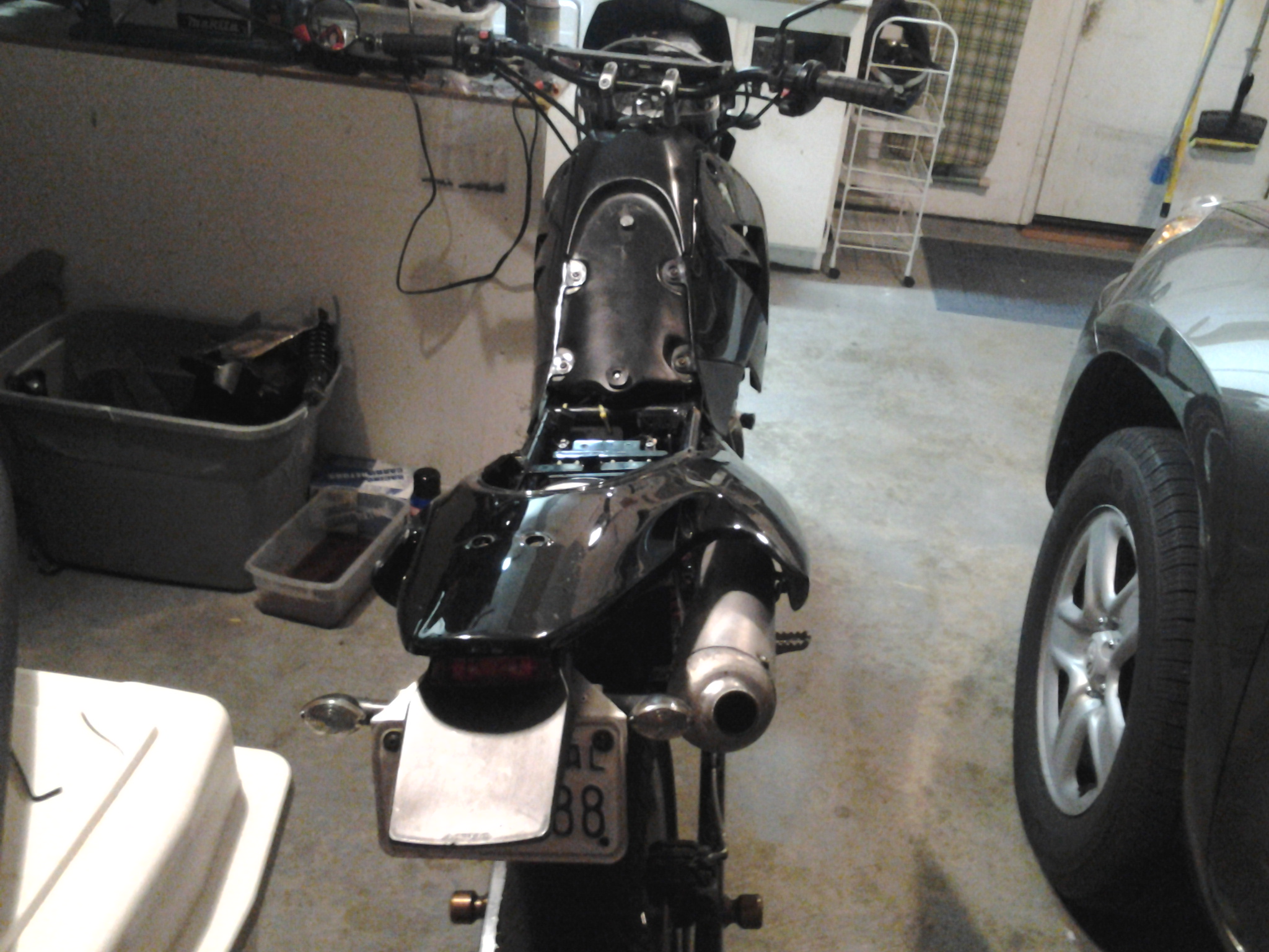

i just picked up my first mz, its a 125 sm and it is currently very far from its original factory condition
several things have been changed/removed

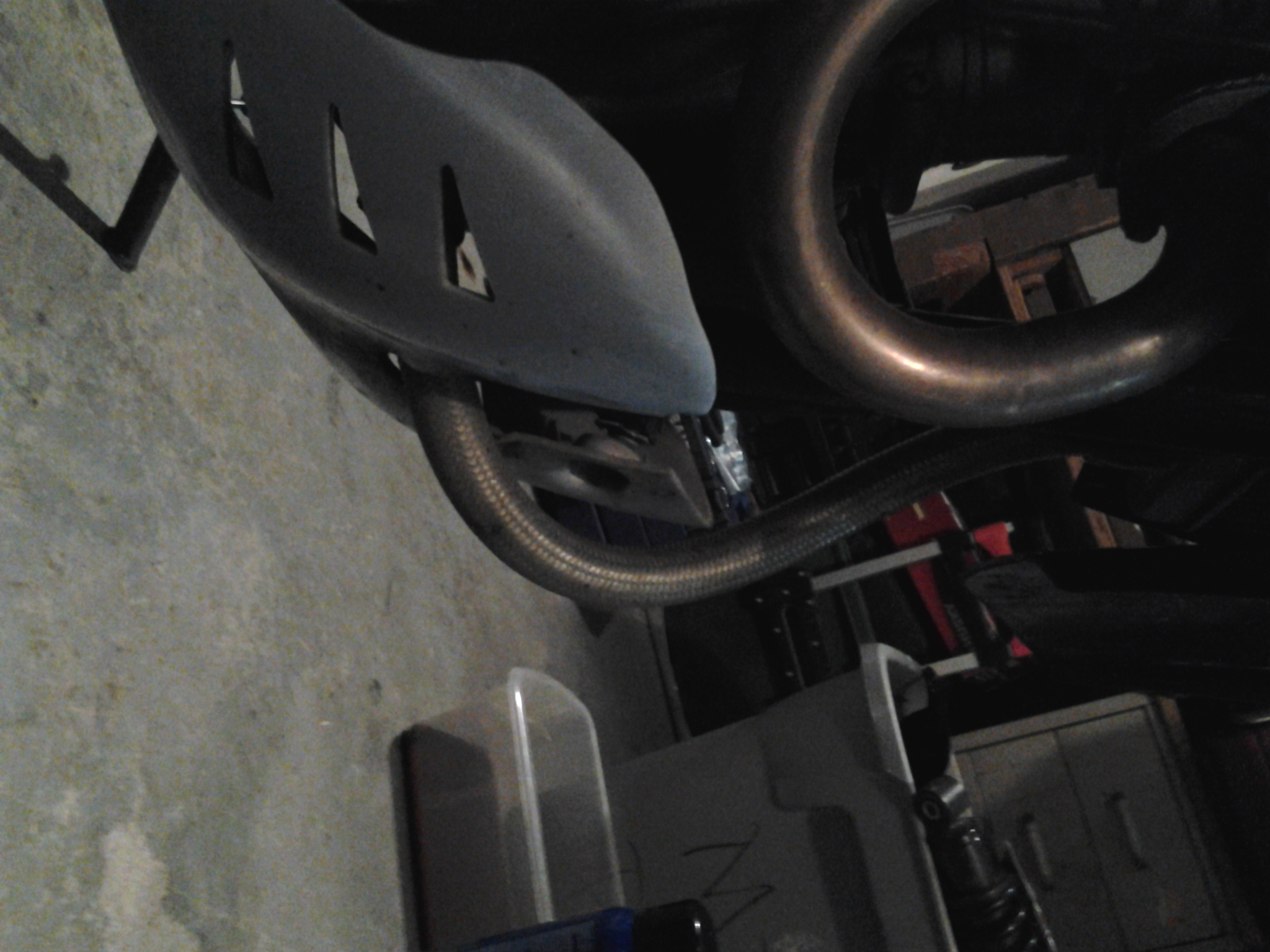

radiator hose has been changed to a braided line
airbox was removed
battery has moved
electrical and components have been moved around
carb was changed to a flat side carb(changed back to the original vm24 because i couldn't go past half throttle without the engine dieing)
as of right now it has several problems,
ocassional gear slip( it will slip back into the previous gear)
battery doesn't seem to get a charge, i can start and ride for a while(about 50 miles) then it won't start or will slowly die and stop firing the spark plug and the bike will misfire and die.
I'm new to the mz line of bikes and would greatly appreciate if anyone could help me fix this bike to get it in a usable condition.

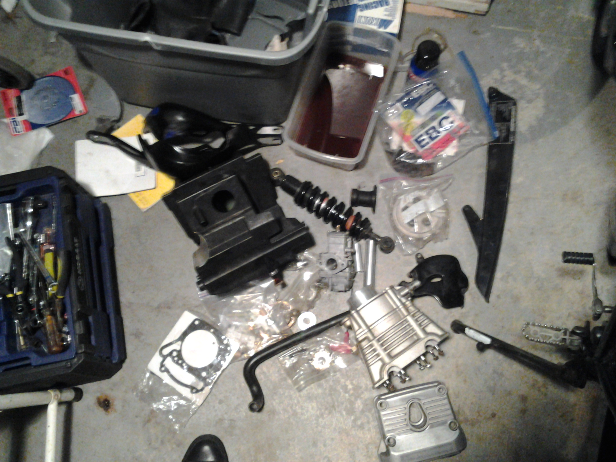

Postby biohazzardz » Wed Dec 25, 2013 1:10 am
box of parts that came with the bike

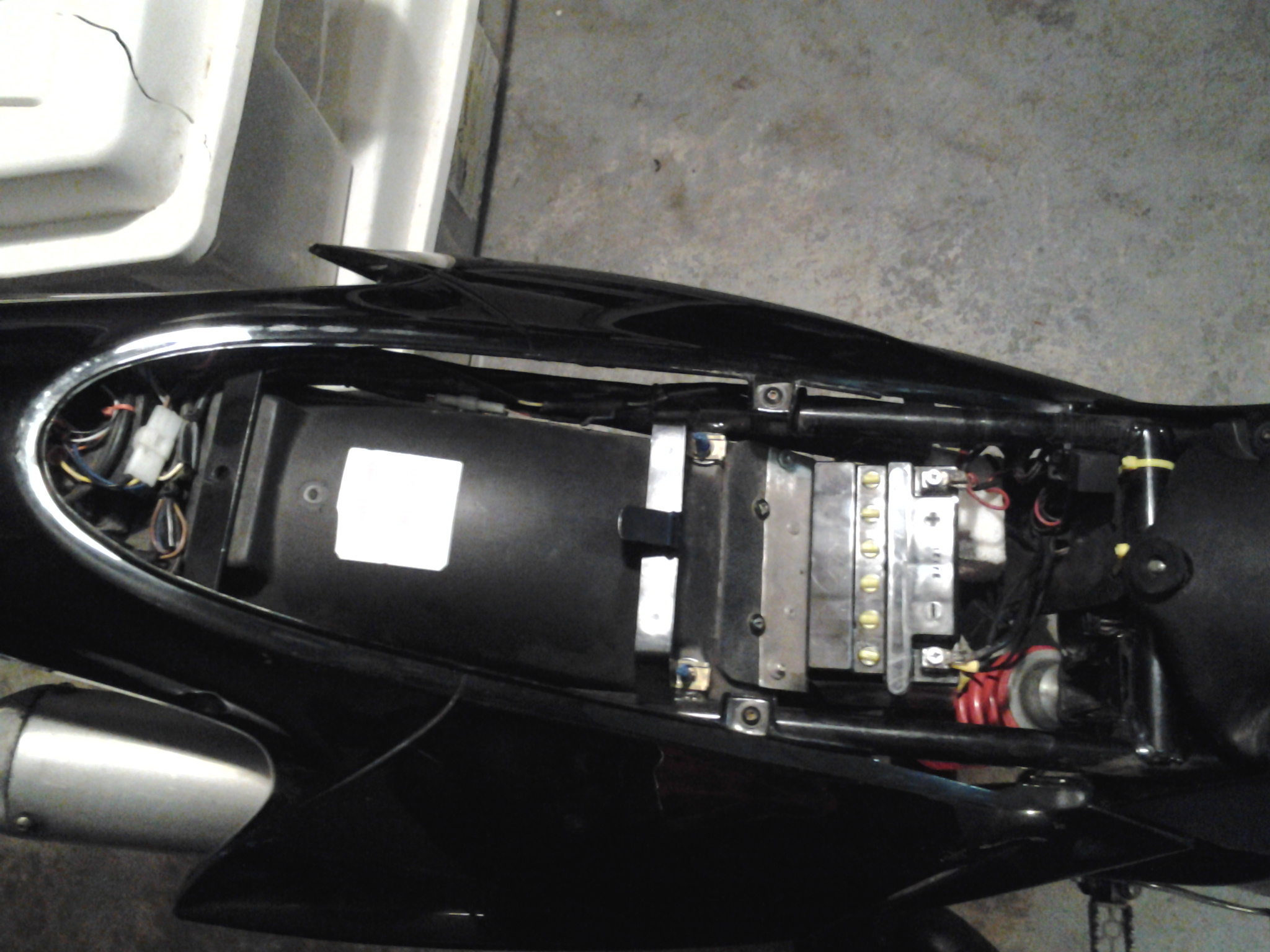

Postby biohazzardz » Wed Dec 25, 2013 3:17 pm
do youthink having a k&n air filter on the stock carb would affect it much, since the previous owner welded steel plate where the air box should go to hold the battery

Postby biohazzardz » Wed Dec 25, 2013 7:51 pm
changed the main jet on the vm24 to cope with the filter change and seems to be running fine, the relay 19 seems to be covered in a turquoise corrosion on 2 of its connections. I'm going to look for a replacement tomorrow when stores are open.
so a bad voltage reg could be the cause of the battery somewhat not charging?

its not that it doesn't start, its that the battery literally slowly dies as i ride(hooked a small voltage reg as i was riding) its to the point where i can get it running with a bump start and it will idle with 7volts but if i try to pass 2000 rpm it doensnt have the power to the ignition coil and the bike flat out dies.
