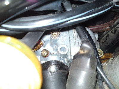

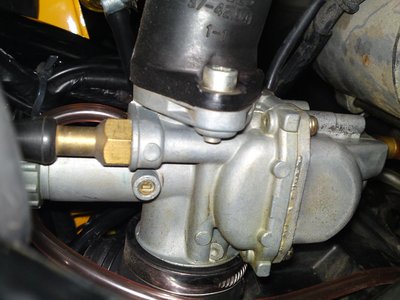

well i found a motorcycle garage that is willing to clean out the carb, but insists that i have a spare "float valve" in case the one they end up finding during cleaning is etched. also suggested i try getting a float bowl gasket.
i cant find these exact terms in the parts list. can anyone speculate on what he might have meant?
also, i wondered if i should just buy a replacement carburetor so i searched for MIKUNI VM24 as stated in the manual, but everything i find looks very much different from what i have on the bike.
this is what i find easily:
this is what i have:
from mz-faber, i gather that the part number is actually Mikuni VM24/499
i found Mikuni VM24/489 but that STILL looks different.
Dave, what experience do you have with the carb from RT ? do you know if its interchangeable with anything else i can get states side?
is the part the mechanic talking about really prone to etching and needing replacement?

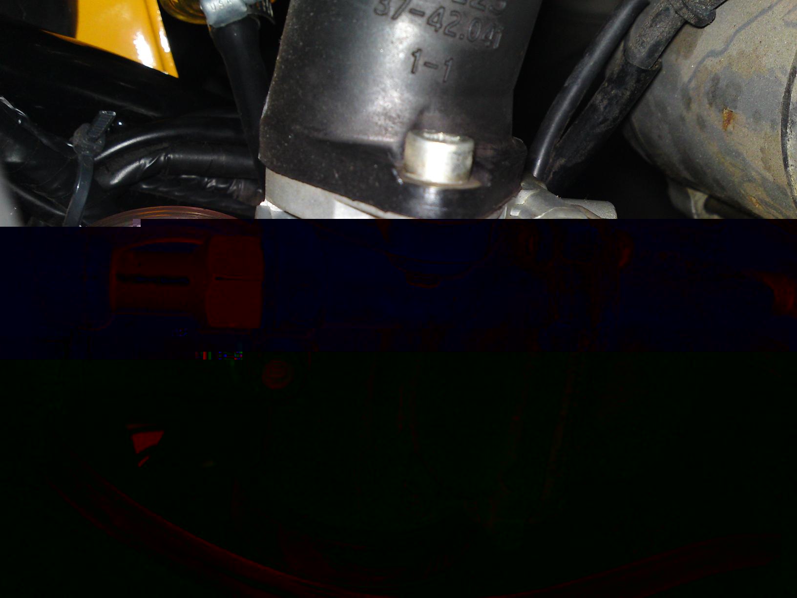

anyway, got the carb out!
at first glance everything inside looks spotless clean. no 'gunk' or 'jello' in sight.
both the starter and main pin seem squeaky clean, so i'm not any where closer to understanding the choke funkiness.
i did not get into the bowl gasket yet - maybe tomorrow, but the first thing i noticed is that the idle mixture screw was 'out' more than i expected.
the manual advises it to be turned all the way in, and then unscrewed 1.5 - 2 turns.
here, it was out more like 4-4.5 turns.
any idea why someone would have it set that way?
and moe importantly, could this alone be responsible for the choke and throttle?
