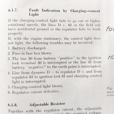

I am as puzzled as you. The above excerpt from an MZ manual might help.
The most likely cause, and the first thing to check anyway, is a loose or bad connection somewhere.
It might also be a good idea to recharge the battery if you have a charger. Sorry I can't be of more help.

Many thanks Dave, that's a useful paragraph in the manual.
The fact the light is not steady, but flickering, also fits with a loose connection somewhere.
Yes - I will charge the battery and in the meantime, trace all the wires I can see to check for a connection issue.
