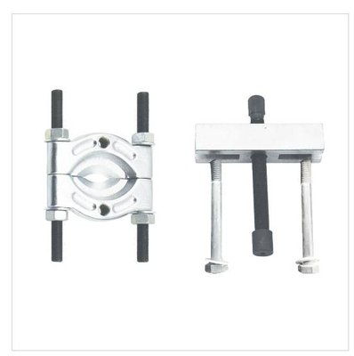

by therealche
Have a nice break, then come back and hit it with a large hammer!
Or more seriously, I would look at using something like a bearing separator. Tighten it up under the lip, then carefully pull the collar off. They also come in useful for removing the main bearings if you ever need too. Not sure what the price of tools is like in Sweden, but in the UK you can pick them up for less than £20... and a man can never have too many tools!

PostPosted: Sun Jul 12, 2015 3:56 am
by edharley
And the fu**er is off. :-D
