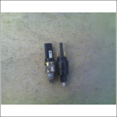

Just thought I would post up a pic of the brake light switch from the front brake lever on my 01 panther compared to the bmw switch listed here. Picked up the bmw switch for about $12 and it works beautifully.
brake switch.jpg (31.19 KiB) Viewed 11614 times

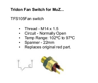

Thermo Fan Switch, the one on the left outer side...
Direct Replacement
