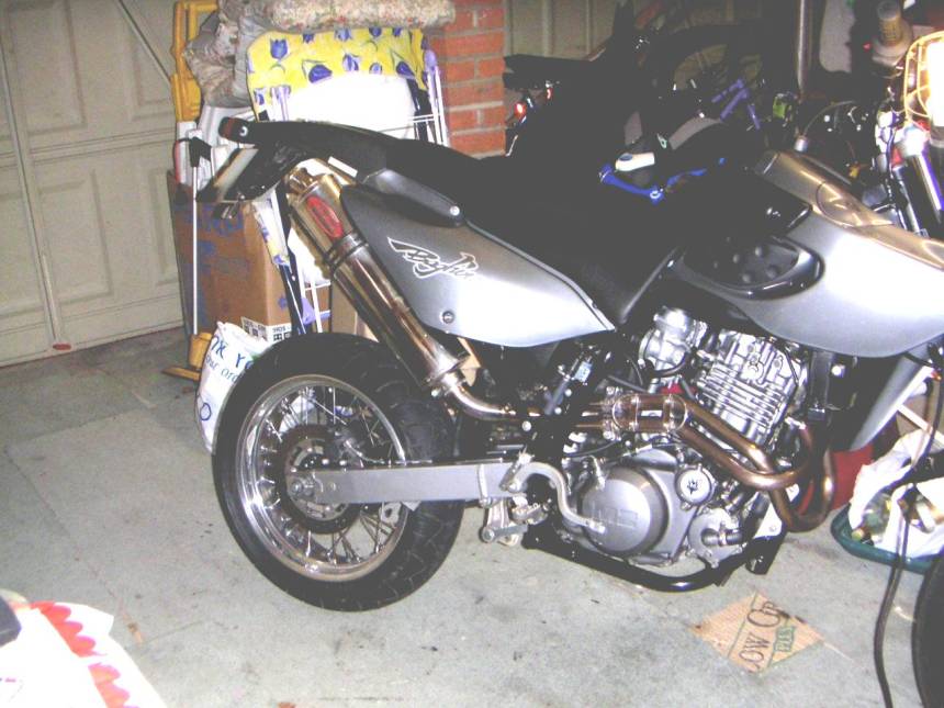

Go on then show us a pic with the twin outlets... Did you go for an anodised finish or just stainless :?:

Both you guys please post pictures!! (Gedge - just the newest ones!)

Postby gedge » Mon Nov 15, 2004 5:17 pm
Its the registration plate that got melted , the side casing on mine is fine even though the can sits very close.
Pic for you sorry its not very clear :(

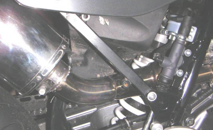

Postby gedge » Mon Nov 15, 2004 5:19 pm
Close up of the link pipe. I will try to measure the diameter tomorrow and let you know. Is it just the connector diameter or the body of the can that you want .. dont worry I wil measure both :D

Gedge-who made your link pipe for you? There are a few places close (ish) to me, but they want hugh amounts to do one (nearly as much as I paid for the complete can!).
I need to play about with lenghts and angles to get the pipe exactly where I want it-it sits about an inch too low for my ideal position. And when I fit the new rear guard and light, everything will be clear of the outlet, so no more melting.

Postby gedge » Tue Nov 16, 2004 12:35 pm
Whysub wrote:Gedge-who made your link pipe for you? There are a few places close (ish) to me, but they want hugh amounts to do one (nearly as much as I paid for the complete can!).
Will also be able to fit a more "appropriately" sized number plate.
The most pleasing aspect is that it now looks, sounds and feels like a motard should. It's getting there, with minimal fuss, minimal expense, and no reliability worries.
I got it done by a friend called Geoff Muston he does stuff in his spare time. paid him £50 and for that he stripped it off , cut and welded the Carbon can link pipe and er-assembled it. He lives in Petersfield and I am fairly sure he would do another for the price. :D
