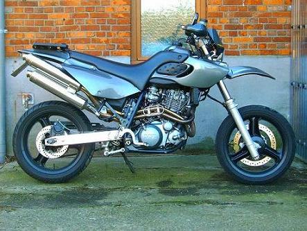

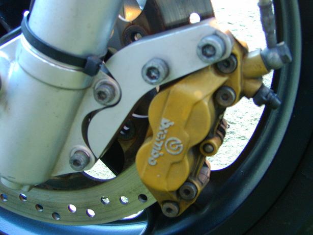

Postby Pieter » Sun Jan 16, 2005 5:48 am
DEmark wrote:There was a time when the Mastiff was available with mag wheels that looked like Skorpion wheels. My parts manual shows the part numbers for the mag wheels for the Mastiff. I emailed the owner of the bike in this picture a while back and he said the caliper was a Brembo. Does anyone got one of these bikes? I sure would like to see some close up photos of the front wheel.
Hello DEmark
I have a mastiff with the mag wheels.
Here are a few photos of the bike and the front wheel with the Brembo.
mastiff 00.JPG (42.37 KiB) Viewed 7777 times
mastiff 01.JPG (42.34 KiB) Viewed 7777 times
mastiff 02.JPG (36.7 KiB) Viewed 7777 times
