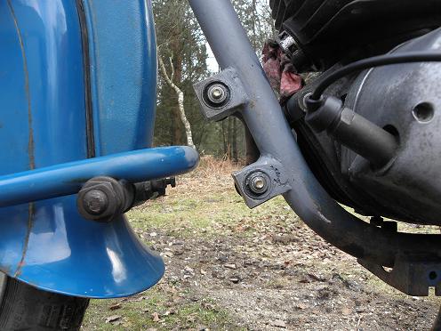

Hi Marc and thanks for the welcome. Here are my external engine mounts, not everyone's cup of tea but they answer the problem of being able to mount any MZ engine into the chassis. I did play around with the original top engine mount, but it looked to cluttered and was a very tight fit (see an excellent write up of a Trophy project at www.starfield181.co.uk). Will write some more later as I have to go and pick up some more MZ bits, I am sure you will all understand! LOL

Right back from picking up a few bits, now now where was I? Ah yes, had a local machine shop make me the mounts, 40x40x40mm with a 30mm ID bore for the Land rover deadpan bushes that I have used as Anti-Vibration mounts (why Land rover? You can get the bits anywhere, they are tough and cost 3.64 for two, with postage! Oh bike manufactures please take note...). I also asked the machine shop to machine a vertical radius of 40mm 2.5mm from the ID bore, they machined one of the blocks with a horizontal radius before realising the mistake (after looking at the drawing which accompanied a bush to aid them) and then machined a vertical radius...hmmm...(I even had to wait while they honed the bore to fit the bush I supplied them)...I had to fill the bottom one with weld, and whilst solid now, I will have to spend a little time before paint goes on building up a little more weld and cleaning to enhance the finish. The reason for all this work is that the original 4 speed engine has two metalastic bushes held in shear underneath. The engines after this only retained the offside internal thread to hold the exhaust clamp. It is possible to tap a new nearside thread but means a lot of extra work if I ever want to put an exchange engine in. The engine plates are a eBay find for a couple of pounds, and what luck! They are exactly the correct space apart and have a slight bend which allows them to stand proud of the frame, I could not have made them better! I think they look quite funky myself, maybe a steampunk style coming on? They are I am told Aprilia 650 engine plates by the eBayer, can anyone confirm?

Postby awac » Fri Feb 17, 2012 3:00 pm
Land rover deadpan bushes used as Anti-Vibration mounts

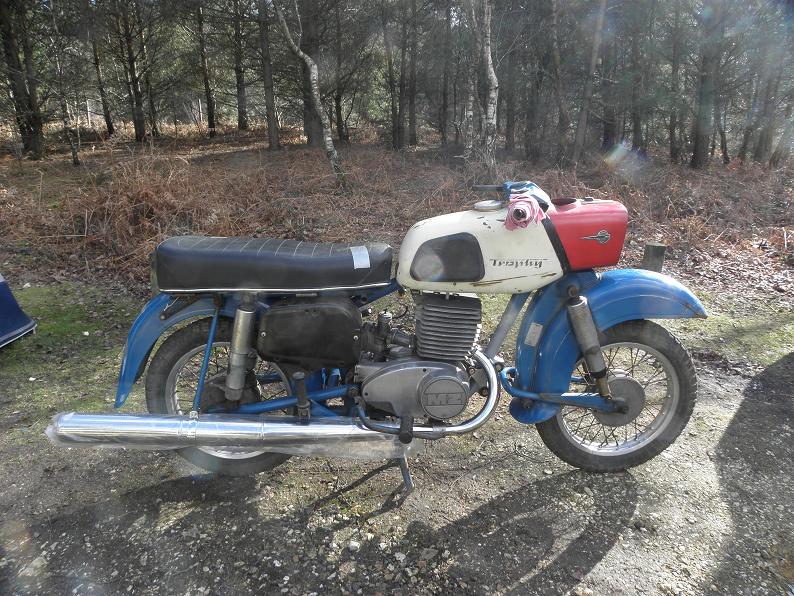

Postby awac » Sun Feb 19, 2012 10:51 am
Side view of es with TS exhaust placed on to check fit. Not bad just the exhaust bracket under engine needs fettling to make fit, as one bolt in as yet, will try in a couple of days as crawling on the floor today is a bit cold!

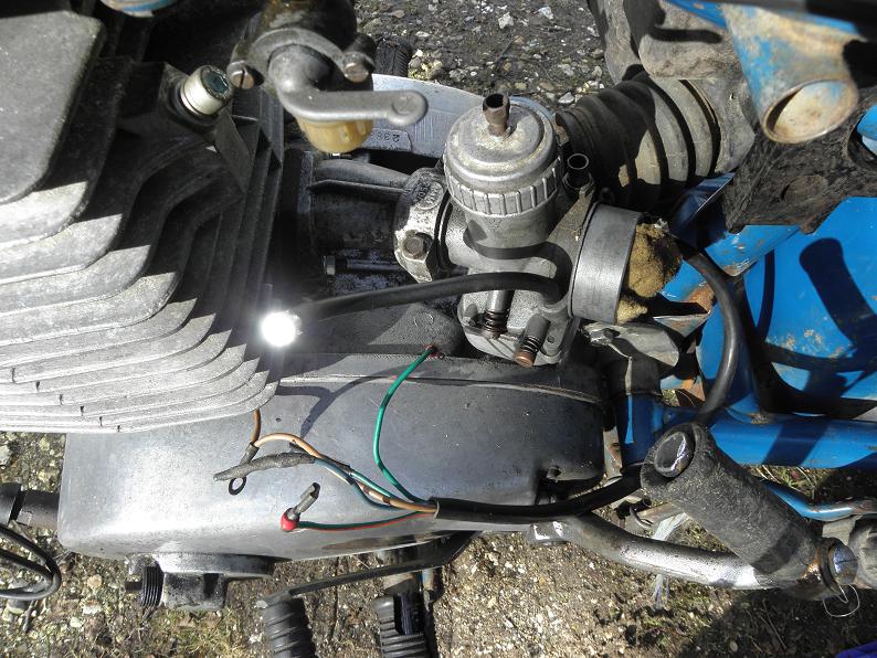

Postby awac » Sun Feb 19, 2012 10:59 am

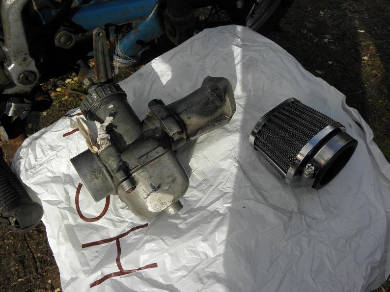

As you can see, the TS carb goes one way and the es carb goes to other...this leaves you with a choice to either put on the es carb and manifold, but it needs to be filed or a K&N style filter fitted on, or.....a different carb altogether, which is slightly slimmer....if I use a K&N type I am thinking the air box will make a great battery box etc

And here is the es carb. You will see that it has been filed by its previous owner, I just bought it off a chap who had started to put a supa 5 into the es but did not complete, I was lucky to find the manifold, not seen any more for sale as of yet. So not had real time to offer it up yet but you can see the manifold is much straighter than the TS manifold.

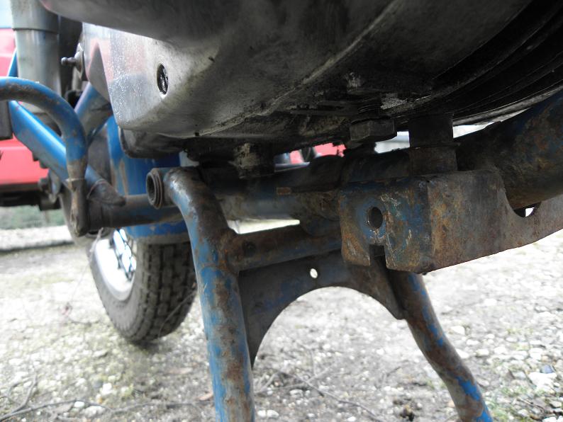

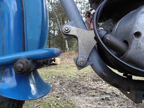

Postby awac » Sun Feb 19, 2012 11:21 am
View of original es engine mounts on which two metalastic rubber bushes held the engine in place, you can also see the surviving mount point now used as an exhaust mount point.
Es original engine mounts and TS exhaust mount point

Postby radiograf » Sun Feb 19, 2012 1:14 pm
What I'm about to say may sound stupid, but did you try fitting the TS manifold upside down, so it points to the right?
radiograf
Posts: 272
Location: Stechford
Re: New Forest MZ
Postby awac » Sun Feb 19, 2012 1:26 pm
I did consider it! In fact it might still be an option, however, the manifold is shaped and narrows internally towards the bottom, now I think this will have a negative effect on the intake port. The other possibility is to have it filled with weld and filed out to shape? Perhaps I could make a living from selling modified TS intake manifolds.....LOL. Hmmm. Will have a play in a couple of days as I have to go and do some work...Boo...

Postby radiograf » Sun Feb 19, 2012 1:41 pm
How about making a new manifold from a flat plate, a piece of pipe angled to suit, and attach the carb by a rubber collar and two jubilee clips, as BMW ( you know that other German motorcycle maker!) did on the old air head models?
radiograf
Posts: 272
Location: Stechford
Re: New Forest MZ
Postby awac » Sun Feb 19, 2012 2:12 pm
You know, that sounds the best idea to date, simple and cheap, and effective. Just like BMW's, well simple and effective maybe...Thanks for the thought RG
