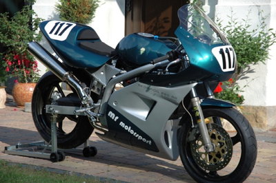

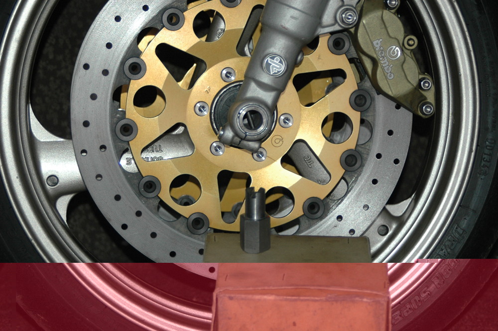

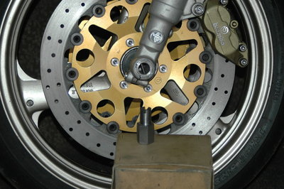

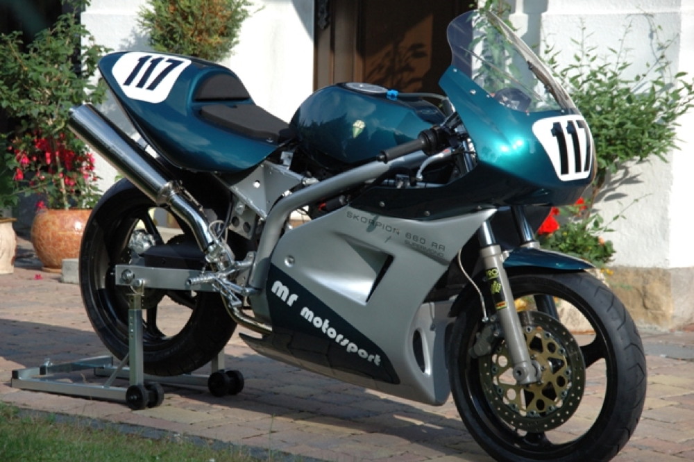

Having owned a few Skorpions, all more or less tuned and raced them too, I cannot attest to any such thing within the reality frame of this bike.
For one season we even went to twin rotors (using only one for wet conditions) and dropped it 'cause it was not worth it. |On the contrary, the additional "stopping power", even for our nearly 80hp, was potentially dangerous in the dry and not usable at all in the wet, the additional unsprung weight had bad influence on the both on acceleration and cornering.
And we were using Brembo Racing rotors with aluminum webs.
and a hollow axle.
True, the USD fork is a bit stiffer, but all the others had the RSU Paioli with Wilbers resp WP progressive springs.
This was my blue Tour, named the Toy, which I reassembled for a friend as track day bike, using a few goodies from the racer like the Marvic mag wheels and the ABM Billet caliper and radial pump.
This is the balancer-less motor with rearwheel 60hp, over 80tkm and still with original crank and conrod, valves and guides - and SZR cluster.
If one has to go to twin rotors, then to smaller rotors (280mm) such as the Replika had.
But from strictly functional vantage point, there is absolutely no reason for twin rotors.
Plently of reason, tho, for replacing the Grimeca shit with Brembo (plug and play anyway), both pump and caliper.
