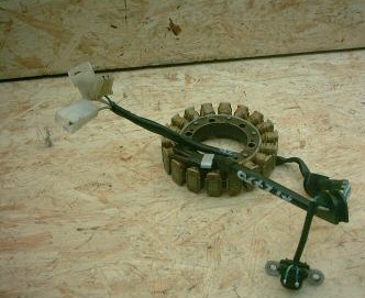

The XTZ generator has no source coil at all:
Screen shot 2012-04-08 at 11.21.08 AM.jpg (35.55 KiB) Viewed 7451 times

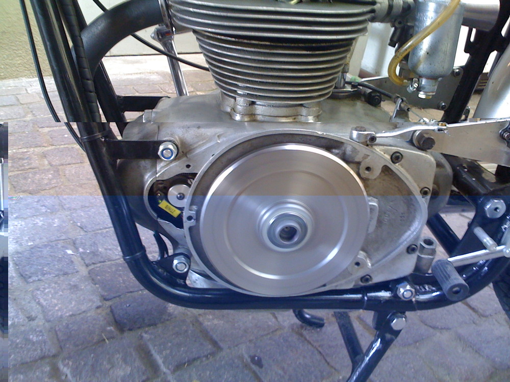

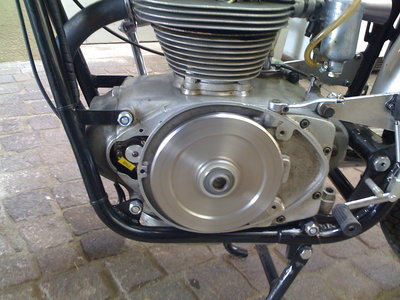

my racer

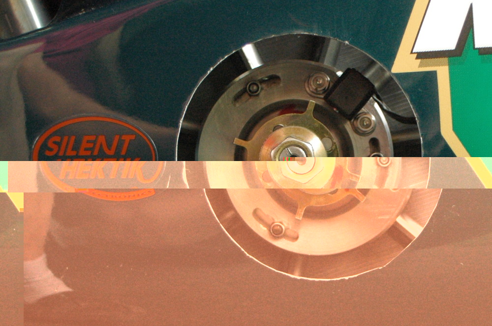

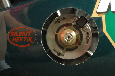

5 noses at 12, 1, 3, 6, 9 the 1 o'clock nose signaling once around and TDC (top dead center), the 9 o'clock nose is the actual trigger. SH's tripleSpark needs 5 noses, the XTZ has only four of which the long 11-12 o'clock signals once around. One could mill down the top long one to the same size as the other three and then add the fifth to make a SH TripleSpark work. I think the Ignitech is the better way to go here.

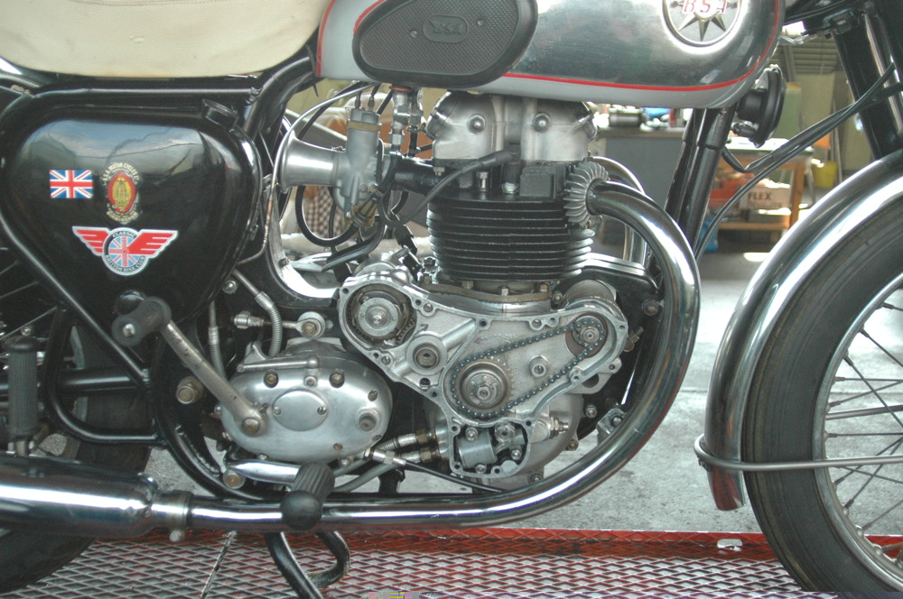

The 1954 BSA has a magneto and has no turn-on switch at all, the battery is only for the brake light. You shut down with a kill button which shorts out the breakers of the magneto.
so actually no exception as far as function is concerned.
left behind the cylinder, driven off the cam, the chain drives the generator in front and at the bottom the oil pump. The gear box is separate.

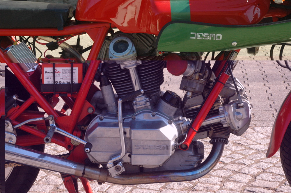

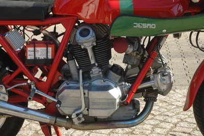

the 1978 Ducati 900SS has both kickstarter and battery ignition.
It has an early electronic ignition with two pickups, one for each cylinder.
Both no battery, no running.

The silent hektik system is pretty similar to what is in a GS500. An advancer with a nose and the trigger coils mounted on the engine case. The 2004+ is nearly the same, the 89-00 is a single prong.
