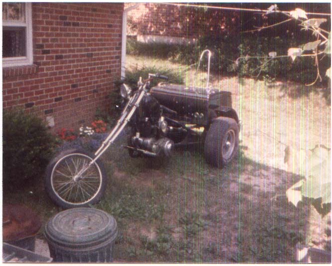

Postby DEmark » Wed Feb 23, 2005 9:03 pm
I bet neither of your trikes handled as bad as mine. Check out the forks made out of two leaf springs off a car. Truly a "Widowmaker".
DEmark
