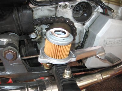

Postby metric » Sun Mar 10, 2013 9:33 am
There is a magnet on the sump drain plug, shown on this picture reposing on the footrest.
I have added a magnet, shown in the picture adhered to the inner (left) side of the filter. Seems to fit fine in this position.
The magnet is Motion Pro part number 11-0063. The filter I'm using is Bikemaster 17-1631.
