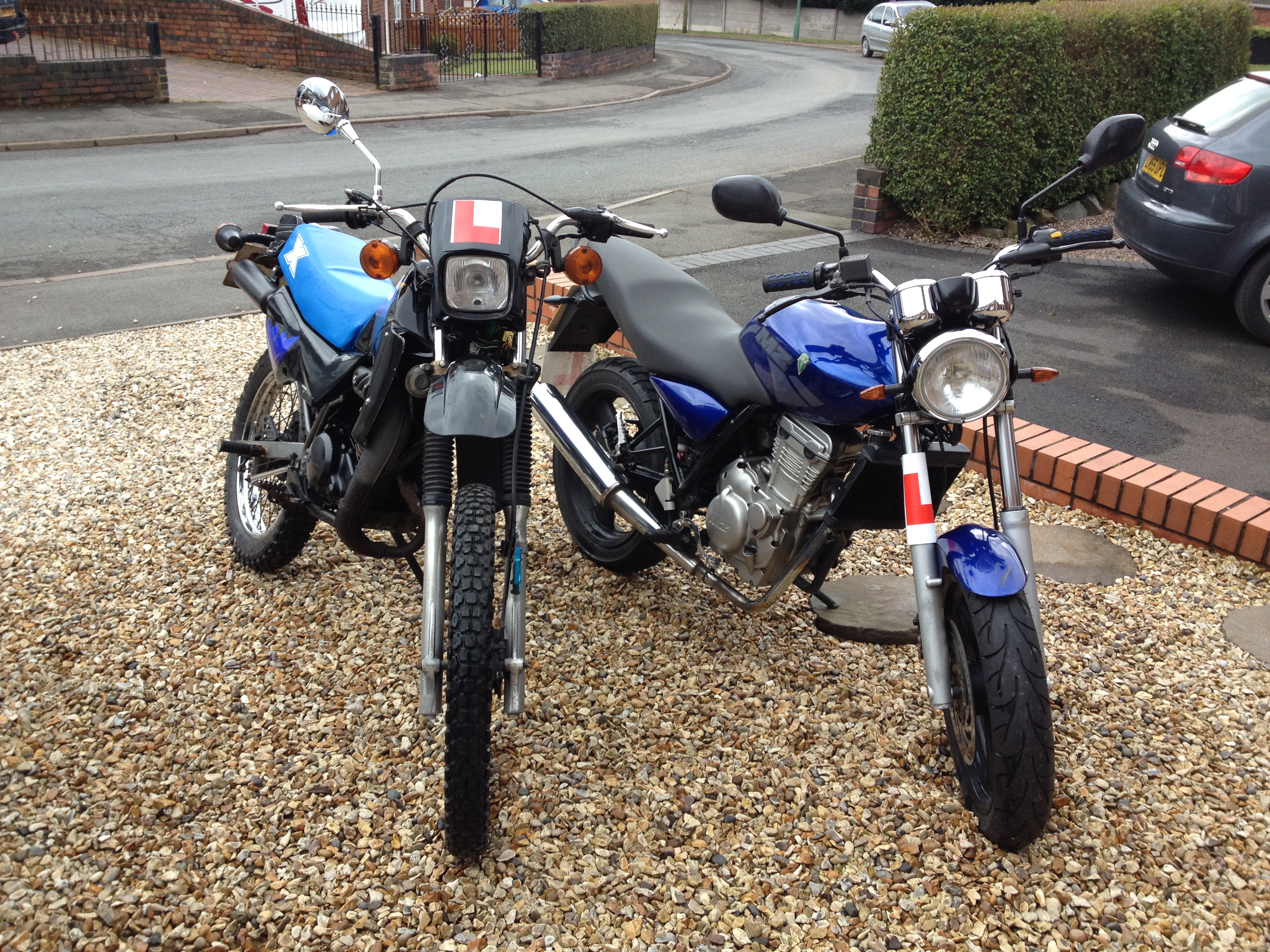

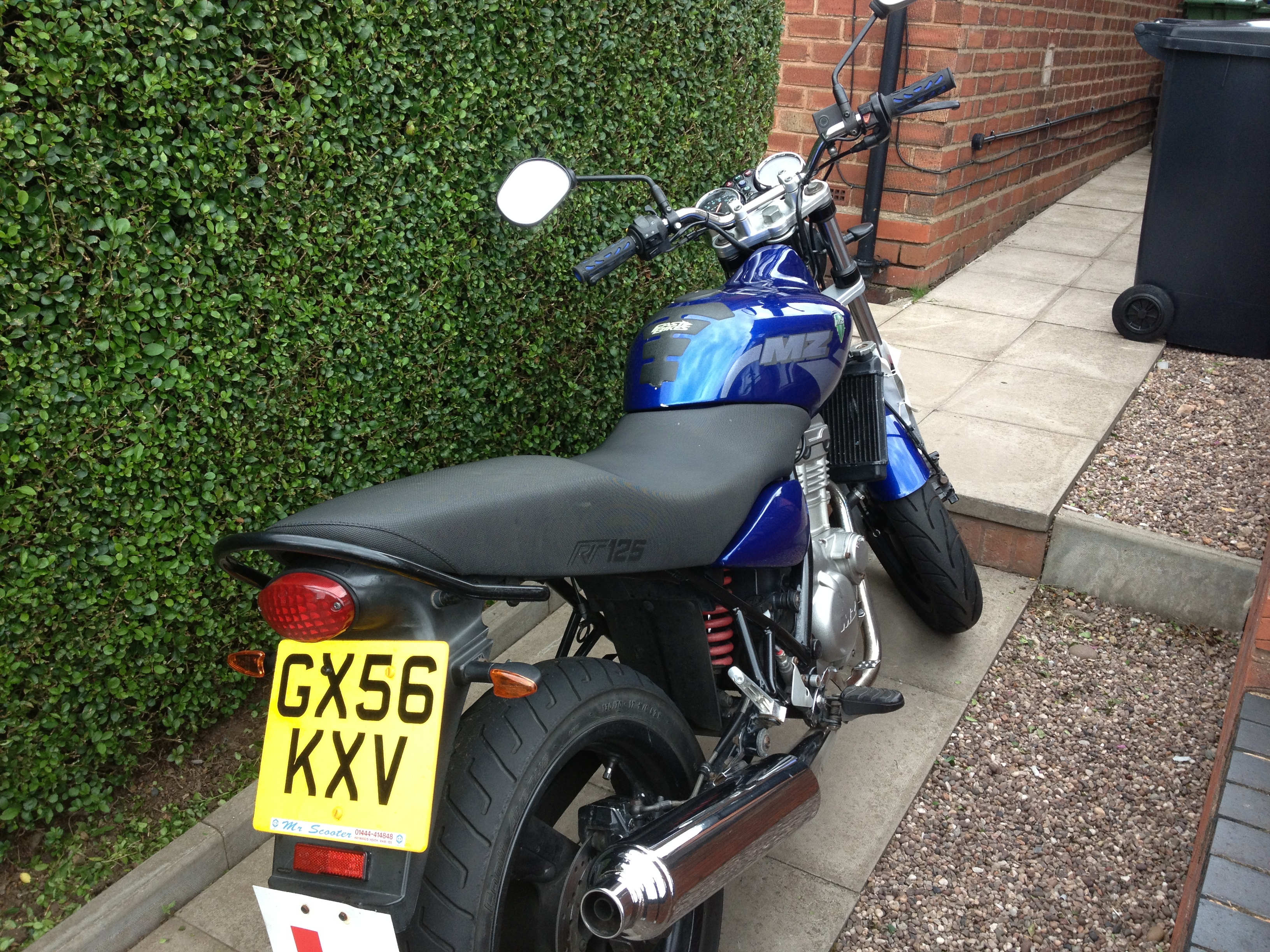

Thank you for that Steph, I'll get to work on it soon and David the switches are still there. Just no relay, previous owner may have removed it for some reason. And sure, wish me luck in uploading it but here's a youtube link of it to.
Just in case anyone asks that's my baby Suzuki to.

Postby DAVID THOMPSON » Fri Dec 27, 2013 6:24 pm
bike looks right but those are not oem T/S like on mine
the wires should be there just finding them may be a problem
they are a 2 wire system hot and brown ground wire
