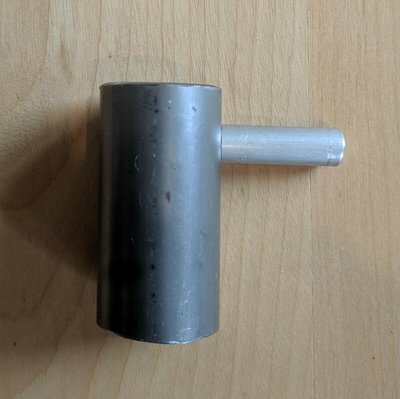

Postby MotoMZ » Fri Mar 08, 2019 3:50 am

Re: TS250/1 - How do you adjust clutch?
Postby Blurredman » Tue Mar 26, 2019 3:42 am
I actually find it easier to place the 'holding bracket' to quite a tight position. This way, the adjustment at the handlebar isn't out like an inch and a half.. :lol:
