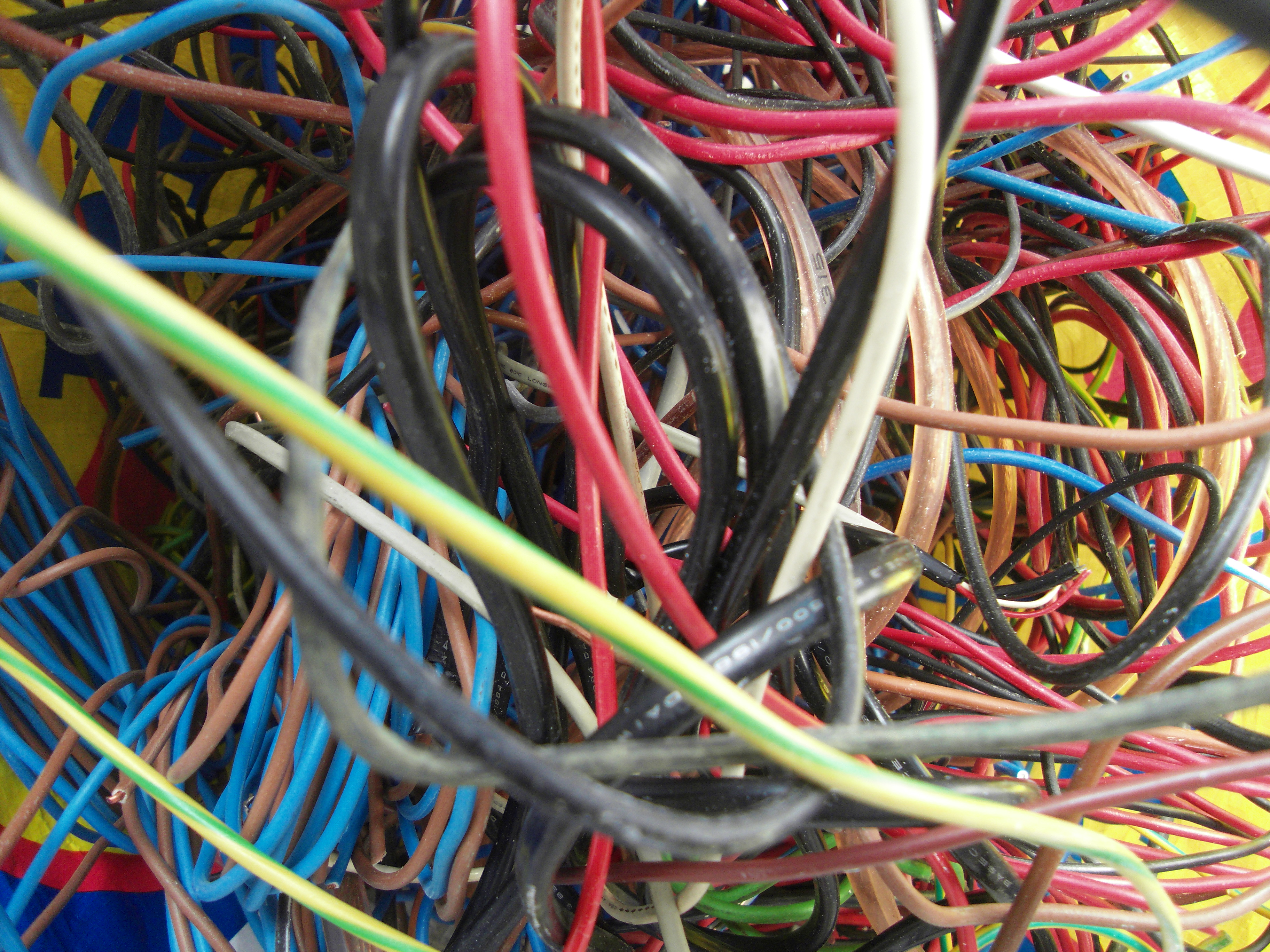

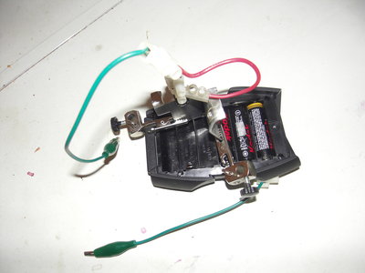

The first thing I did was- go out shoppin'! After a very brief youtube surf on the theme, I marched wholeheartedly to the electronics shop and bought a transistor and a resistor so that I could start some micro resistance measurements on a collection of wires I have scavenged, using a diy four wire tester.

With the new components; I half baked a very generous serving of what I call palaver cake, which in hindsight has too bitter an after taste to be palatable; but is still hanging around as a reminder of how efficiently can derail a project if I don't stay on target.

Staring at Medusa's face http://www.mz.cx/technik/elektrik/schaltplan-12v-l.jpg a little longer I am slowly translating what I have in the box, with what is illustrated on the diagram. It's now evident that several disconnected electrical engineers have been stiring at that box and that the existant loom on my engine doesn't correlate with factory settings either.
