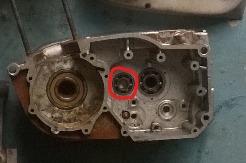

I believe there is a little space behind the bearing but not much. Just enough to get a bearing puller in. I hope I can borrow one off my neighbour as this is one of the only 'special tools for vehicles' that I haven't bought over the years. The bearing itself is open sided and is a 6203, so internal diameter is 17mm according to specifications on the internet.

Postby Skyeport » Fri Nov 10, 2017 4:01 pm
The space behind the bearing is quite small. I bought a bearing puller from the local tool supplier, but there wasn't enough room for the jaws, I'm sure I'll use the puller somewhere else...maybe.
Be cautious with the hydraulic method, there is only a thin bit of alloy behind the bearing & too much pressure on a stubborn bearing may pop the case behind the bearing, don't ask how I know, although this makes it easy to get at the bearing from the other side..................

Postby Skyeport » Sun Nov 12, 2017 12:17 am
I am not sure how oil would work either?
I used candle wax not oil, same principal just thicker & doesn't leak through the bearings as easily.
This is the bearing in question?
