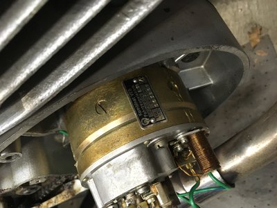

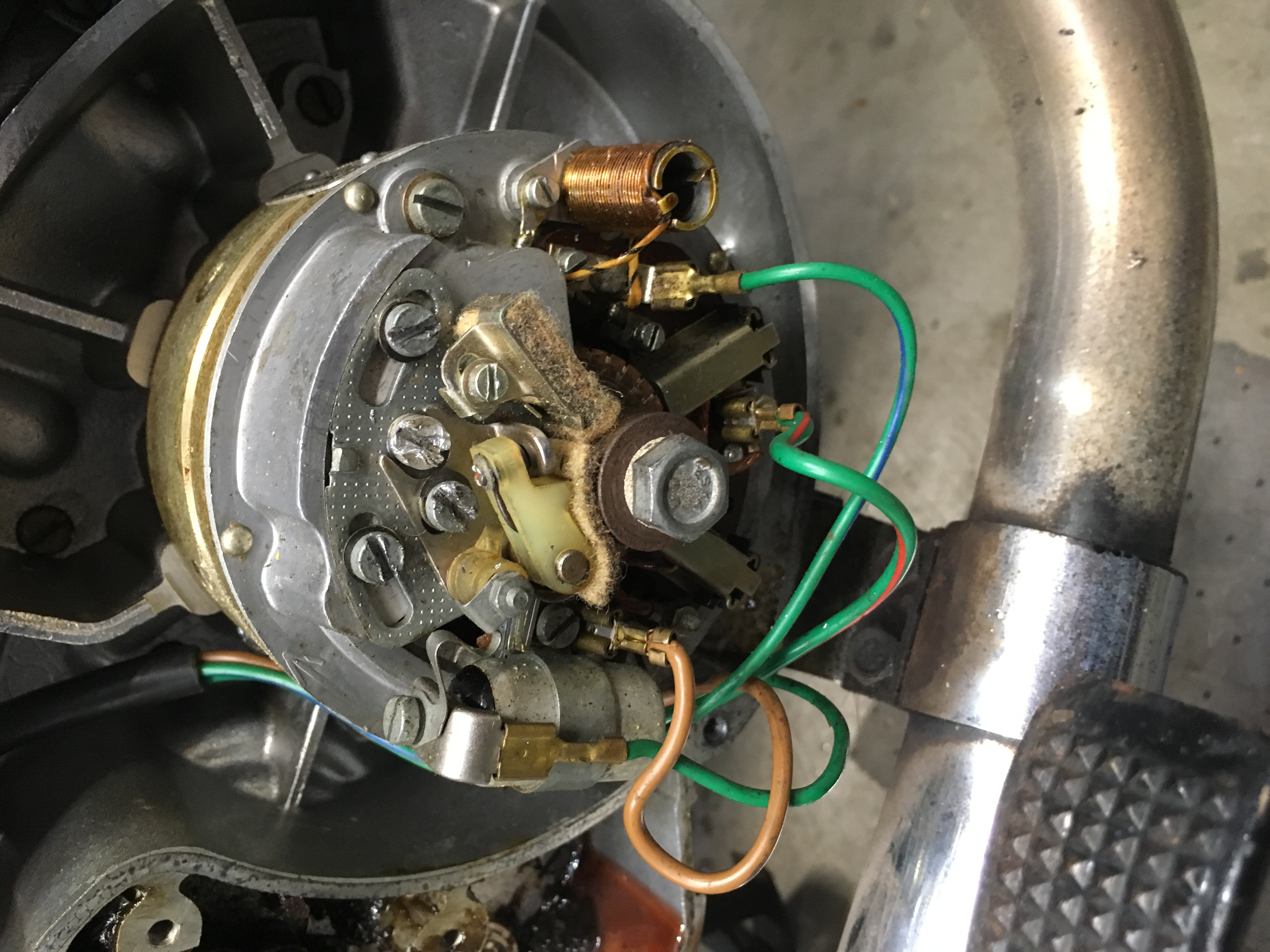

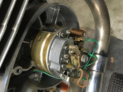

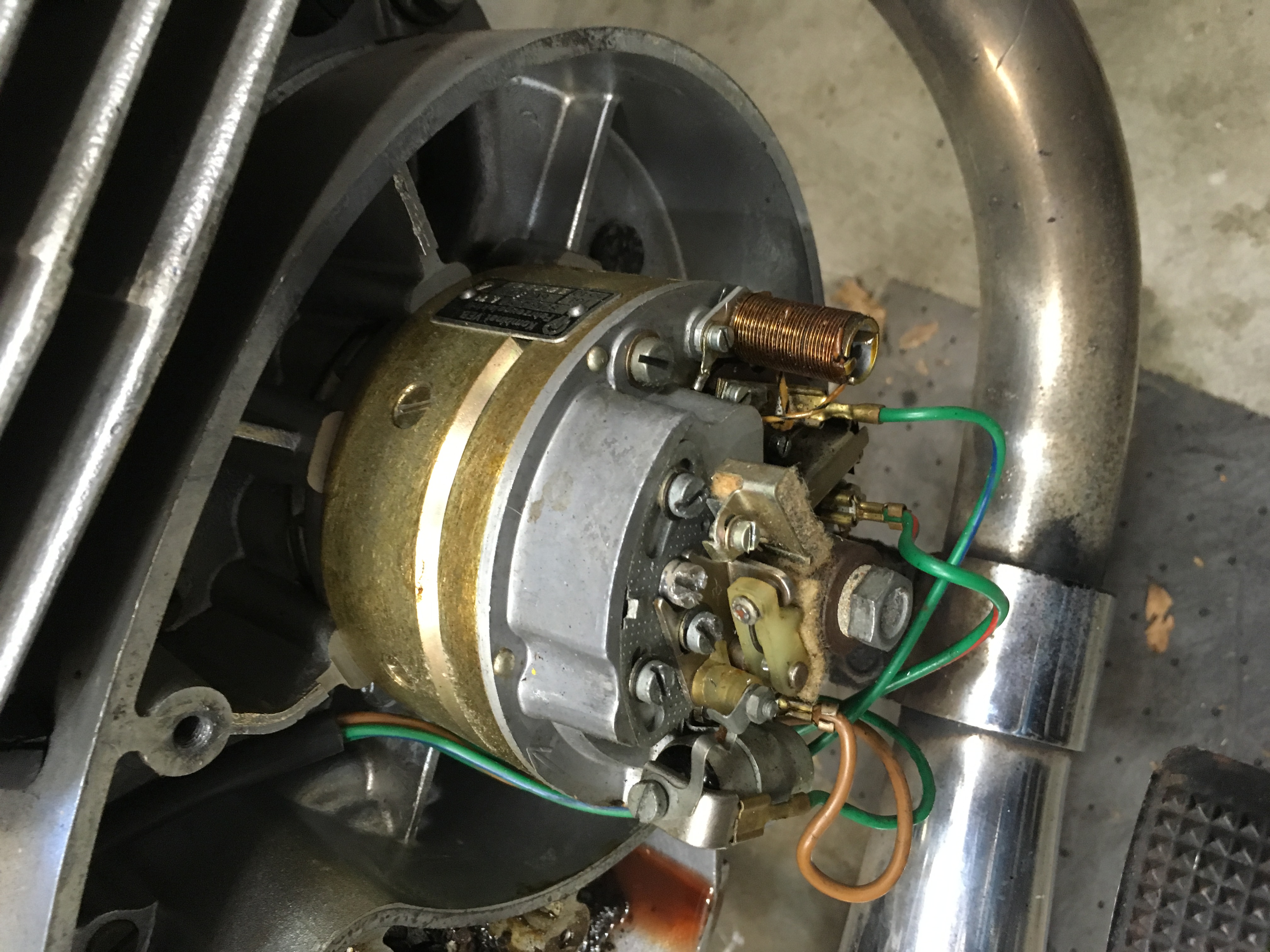

I have a couple of images here that to me, make the bike seem pretty new and unused... Looking forward to your thoughts.

The felt attached to the contact breaker itself is normal- it is there to catch excess oil on the cam that would be provided by the other felt. Or so the factory manuals say. There is a rectangular hole so that the points foot is not lying on the felt- but the cam.

Looking at those butchered screws makes me think this bike has lots of miles on it. The first thing I would do is burn out the muffler. I have to do that twice since 1985 on my ETZ and many times on other two strokes.

Whether the felt should be under the heel of the contactor breaker or not I would remove - surely it will affect the opening / closing / gap of the points - I would at least try it without the pad.
