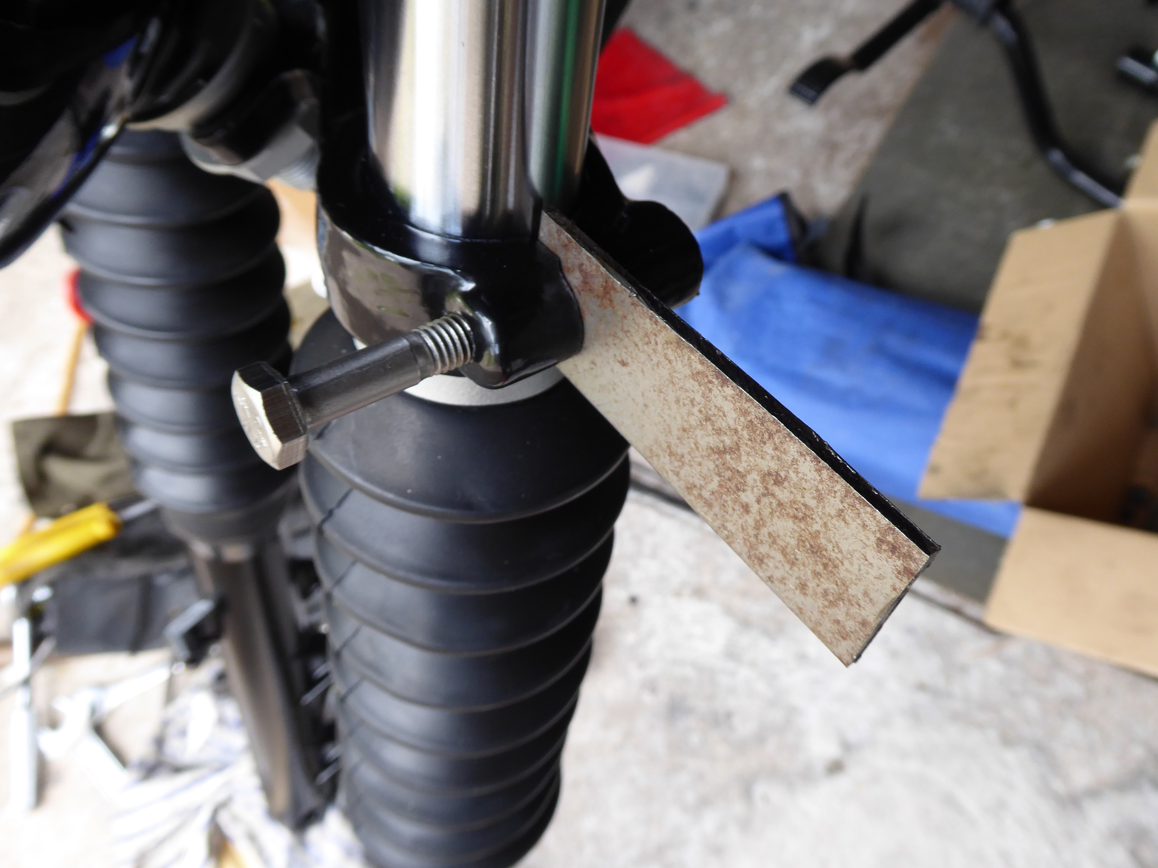

Here's a neat trick to make fitting fork tubes (stanchions) easy.
Rather than splay out the yoke gaps by hammering in a wedge or levering with a bar or screwdriver....simply insert a piece of steel and screw in the bolt from the front as shown. This way you have complete control without the likelihood of the lever dropping out or damaging the finish on the yoke...

Thanks chaps for the feedback....By the way, this method can be used (of course) to remove the fork tubes when usually, because of corrosion, even greater clearance is required. Obviously lots of penetrating oil should be applied in advance to soften the rust. Don't overdo the gap stretching though... :shock:
