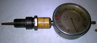

Anyway, for completeness my dial gauge fixation:
Dial gauge in modified plug.jpg (18.85 KiB) Viewed 19123 times
I actually rarely set (or check) the timing, if you get the gap between the points right, the timing is right too. Just a bit of sandpaper to clean them is often enough.
