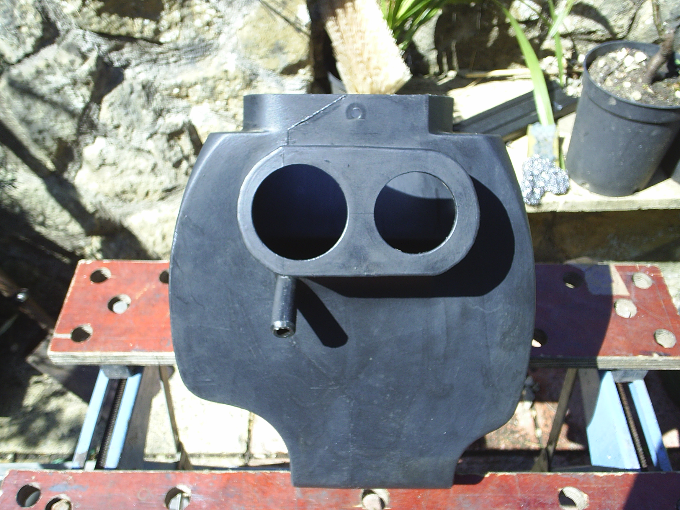

Only in order to modify it to fit an appropriate air filter.
Re: Single carb on Mastiff AGAIN!

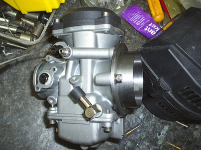

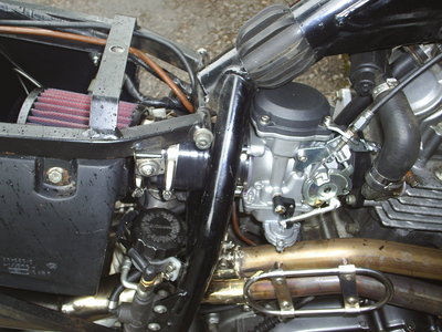

Postby breakwellmz » Mon Apr 20, 2020 2:40 pm
A mate turned up an adaptor to match my K n N filter to the carb for the price of a packet of fags and i put in the three attachment holes.
Pulled out the vent passage cap on the side, tapped it M8, and screwed in a modified brake bleed nipple to which a rubber pipe is pushed on to.
Rusty enrichener cable is only a temporary one!
Air box modified and now await a 60mm ID silicon coupling hose -

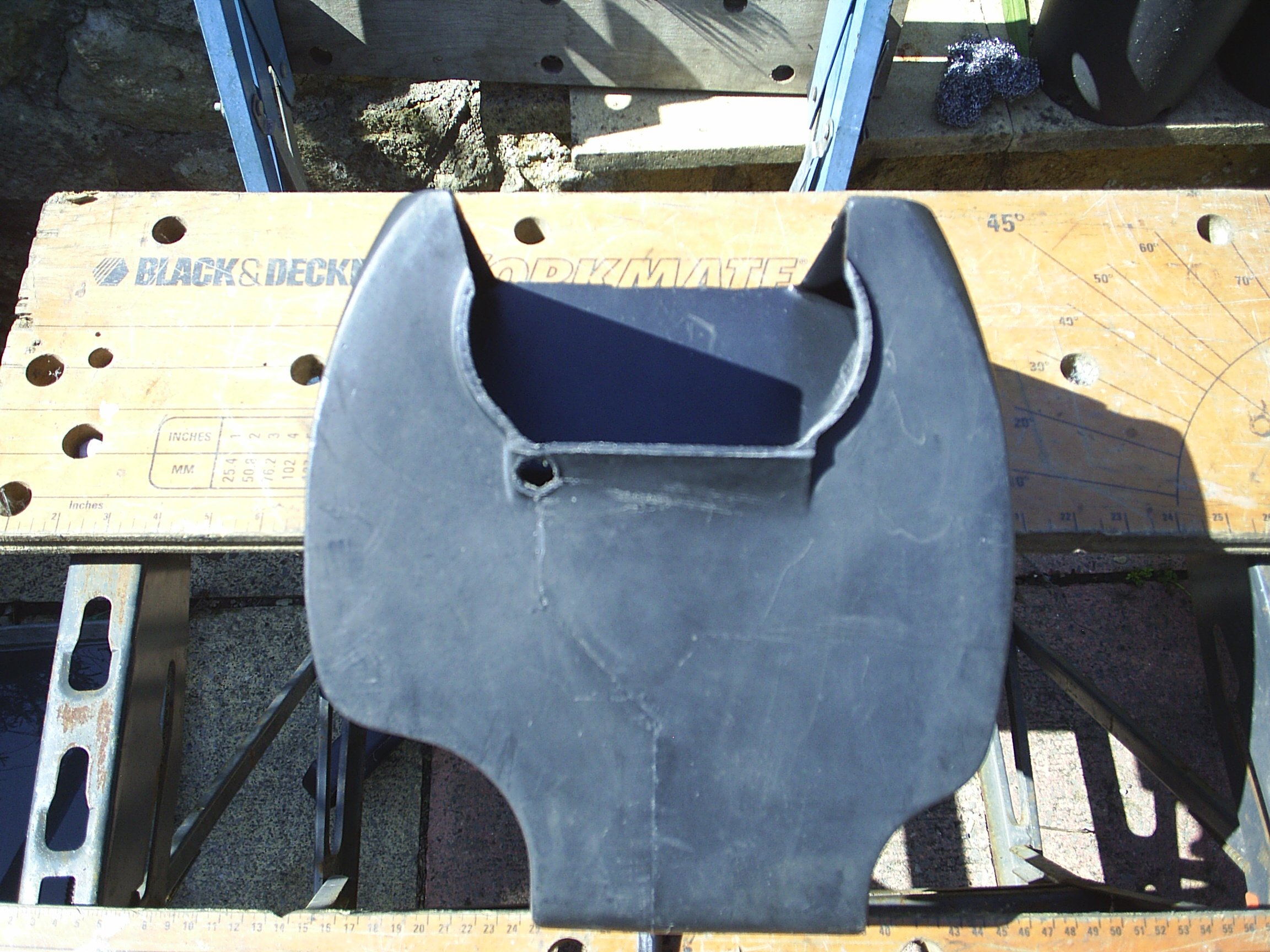

I don't know what the air box looks like on the Mastiff, but on many bikes there seems to be little breathing space between the seat & the top of the air box. But it's far away from the carb, with that volume of the air box between it, evening-out the pulsating suck-suck-suck of the engine. I guess they thought about it. Also reduces noise, as you know, an open throttle can make a bit of noise too. Hence the foam on the lid in

Well i`m so pleased with the way this runs i`m going to keep to this setup and not bother with the manifold and other inlet port, so thank`s to STANIMAL for the inspiration! viewtopic.php?f=3&t=7357
It`s more prompt to start and idle (especially from cold) and power is stronger and more linear right from idle up.
There was no numbering on the pilot jet but best idle was about 2 1/2 turns out so it must be in the right ballpark.
I`ve raised the needle with one M4 washer but i think i`ll add another.
I must add that i replaced the original silencer with a regular looking, road legal silencer and baffle and opened up the airbox at the same time as fitting the carb, so i`m not exactly comparing like with like.
