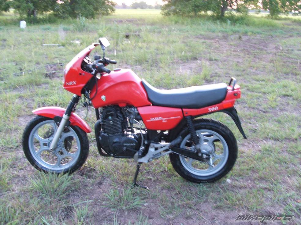

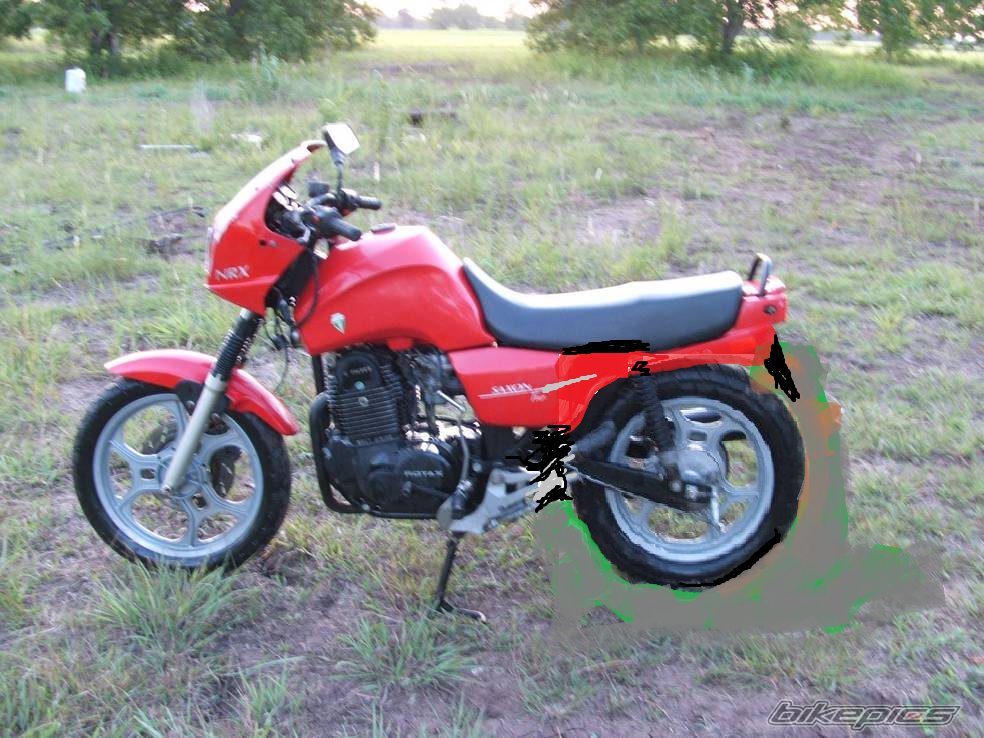

Postby nice2day » Thu Jun 25, 2020 8:33 am
Some really great points on your replies Puffs and Blurredman, I'll come back on these a little later. Just for now, before I take my dog out or his daily walk, I've knocked out a very quick alteration on an MuZ showing original and lengthened bike with bigger rear wheel. OK it was done in about 5 mins so it's very rough but maybe enough for you to see the "Improvement?..or ruination? :lol: :lol: :lol: For me I'd take the longer bike if factory made that is: CU later.
Les

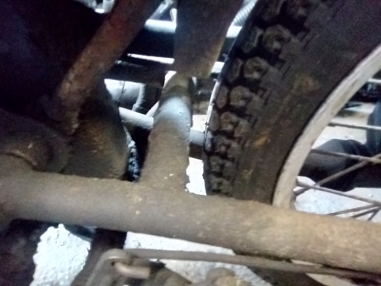

I took my spare rear wheel out- it is an 18", so can test. Need to buy new bearings for it first though. They're already in the post.
I don't think it will fit though, or if it does it will be merely mm from the swingarm cross member. Might be able to get away with using the 3" tyre as opposed to a 3.5".... As it stands, it is pretty much an inch, maybe one or two 16ths over, space between the crossmember and the 3.5"x16 wheel that is currently on there..

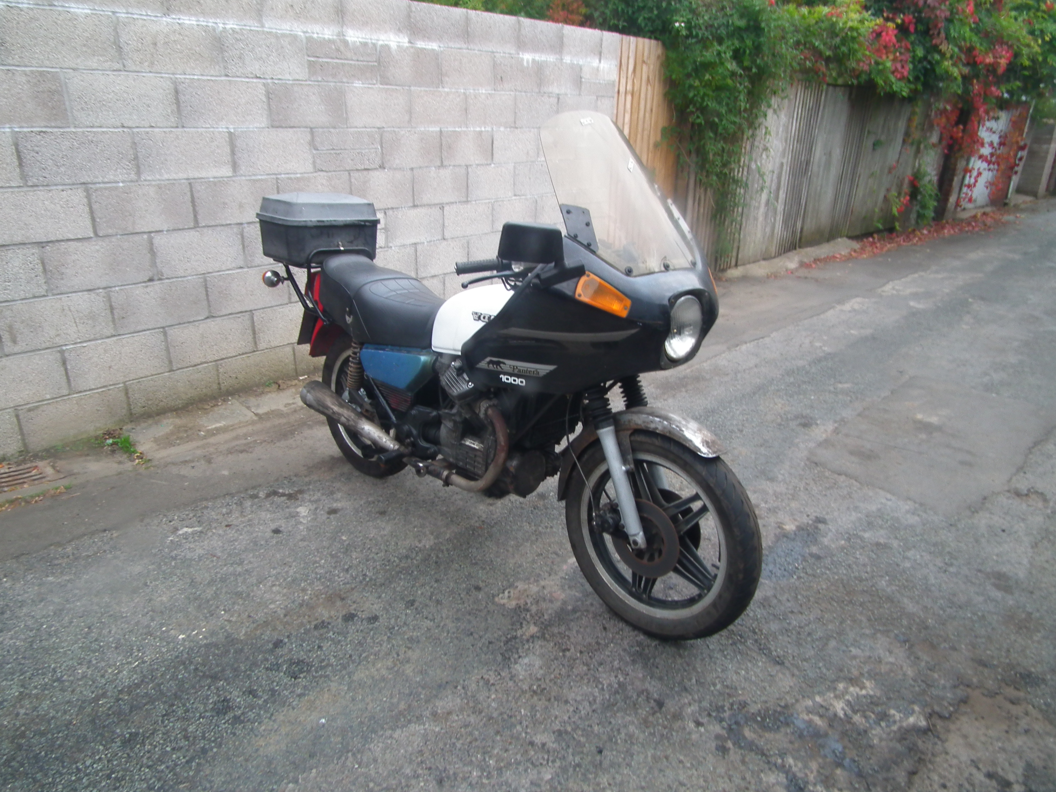

I hear you regarding the fairing.. I ride this:
Of course, it's a bigger machine than your 301, and also a lot uglier.. But it is straight and stable at speed, and actually, very confidence inspiring in the corners, HOWEVER I experience what you do regarding low speed riding between two sets of cars. The white lines, the tarmac joins, influences the fairing and the gravity of the bike largely and can cause some sticky and close situations in that scenario. Now your fairing is a heck of a lot smaller and lighter so might not be the same situation.

I did buy bearings but they have yet to come, but after fitting a tube and tyre to my spare 18" wheel, I couldn't help myself but have a look.
Here are my findings, keep in mind without bearings there maybe some changes to clearances, but they're large enough in my conclusion for this not to be a factor. I moved the wheel about to try and ascertain any issues but found none. Of course it helps that the right hand side of the wheel mates into the cush drive fairly squarely, wheel bearings or not. I am also sorry for the poor photos, it's not a nice day and I also couldn't be bothered to get things out of the way in order to wheel the bikes around for better camera angles..
Foremost:
The chain on the 251 is new. The adjustment in the tension is approximately in the middle, not extreme to either direction.
The new tyre is a 3x18" Mitas H-03 with only a few hundred miles worth of use.
- Gap between swingarm brace and tyre = 1/2".
- Gap between bottom of tyre and ground = 3/4".
I think it doesn't look too bad in my opinion... I would wonder what a 3.5" mitas would look like instead, but I think that might be touching it a bit fine with the gap with the swingarm brace. Of course, the tyre itself wouldn't look like a bicycle tyre if it was 3.5" but I don't think it's worth messing around with my two bikes just to see what it looks like and then swap back.. ;-) Clearance IE mudguard all look fine. It's quite a deep and wide mudguard on these 89-90 251's (as you can probably tell by the rear facing pic)... But the front side still looks like it would clear without an issue.
By the way, distance on 251 front axle to rear axle approximately 52.5".
Distance of 250 front axle to rear axle approximately 54.75"
Of this, the 251 is from front axle to swingarm spindle: est 35" and swingarm to rear axle 17.5"
And the 250 is est 36.5 from front axle to swingarm spindle and swingarm rear axle 18 and 1/4"
Not scientifically done, but - it emphasises that there are length differences in both swingarm length, and also swingarm spindle forward.. It's not all about the swingarm length and subframe, as puffs says.
When I get my bearings I will re-install the wheel and have a little pootle and see how it runs/rides.. Might be fun..! All in all, it really doesn't look too much taller than my 3.5"x16" wheel in reality..

Oh Blurredman, what a tremendous effort you've made! I really applaud you on this one, especially doing all that measuring and then actually swapping over the wheels. Really well done and so interesting actually finding out the different lengths and distances.
As Puffs says, the steering trail will be reduced very slightly so this will minutely quicken the steering so it will be interesting to compare how it handles. New rear shocks of 1" shorter would return the original geometry and seat height as long as you had sufficient clearance under the rear mudguard for the tyre and fitting the longer 250 swing arm would also load the front end more and increase stability too.
I would be very interested to see how it looks too (does it look better as I had imagined?). Perhaps not so much on the centre stand (which is probably a little wobbly now?) but propped up on the side stand so the suspension is loaded ....Once again many thanks for taking this up.

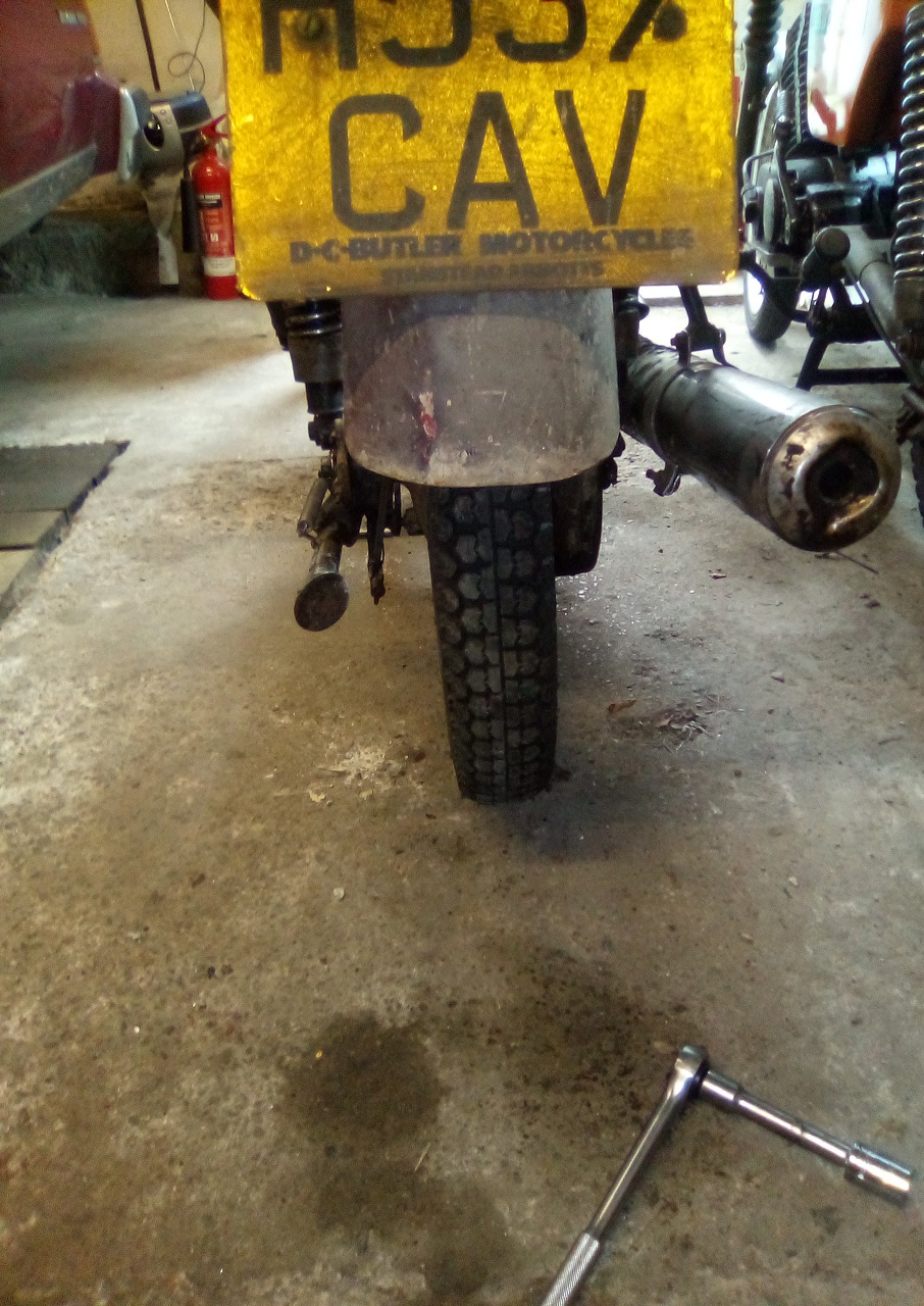

By the way I notice the number plate has the supplier of "DC Butler" . I knew that shop in Stanstead Abbots (is it still there?) , I wonder if you live in that area? I was going to buy a new Enfield Bullet from him back in the 80's, he was a friendly bloke, but I never did.

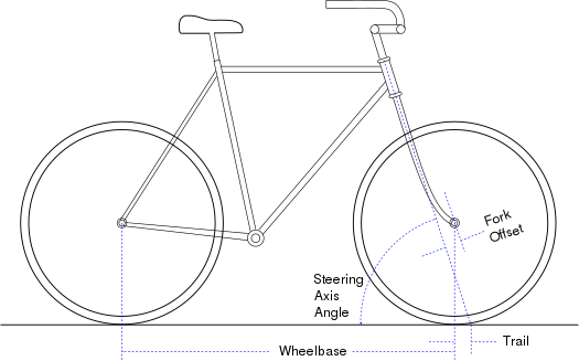

Postby Puffs » Sun Jun 28, 2020 6:07 am
Gents,
firstly Les, I'm not sure I quite follow your 27 Jun 2020, 12:35 post, but if I remember correctly, sir Isaac taught us that kinetic energy = ½mv², and that F = ma. Anyway, if you cannot find specs, the geometry could also be measured. And specs appear to be not always completely accurate or correct. And finally, yes, try it without to feel the difference (if any).
Then indeed, ta Blurredman for all that effort to confirm that indeed an 18" wheel will only fit properly with a very small tyre size. You fitted a 3.00" tyre, which gave you 0.5" clearance to the front brace, with the wheel in the middle of the adjustment range.
Tyres in imperial sizes are normally 100% in height, meaning they are as high as they are wide. This is particularly so for the relatively small sizes, but for bigger sizes (>5") not so much, those are less high. Anyway, it means that if you would fit a 3.50" tyre, it would sort of rub that brace, with the wheel mid-way in the adjustment. And would give about 0.25" clearance below the wheel, when on the centre stand. But: a 18"x3.00" tyre will fit & work well, with some possible limitation on the adjustment range. Note that Eric Frith fitted a similar tire after moving that brace forward:

The standard tyre is a 16"x3.25", so a 18"x3.00" will raise the back by 0.75", given the wheelbase, the difference in steering angle & trail is easily calculated.

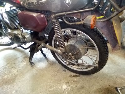

One thing I'm not sure you tested is what happens when the shocks reach the end of their travel. The top of the tyre will then also come 0.75" further up. It may fit, they probably gave it quite some clearance, it may not, certainly not if a bigger tyre were used, like so: Image
See the wood below the centre stand & that the tyre is not quite properly centred around the wheel axle, as it can't go farther forward. OK, it's an 18"x4.50".
Anyway, that is something that also needs to be tested (by taking off the springs & bump rubber). At the time I eyeballed it, and I didn't think it would fit with a meaningful tyre (and no, that is not the 4.5" one). Also, I believe the shocks for the 250 are 20mm longer (in fully compressed length) than those for the 251. So you may have to fit those taller shocks, and add their extra height (x the linkage ratio) to the previous 0.75" for the new geometry.
