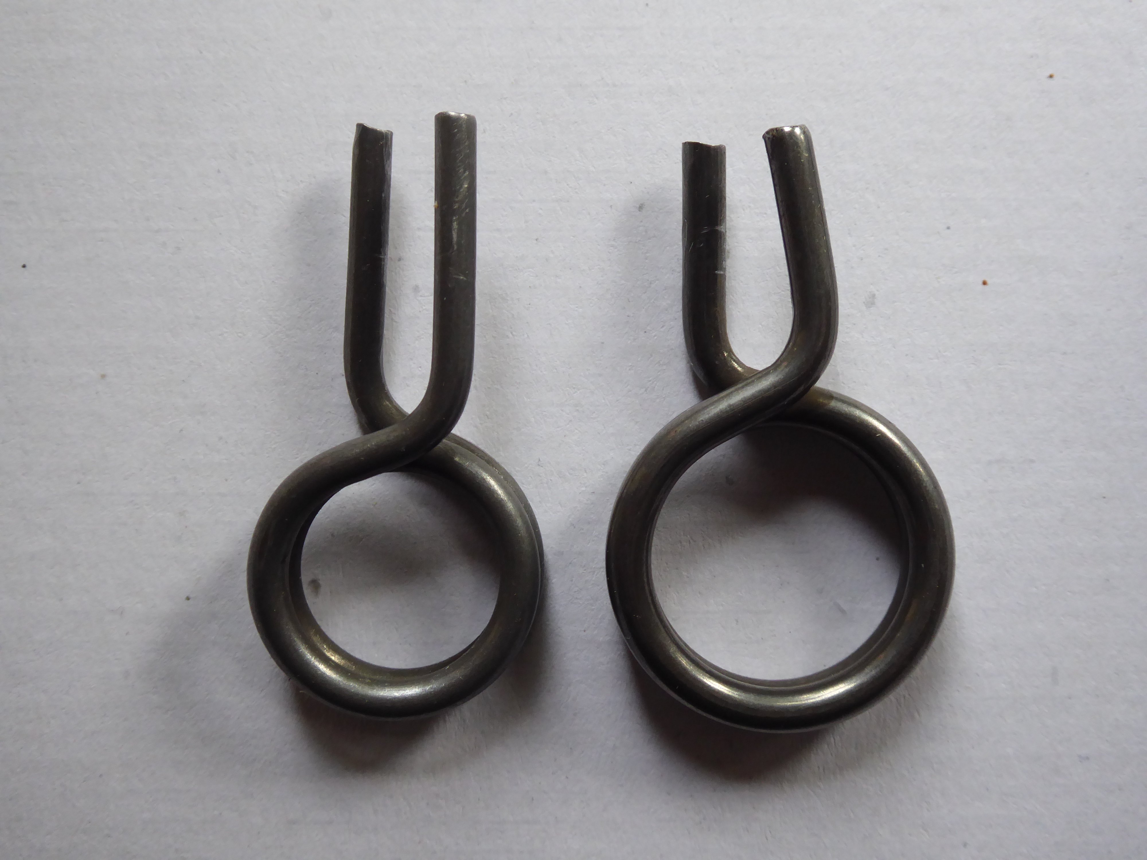

Postby nice2day » Thu Sep 10, 2020 4:00 am
I thought you would like to see the difference. It is hard to believe that such a large well known MZ spares dealer could get these mixed up and then not bother to reply to my 2x emails :cry:
The correct original is on the left. As you can see, the big spring moves around on the selector shaft and it has shorter legs which don't reach the locating peg if the position moves away due to the large clearance of the hole.

Postby Puffs » Thu Sep 10, 2020 4:28 am

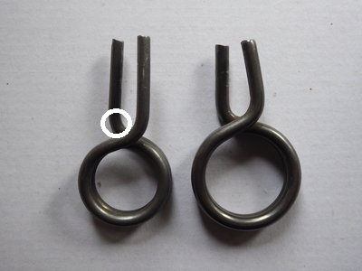

Postby Guesi » Thu Sep 10, 2020 12:38 pm
The problem with the original springs is that they have a notch due to the production method. On the picture the area where this notch is is marked with a white circle.
You can feel this notch when you go over this area with your finger nail.
This is the weakest point of the spring (a breaking point).
And if it breaks you have to dismantle the whole engine for this little and cheap spring...

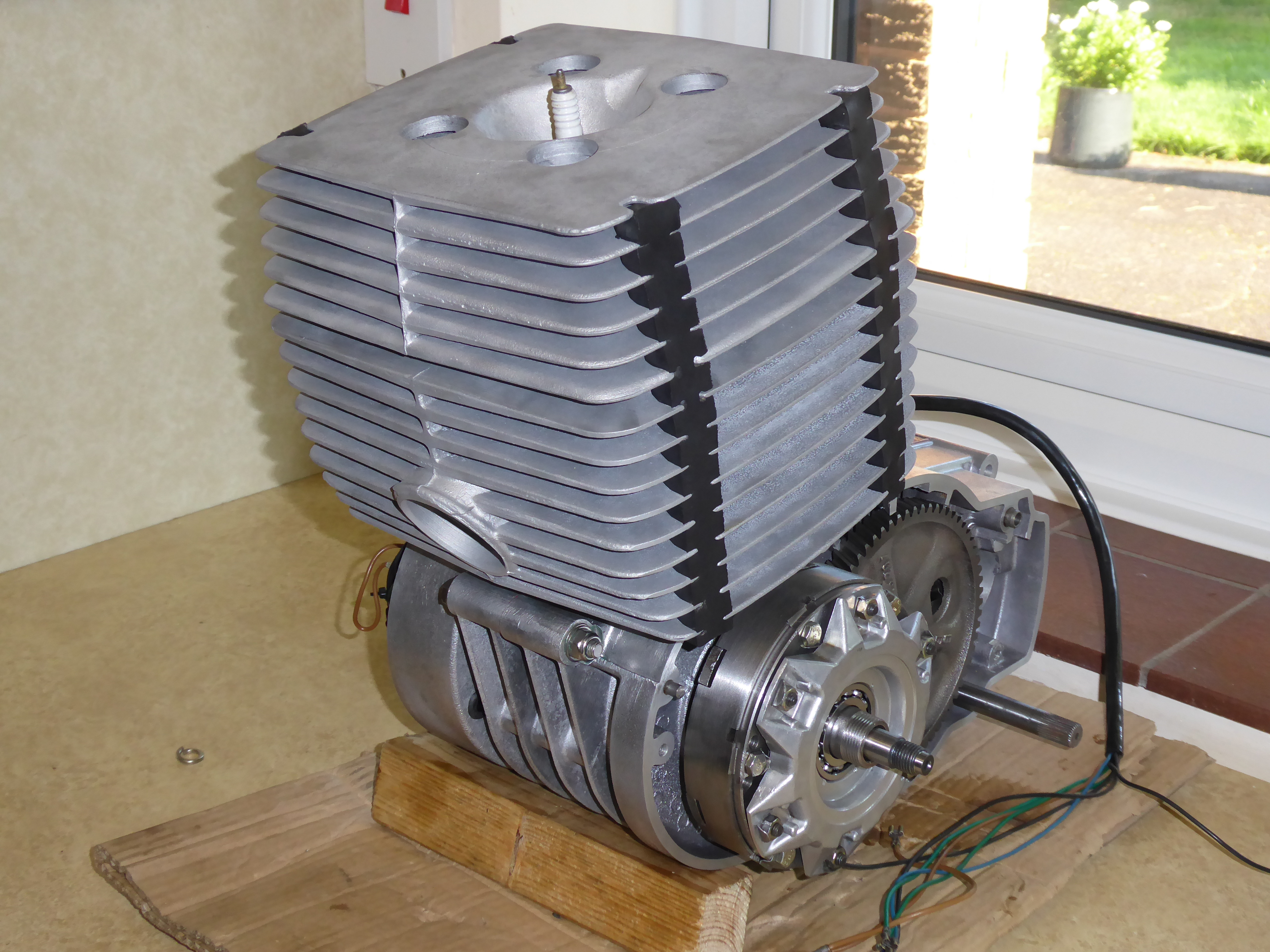

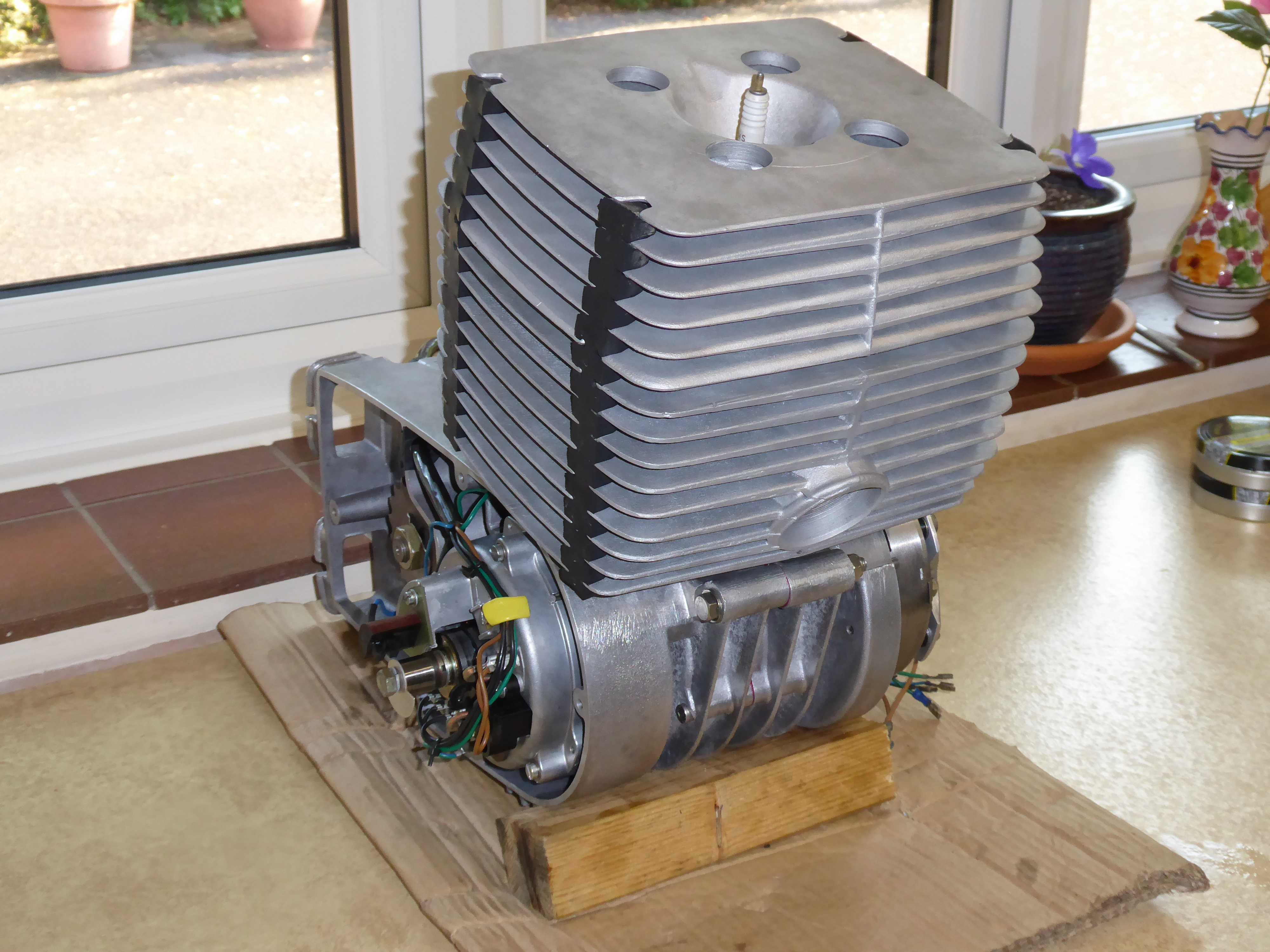

Postby nice2day » Mon Sep 14, 2020 2:16 pm
Just thought I'd show the complete engine before fitting it which I have now done as a single unit as per Puffs recommendation. It was quite easy but as usual, if I were to do it again tomorrow it would be ten times easier...Photos of the engine in frame to follow soon.
