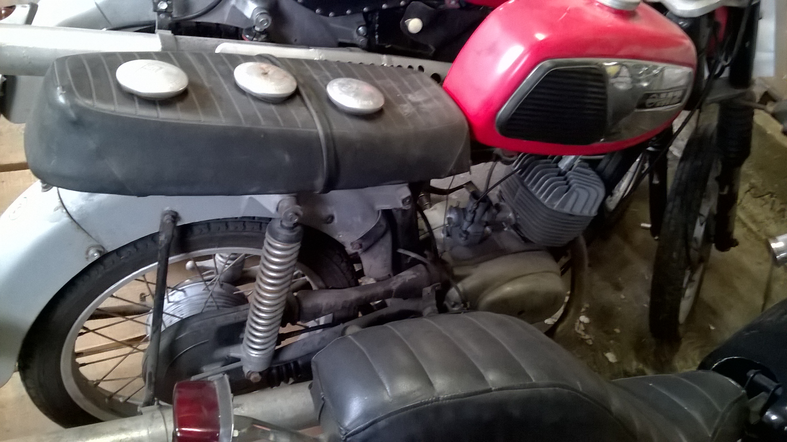

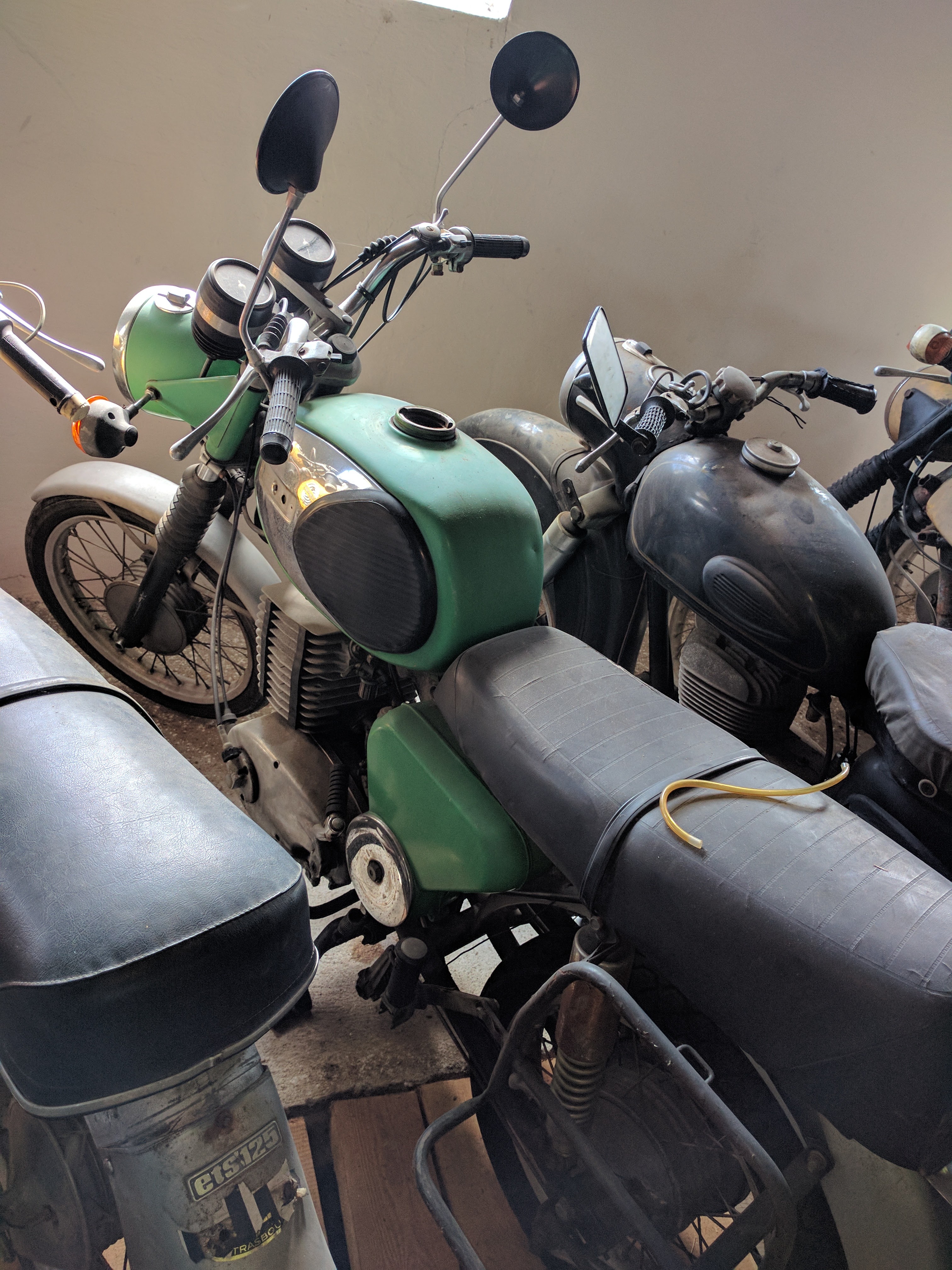

Postby Guesi » Thu Sep 24, 2020 3:15 am
The tank on this picture has 12,5 Liter.
The 17,5 Liter tank looks like this:

Re: New member intro and TS250 fuel tank size question.
Postby R1100purist » Thu Sep 24, 2020 9:14 am
Thanks Guesi! So it looks like I have the 12.5 liter tank on my ts250. Is it a fair assumption that only the ts250/1 “supa 5” came with the 17.5 liter tank?
Postby Guesi » Thu Sep 24, 2020 11:41 pm
No.
The 12,5 Liter tank was on the US Export models.
The "original" TS 250 and TS 250/1 all had 17,5 Liter tanks.
Your 12,5 Liter tank was originally from the TS 150 Model.

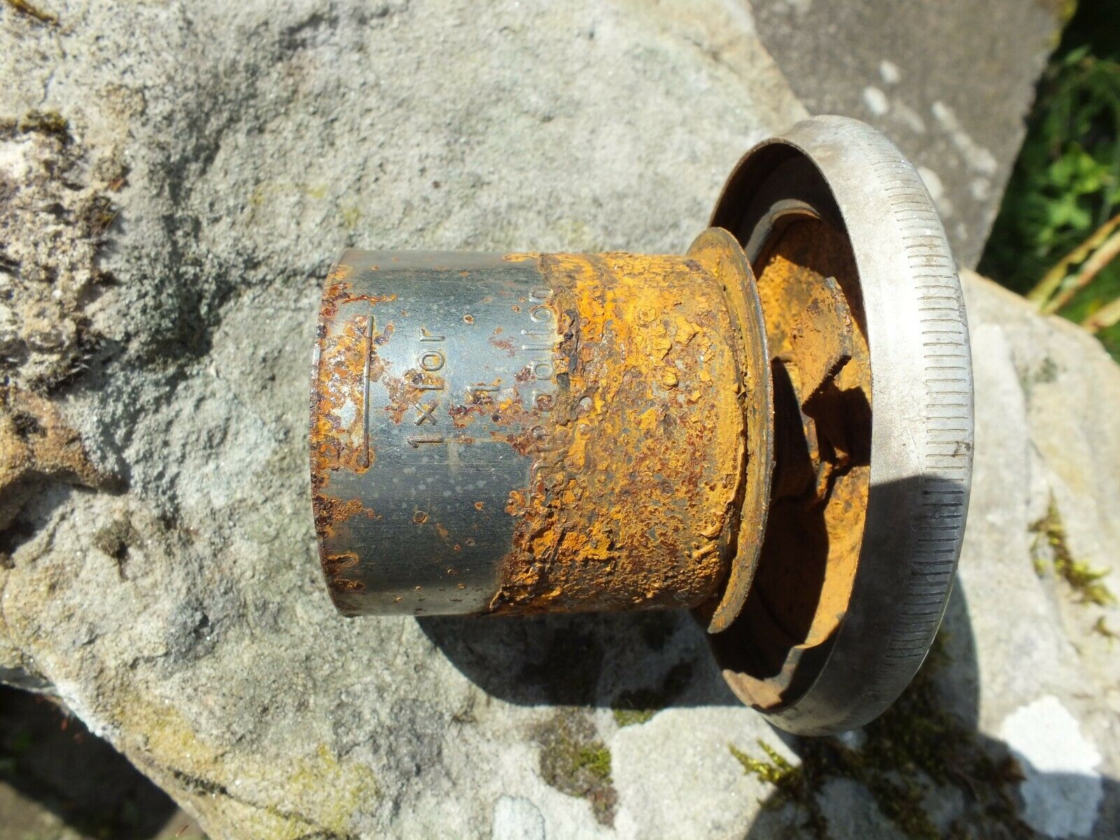

Postby breakwellmz » Sat Oct 03, 2020 8:40 am
R1100purist wrote:Okay I found some TC grade 2T oil (Lucas semi synthetic) and going to run that on 40:1 based on previous owners recommendation. Now I just need to figure out a solution to carrying around/measuring the oil While on the bike.
All my two stroke MZs (I`ve had five of them) had a measuring pot on the underside of the filler cap marked 33:1 or 50:1 depending on engine size, doesn`t yours? Carried a bottle of oil behind a side panel.
