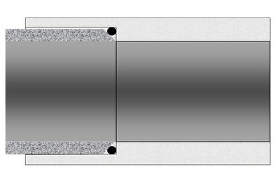

Inlet side of carb sucking in air ... there's a handy lip inside the inlet stub where you can put an O ring. A set of assorted generic O rings cost about two quid. Order a specific single one often & it costs something silly like a fiver!

Hello JawasandMZs. I'm pleased you mentioned this idea as I also thought about doing the same thing, it would be a very simple and highly effective fix.
I gave this lots of thought a few days ago and maybe I'm worrying too much but I considered that the rubber O ring has a slight chance of distorting inwards and getting sucked down the manifold stub into the engine as there is nothing to really hold onto it. As you would know AMAL carbs use an O ring in this position but they have a circular groove that the O ring sits in so the O ring is trapped in position. There is enough metal on the stub of the carb to machine a groove if you had the necessary milling equipment and this would solve the problem. I then considered that instead of an O ring you could use a thick fibre or hard rubber washer the exact size of the lip inside the manifold. Being so much stiffer than an O ring it would resist being distorted by the suction and because of this stiffness would not be able to get sucked into the induction tract as the diameter would be too big. I even thought that some enterprising person could get a batch of steel washers coated in soft rubber made up and sell them to MZ ETZ owners. This would, I am pretty certain, cure any air leaks on this carb set up....as long as the carb was pushed in hard against it and clamped up.

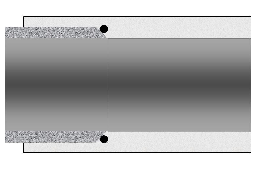

Postby nice2day » Wed Nov 11, 2020 6:45 pm
Just before I turned the computer off another idea came into my mind. :smt004
If you wanted to pursue the O ring idea rather than a washer, here is a safe way of implementing it.
Choose an O ring with a thickness of about 3mm and an Outside Diameter of exactly the manifold tube diameter at the lip position.
Then carefully file a 2mm chamfer at around 45 degrees all the way round the edge of the stub of the carb. When pushed all the way up to the O ring, the 45 Deg chamfer would hold the O ring securely in place and at the same time squash it and seal perfectly at the perimeter....perfect. :D :D :D

Postby Puffs » Thu Nov 12, 2020 5:55 am
Hi Les,
to me those eBay silicone washers seem nice, simple & effective, while filing your carb stub seems less attractive. But all those approaches rely on the carb stub retaining a forward push into the manifold, which might not be the case over time.
To be sure that leaking there really is the issue, I'd just assemble the carb into the manifold with some silicone sealant.
Note that a leak there will only influence idling; once you open the throttle that makes for a much bigger hole and the ΔP across that joint reduces.

Postby nice2day » Thu Nov 12, 2020 8:13 am
Hi Puffs thanks for your views and I agree with every point you make. :)
I think you would agree with me though that if the seal, whether it was a washer or an O ring, had quite a degree of "sponginess" or compressibility, the carb would not be likely to move that much to slacken the compression on the seal. In fact it is not likely to move hardly any amount in practice but yes, you still need the initial compression on the seal which makes the rubber O ring ideal but it does need retaining in a cavity of some sort. A rubber washer will also work but I don't know how "squidgy" the silicon one I recommended is so I take back that recommendation.
I agree that obtaining the bevel on the carb is a little tricky but not too difficult to get a decent shape I think. I would use a sheet of coarse wet-and- dry on a surface plate and swirl the end of the carb round and round with a wrist movement holding the carb at the 45 deg (approx) angle to get the bevel on the edge ....it's only soft aluminium and I reckon I could get it done in about 5 mins and it would be pretty even. It doesn't have to be that big, just a couple of millimetres wide :|
Silicon would work but it is a touch messy and not easily repeatable without lots of cleaning up.

Postby Puffs » Fri Nov 13, 2020 4:09 am
Hi Les,
I'd rotate the carb on a belt sander, 45°, and it would work, but still... it rubs against the grain to mutilate an original BVF.
To each his own, but practically I don't remove the carb very often, and I don't think that blue silicone would be messy at all. If so desired, you can assemble carb & manifold on the bench (clean-up with your finger through the carb). Or adapt/make another manifold using a rubber muff (as Guesi showed & me too on the Chinco carb).
