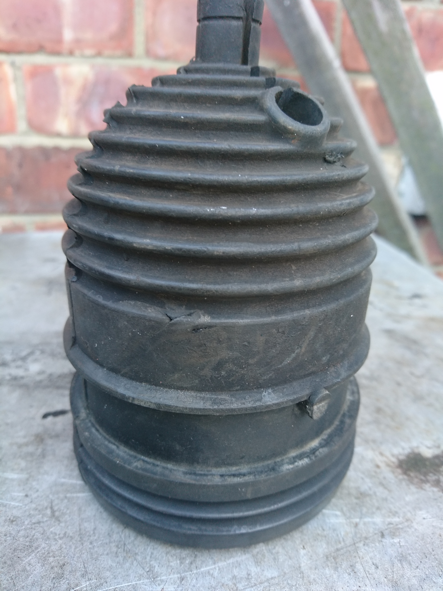

MZ didnt miss a trick; they just stopped using it. I can't remember what MZ this came from.

Very interesting. I noticed on my TS250/1 there are notches in the aluminium, but never gave it much thought. Interestingly, despite the notches, the original rubber housings don't have that protrusion. Maybe the later years they stopped...
So I assume they used that type of rubber housing, atleast, on the earlier TS/0 models.
Edit: Just looked upa some photos, TS125/150 models had that type of housing.

It could have come from a ts125.
My late Supa5, 1980, didn't have those slots
