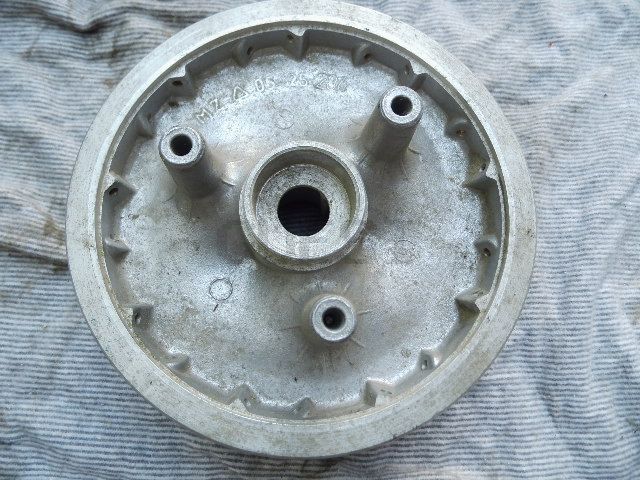

Postby Guesi » Sun Aug 29, 2021 1:51 pm
dirtsurfer wrote:incremental progress: I have respoked the rear wheel. I am currently waiting on new streering head bearings to arrive
Are you sure this is the right brake drum ?
For me it looks like one from TS/ES 150 bikes.
The ETS 250 drum should look like this:
Guesi Motorradteile
MZ spare parts
Posts: 468

Postby dirtsurfer » Tue Aug 31, 2021 7:17 am
I see what you mean. I will have to investigate further. I hope that wheel fits, The spokes weren't cheap.

Postby Guesi » Tue Aug 31, 2021 9:44 am
The wheel you have should has a diameter of 150 mm in the brake side.
The original wheel has 160 mm diameter.
Can you send a picture of the brake shoes you have for this wheel ?
