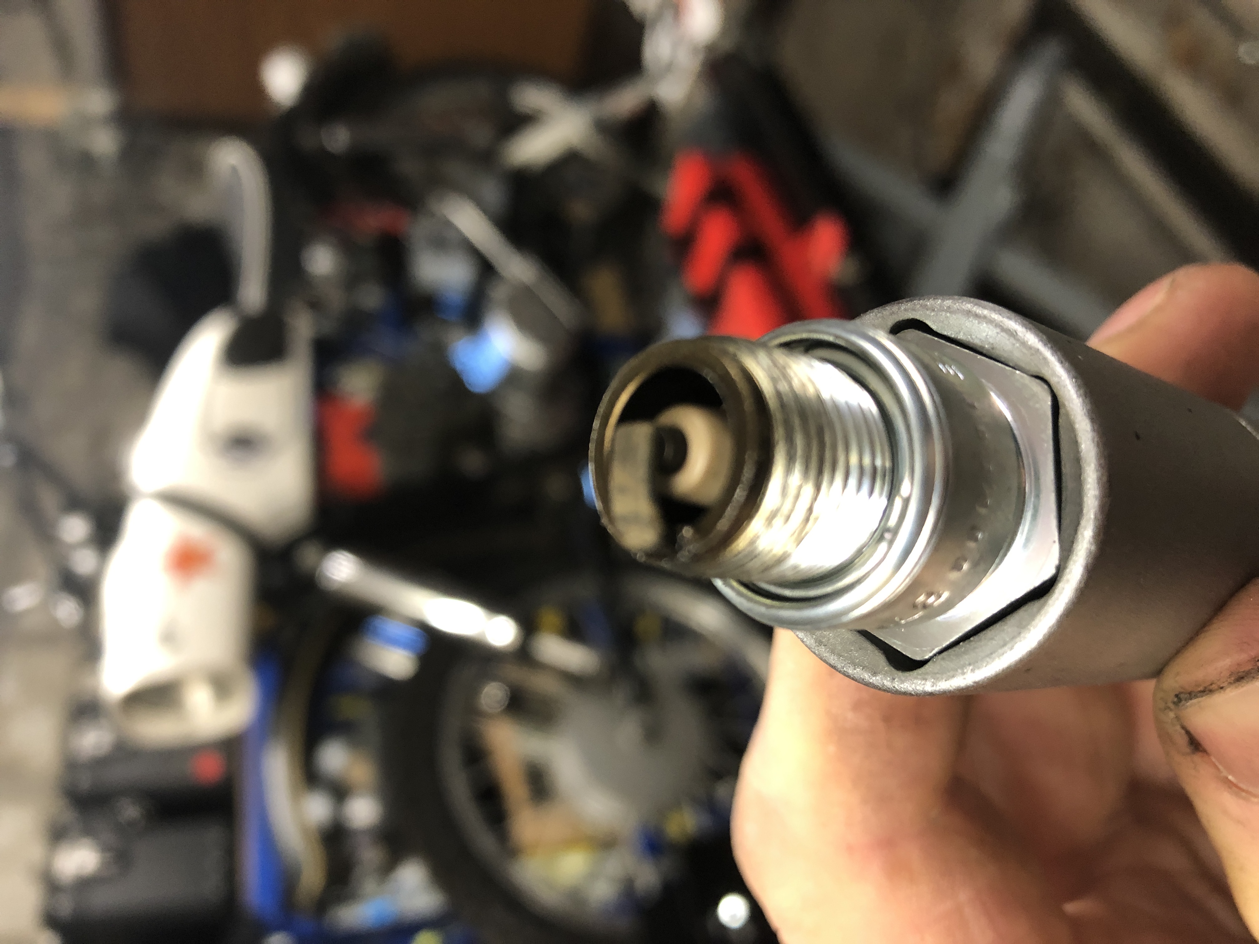

Plug colour:

Plug looks to show a weak mixture but has the colour changed from what it was?

Agreed. That is a lean plug!

I'm not sure that plug indicates a lean mixture. If the carb is in good order, and in the same setting as when it ran well, it shouldn't have changed. First sort the issue at hand, then maybe look at improving jetting.

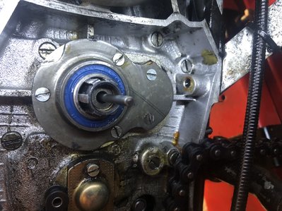

Thanks for you thoughts and input; see pic below from ignition side if it is the pictured layshaft seals you are referring to, these are the first things I changed but to no avail,it’s definitely not burning gear oil and the oil leaks through the clutch rod hole in the layshaft.

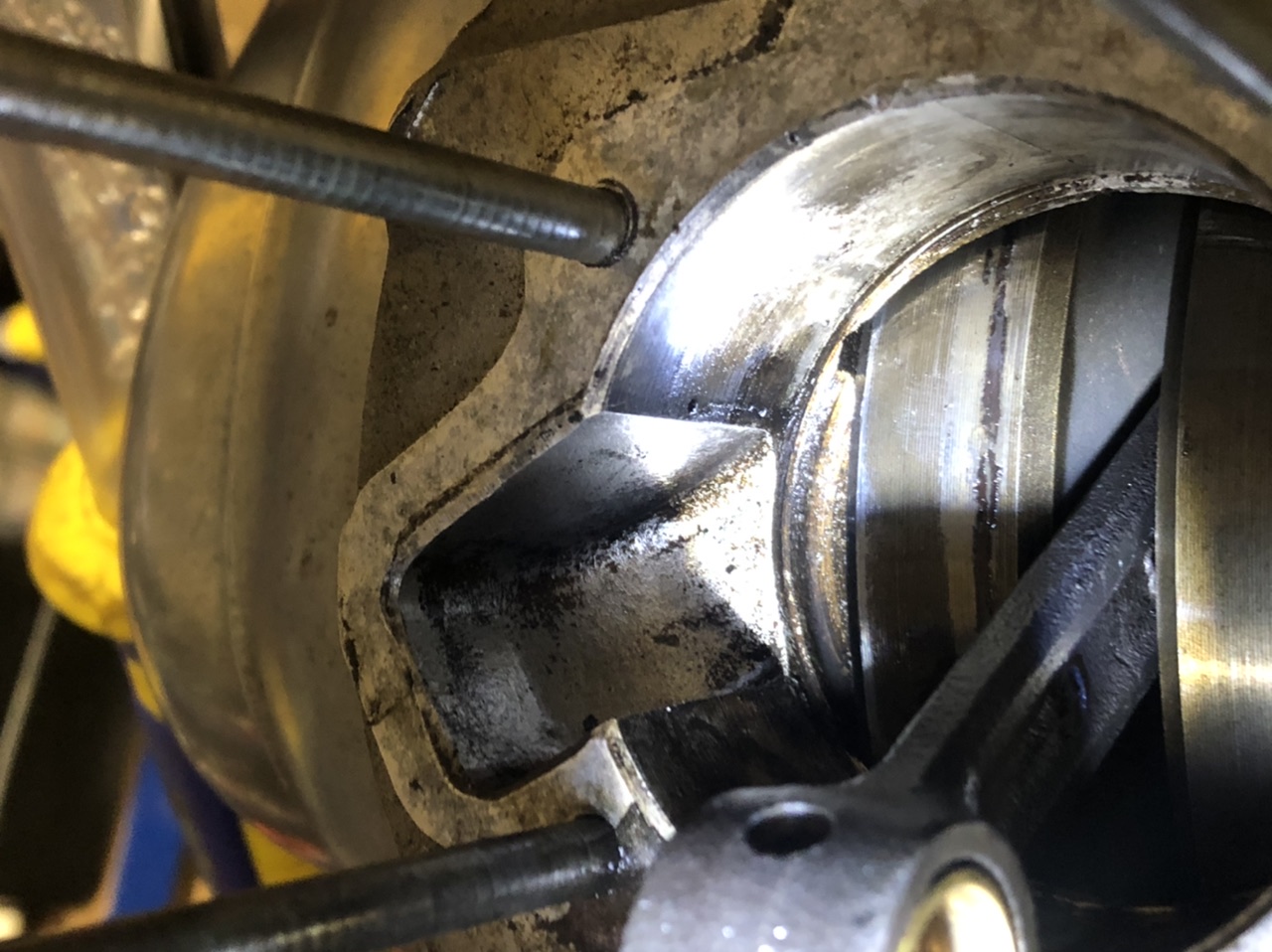

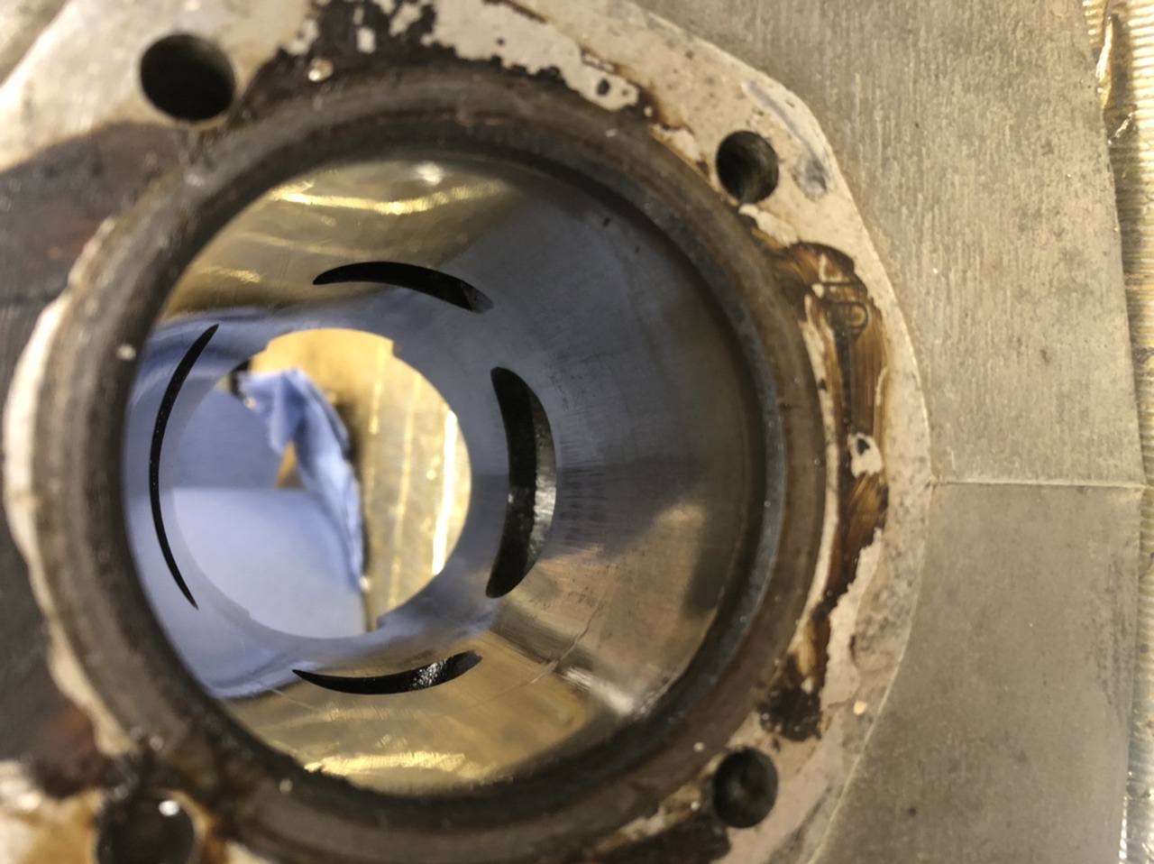

So head and barrel removed, rings are intact and undamaged and the bore looks good, there is a bit of scorching on the piston.
But the bad news: the crank is off centre and gouged where it has been hitting the casing, so could be bearing failure.
ScotBob

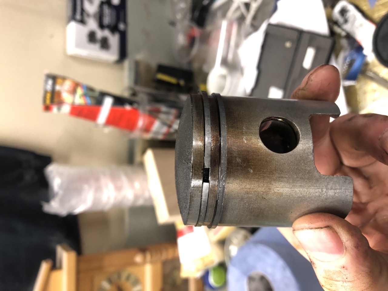

Postby ScotBob » Thu Dec 09, 2021 10:02 am
Piston and bore:
ScotBob

Postby AlanJ » Thu Dec 09, 2021 12:56 pm
Hi Bob,
Sadly looks as though you have found the problem. If you are right about the bearing, and, I suspect you are, then maybe it would be the right
time for an engine rebuild and if that is the case, and you want to go that way, then please give me a pm with your number, I may be able to help.
Stay safe Alan.
