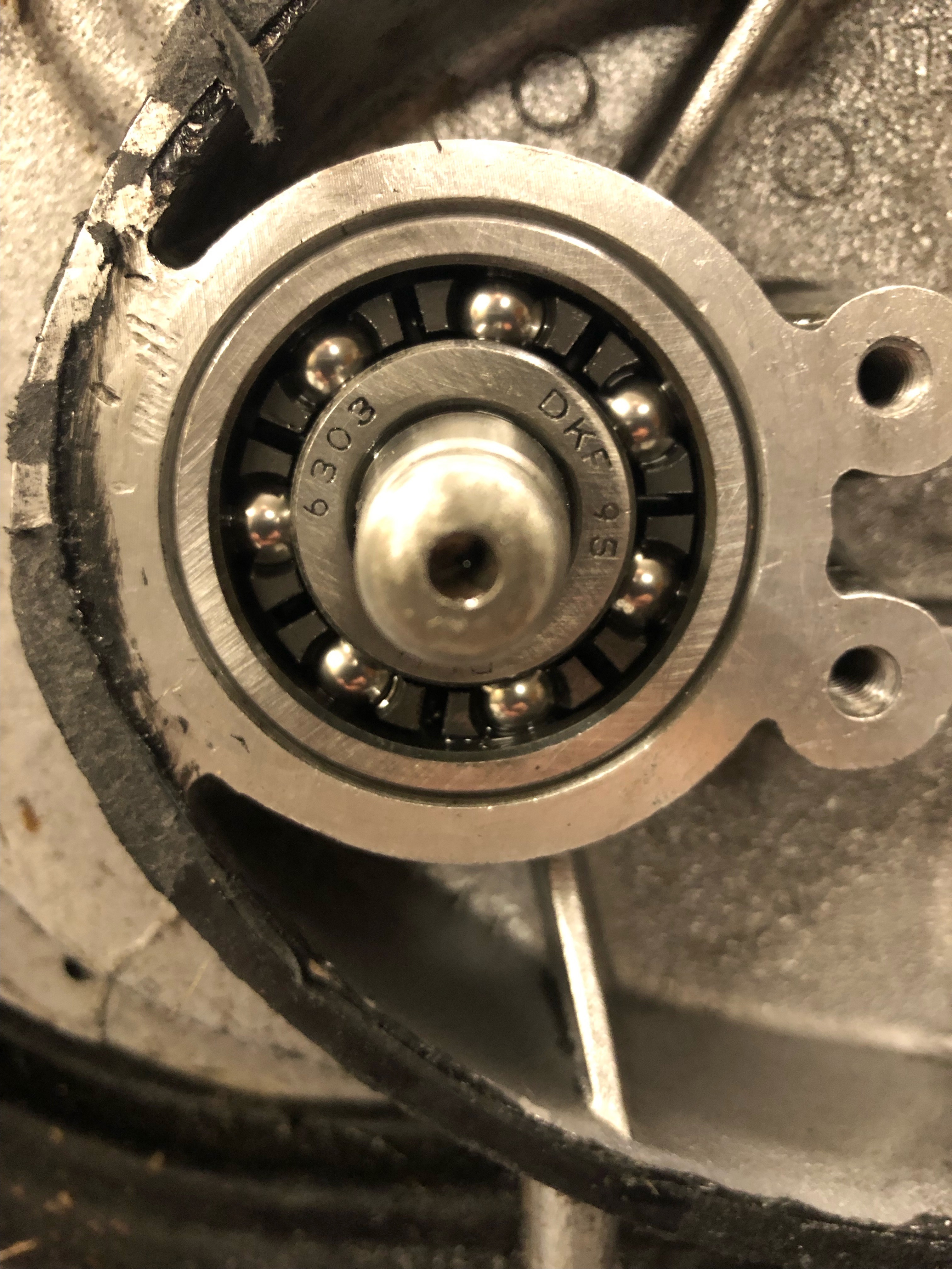

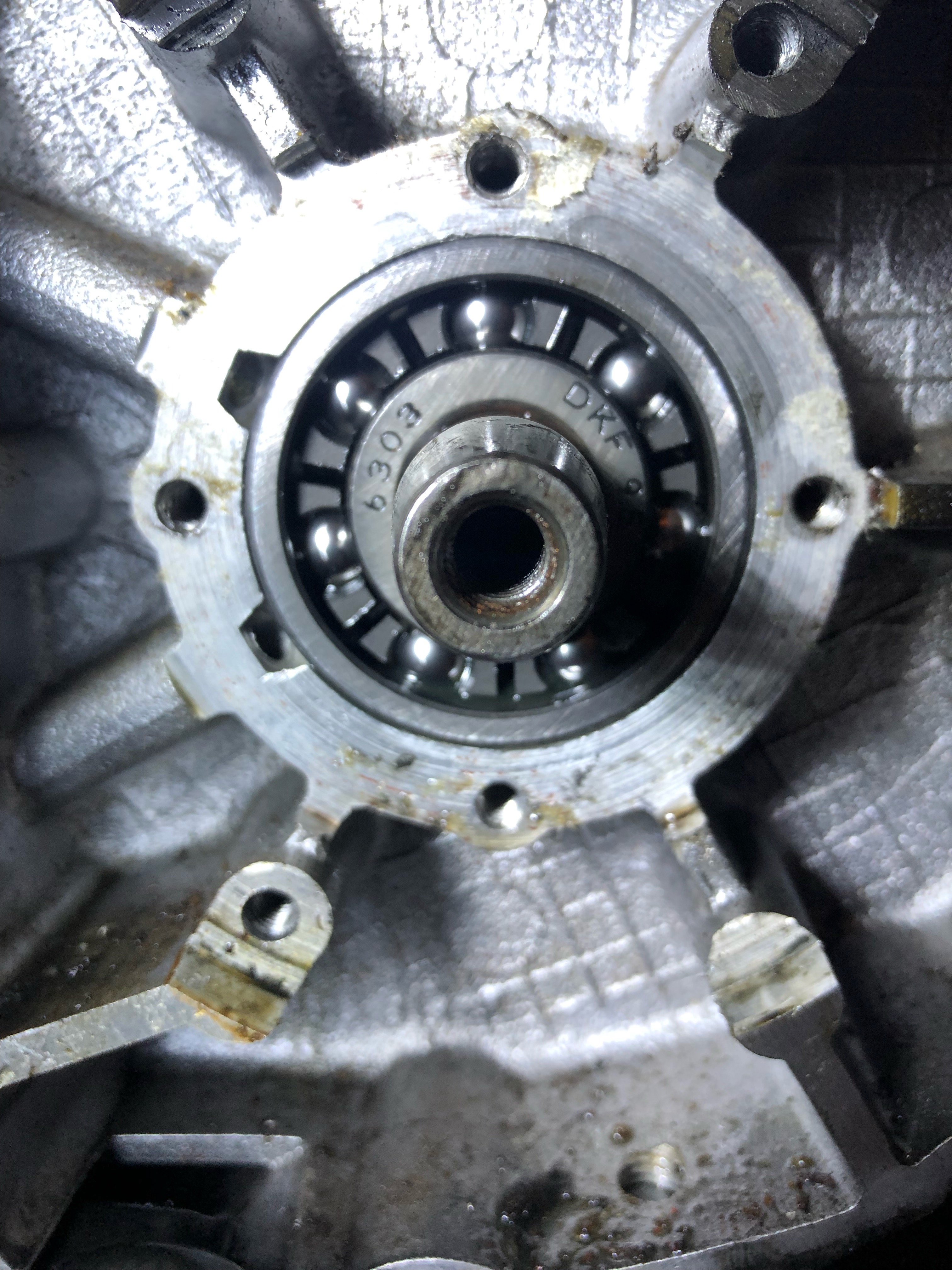

Well, I have stripped down the engine enough to expose the main bearings on both sides and both appear to be intact, nor can I detect any movement in the crank shaft.
I did notice that the LHS bearing is sitting proud of the casing and not flush but the RHS is flush however it's the side with the shim, gasket and cover cap, so not sure if the LHS should be flush or not, i'll need to read up on that for the rebuild.

RHS Main bearing
LHS Main Bearing sitting proud of the casing

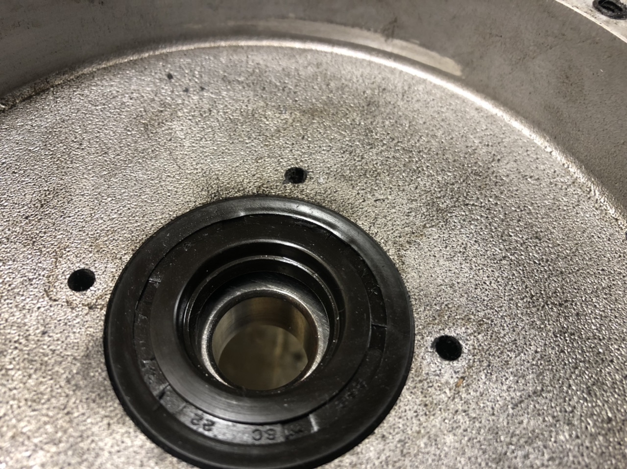

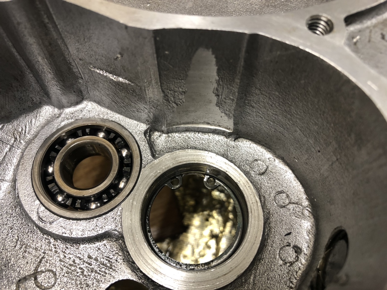

Pics of the damage:
Gears have ground a lot of material from here
Crank hitting casing here.

Postby Blurredman » Wed Dec 15, 2021 4:53 am
The only thing I can add to this, is the bearing behind the removable cap is indeed to be offset but with the help of the shim to be butted against the inside recess of the cap. I know this after doing the same proceedure on my es250 recently.
