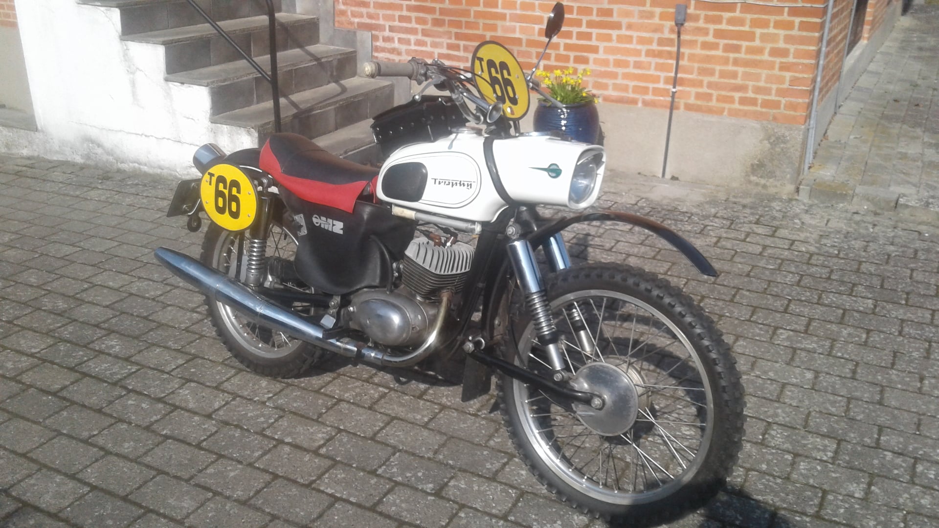

ScotBob wrote:Some pics:
What yours is a replica of i would say -

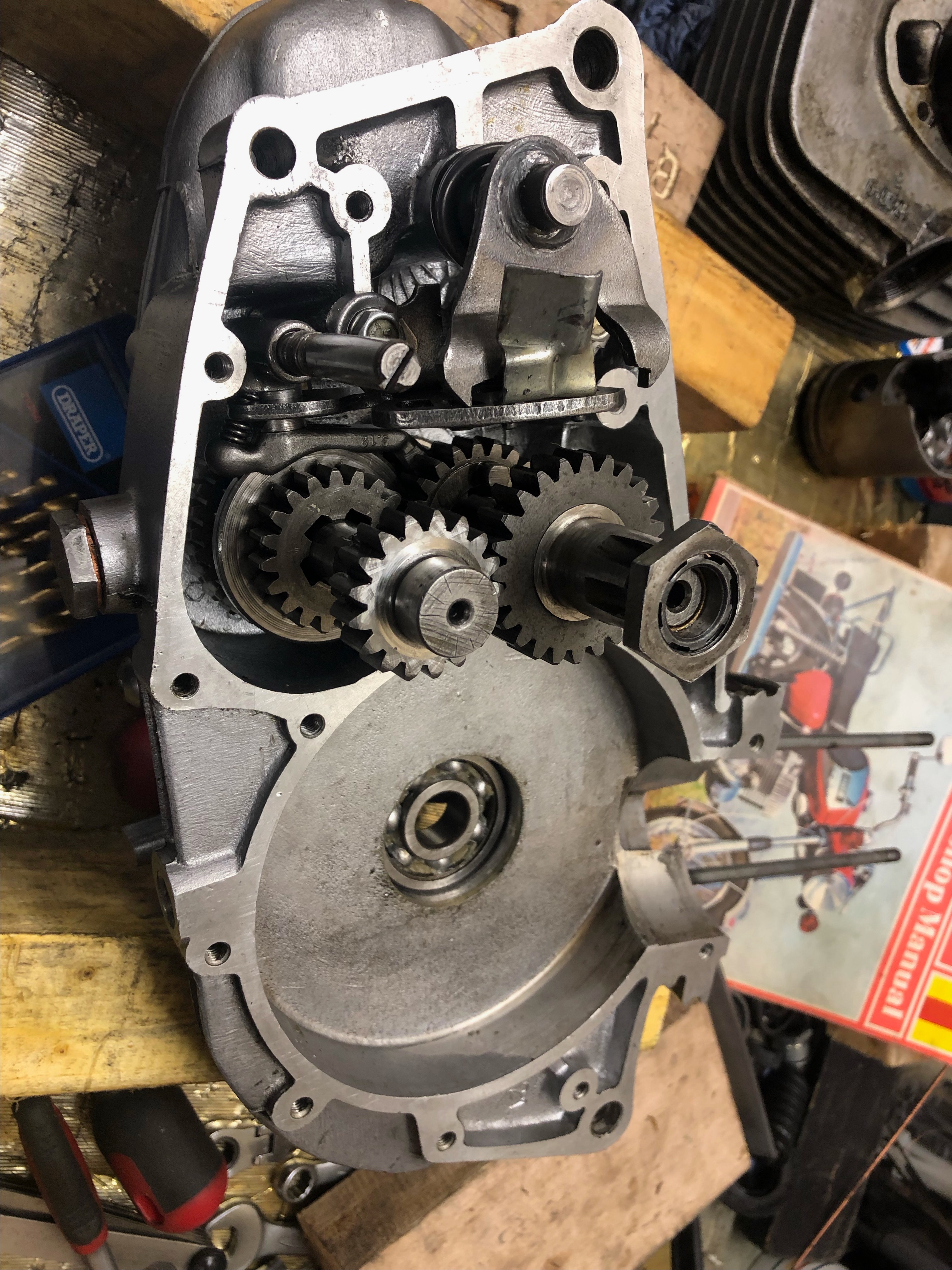

So I have assembled the LHS casing with all new bearings and reinstalled the gearbox; I have been trying to adjust the gearbox as per the manual but I just can't seem to get all the gears and neutral, no matter what I do I only seem to get four of the five positions.
Currently I have 1st to 4th selecting ok but cannot get neutral, when assembling the gearbox is there a specific start position for the dog to be in, I have tried it in different positions and the one that that has given most success was to start in 4th but now neutral is elusive,I've been at this for days and i'm sure it's something simple but surely it should not be this difficult.
Gears all worked fine and selected ok before disassembly and components are not excessively worn ;any clues as to what the issue might be?

Postby Blurredman » Sun Dec 26, 2021 3:48 pm
It might be difficult to select gears whilst it is in situ like that. Without the gears turning etc it can be difficult and actually mis-leading to make you think it isn't changing gears properly or at all. And even if you do turn the gears you're not going to do it as fast as the engine so it might seem notchy etc. The sequential nature of a motorcycle gearbox does require the gearbox to be spinning in order to go up the gears.

Postby ScotBob » Thu Dec 30, 2021 10:22 am
That's the gearbox assembled and all gears selecting plus neutral, no trick to it but for anyone doing it in the future, I found it much easier to set up if I initially assembled it so 4th gear was selected, then make the adjustments from there. All new bearings fitted in the casing too, awaiting crank seals and a number of other bits before I continue.

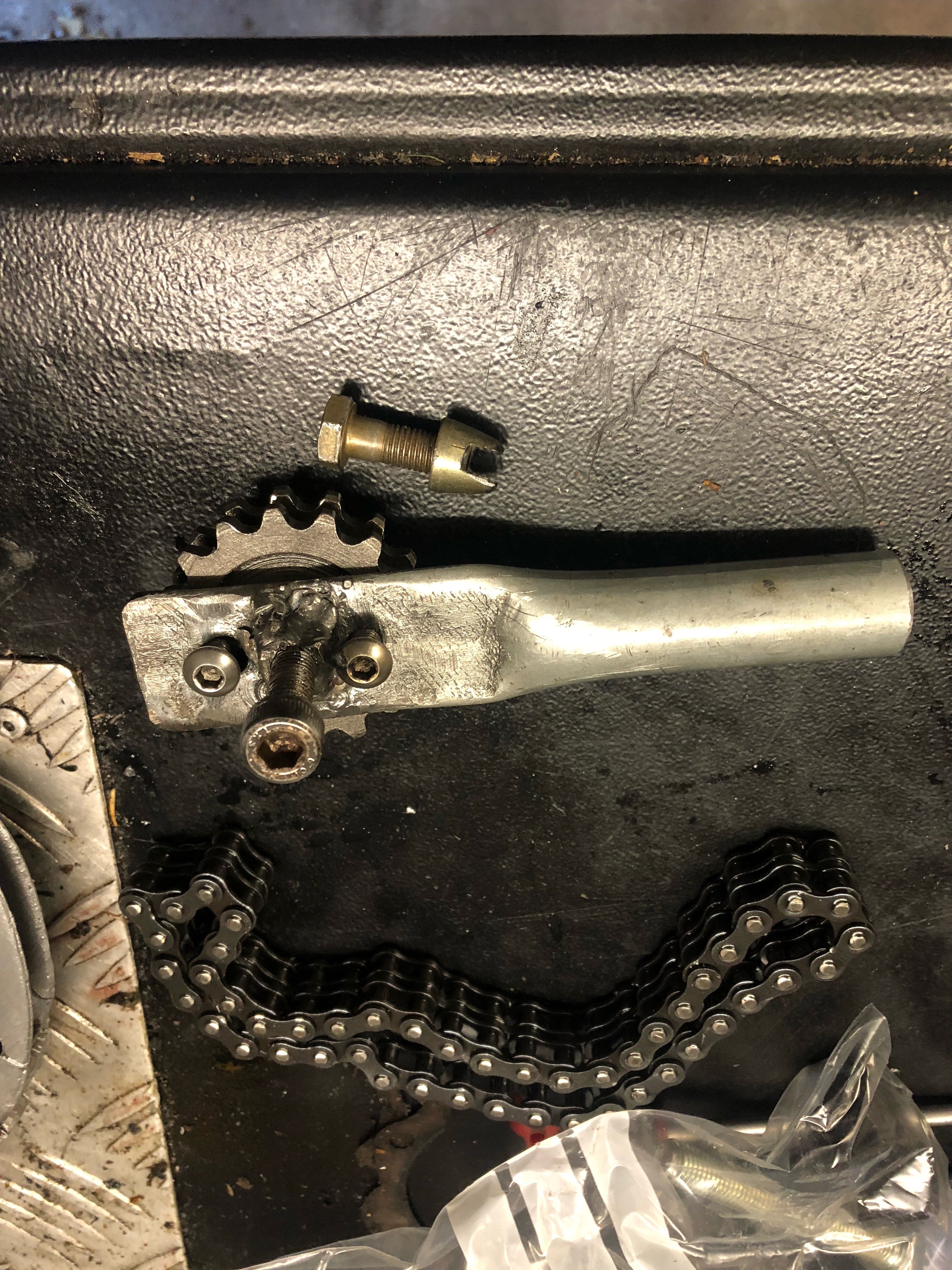

Next up was tools: I paid a lot of money before I started and bought in a set of tools supposedly required to split a ES, TS or ETZ model, again this turned out to be rubbish. Four tools in the kit; a standard bolt (most will have one lying around) to remove the generator, a flywheel puller for which I have no need, a clutch holding tool (I did use) and another tool for which I have no clue what it does but guess it's for an ETZ. In short for an ES or TS you don't need them and to hold the clutch you could easily make something up for nothing or find a workaround.
To remove the primary sprocket I had to make up a puller as a standard two or three legged item will not fit and I also made a tool to remove and replace the clutch pins that hold the springs and caps in place. All clutch springs were out of spec and will be replaced but the plates are in spec.
