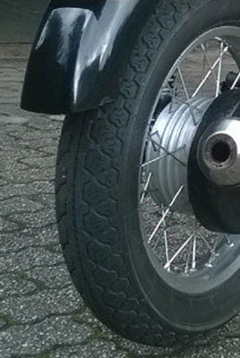

New tires on the TS250 since 1974...the DDR original tires looked good....but were very dry.

Pneumant's - thanks for those pics! Quite some cracking, but otherwise they still look quite reasonable.
Did they have a (DOT) date code?
Since 2000 the date code is WWYY, but before 2000 that was WWY (I think). So it might look like WW4 - if they have any...

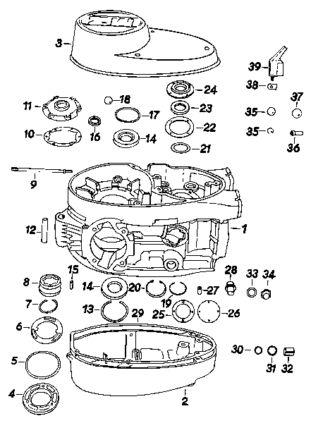

Edit: for your convenience the relevant drawing for the TS250:
It'll be items #14, crankcase seals D 30x62x10, both left & right. It is possible they are dried out & hardened, and therefore do not seal, but if they are worn due to rust you'll also have pitted corrosion in the bearings.
But once again: for loss of compression I'd start by taking the barrel off & look at the rings.

The MZ TS250 in question was stored inside for 40 years...with all fluids drained out of it....including the case oil. I'm sure once I started it up after its long slumber, the seals (item 14) failed. One other variable I forgot to include is once the bike stopped running, and I parked it for the evening, there was a small puddle of oil coming from the left side of the bike. I understand both seal 14 are only accessible by taking the engine case apart....or can they be removed from outside the case?
Many thanks for the diagram!

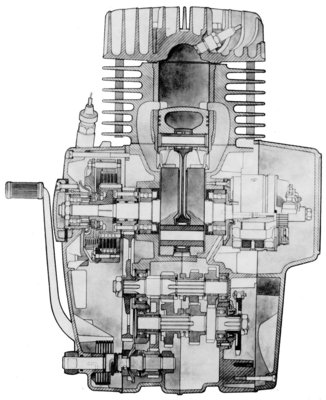

On the technical: this is a two-stroke engine. Seals #14 isolate the crankcase from the gearbox and the oil from that. There is normally no oil in the crankcase, lubrication of the conrod bearings and the cylinder/piston is by oil in the premix, while in this model the main bearings are lubricated by gearbox oil. See this pic:
If the engine leaks oil, it is not due to the crankshaft seals #14. Possibly the drain plug is leaking, or maybe it comes from the gearshift lever, output shaft seal, or something with that clutch thingy. Look carefully where it comes from (which is probably not exactly above the puddle of oil on the floor).
I'd be surprised if seals start to leak just by time, normally wear is required, but it is possible. It's also possible that during the initial running much accelerated wear was caused by some corrosion on the shaft that should be sealed. Nevertheless, the oil leak is probably not the cause of your running issues.
If you feel no (or a reduced) compression on the kickstart lever, I recommend you take the barrel off, and inspect bore/piston/rings. That is quite easy to do, and for instance insufficient lubrication (did you premix properly?) may also cause your problem.
On this model I don't think you can replace the seals #14 without taking the engine apart, the main bearings are in front of them.
