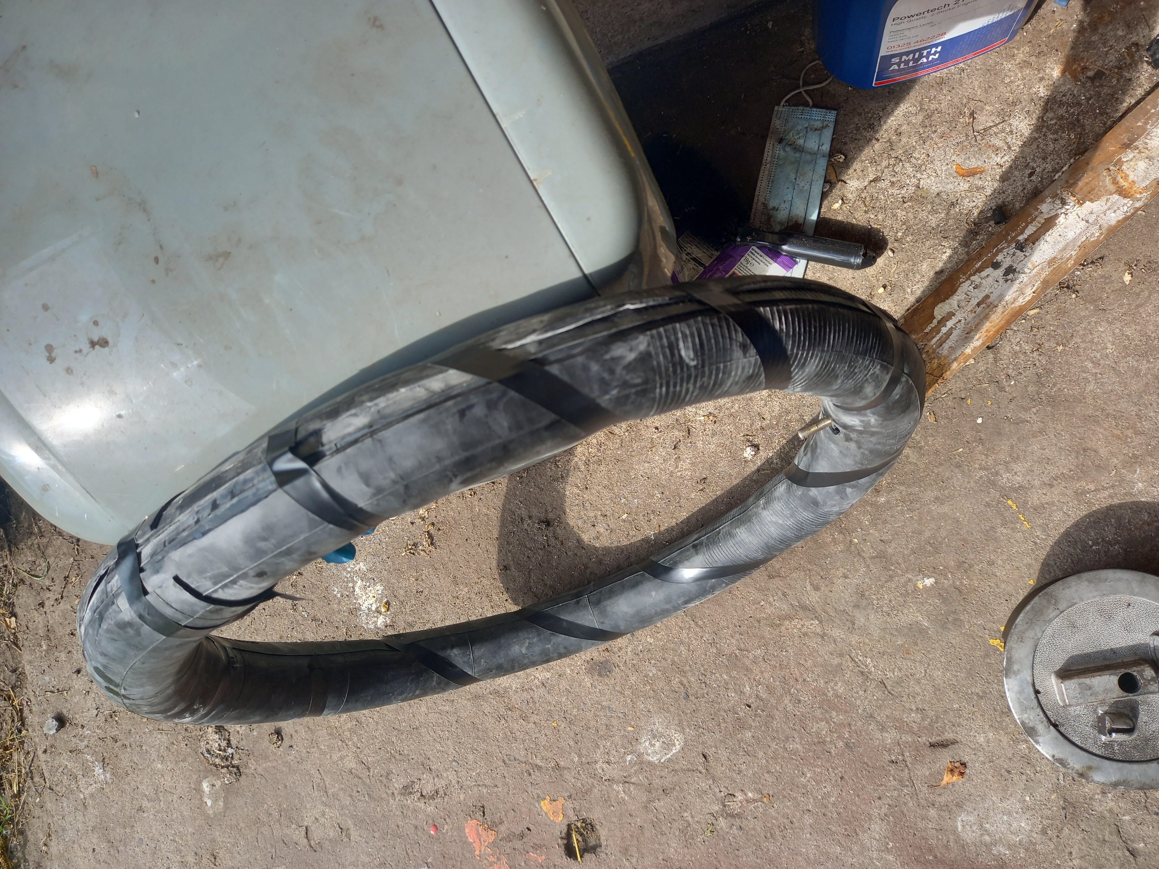

I've had a spate of rear wheel punctures my Jawa lately. Once thanks to a good honest screw in the tyre and twice due to the tube chafing against the corroded surface inside the rim.
Now I've taken a damaged tube, split it round the outside, and used it as a sleeve without a stressed surface to protect the inflated tube from the rough surface of the rim.
Obviously I now think I'm a total genius and I'm happy if this tip helps anyone else. I'm going to do it as a pre-emptive precaution every time I fit a new tyre from now on.

You sure there's sufficient space inside the tyre for this ?
And are you quite sure it won't overheat ?
What's wrong with a conventional rim tape, anyway ?

Tom, it is not an approach I was familiar with. Off the cuff: it may be a bit more difficult to get the dressed tube inside the tyre, but as people also manage with tyre mousse, that should be doable. The Jawa rims are, uhm, spacious enough, so it should fit. But my main question is: Why?
For protection from a rough steel rim, with loose corrosion parts, surely it should give some protection, but the more common approach to that is to properly clean the inside of the rim, and sand/filla it as required, and spray it with some protective coat. Tape may give problems with proper seating the tyre. I'm not talking about tape (or another cover) over the recessed nipples, that is common practice. But I actually wonder why the tube is chafing against the inside of the rim, shouldn't that just sit still under pressure?
Anyway, why not give it a try & please let us know how you fare!

A wide rim tape is good for the inside of the wheel, or should be.
But if trying to prevent punctures, surely the split in the old inner tube should be in the inside, so that the majority of the unbroken surface is on the outter side of the tube (against tyre) ?

Hi all and thanks for your comments. Just been out an hour's ride (ie, about 20 miles how I ride!) and the tyre's still up. What I've installed is, effectively, extra wide rim tape. With hindsight I could've trimmed the outer tube to the width across the rim (including the dip, obviously!) and avoided the excess riding up inside the tyre wall.

PLUS ... my genius invention protects against nipping the tube whilst fitting a tyre.
