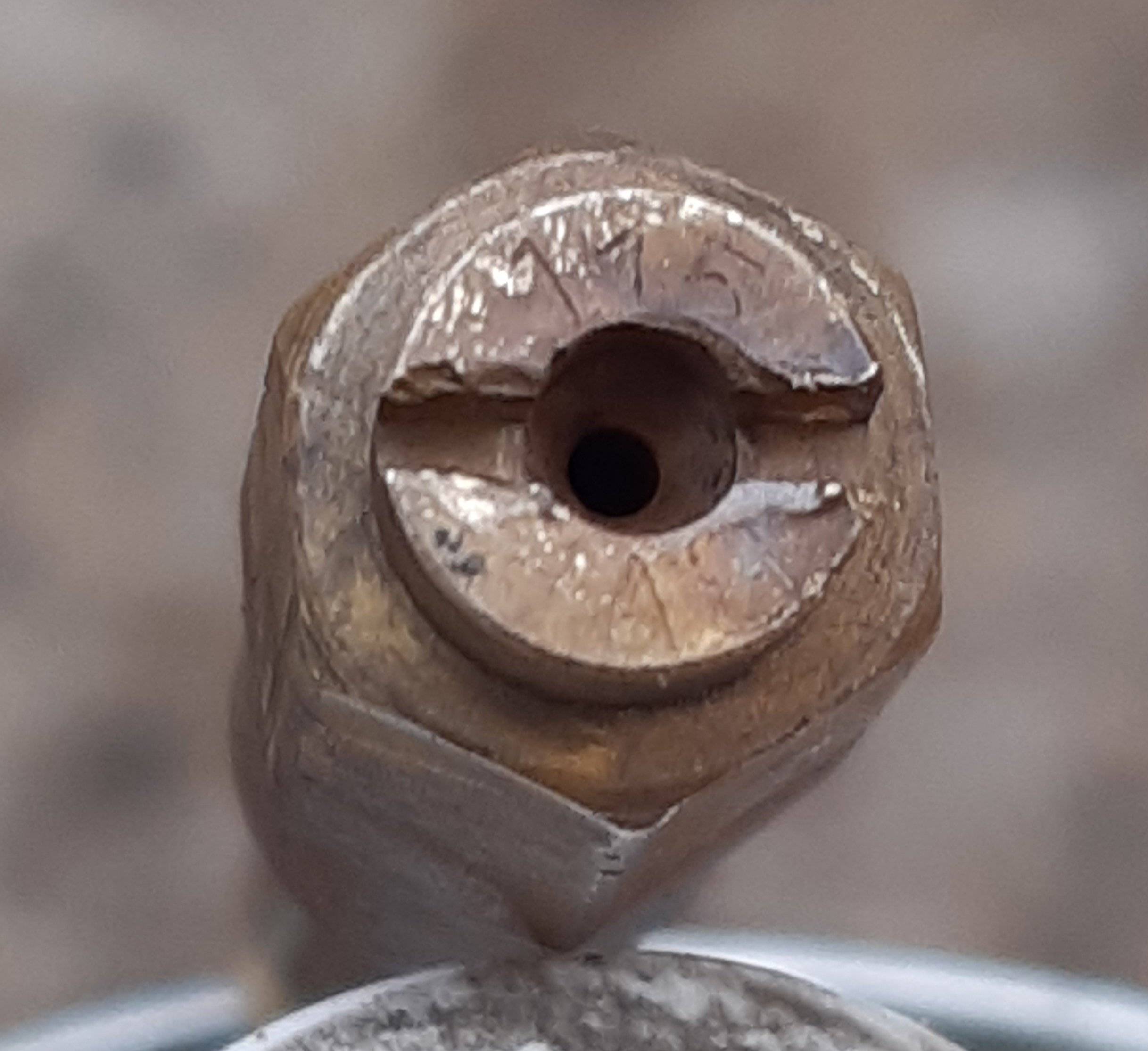

This is the current main jet, but I can't see a 90 or 95 on it.

I would directly compare both the old carb jets and the replacement carb jets.
I know your symptoms also point out to what Guesi says in that defective coil (overheating) or even something as simple as a clogged fuel tank cap vent can cause these issues but if the bike was working before the carb change, then perhaps the first step is to put the original carburettor back on and see what happens. If you can ride it successfully for more than a mile or two as of late then you have your culprit. The checking for spark etc can be a bit of a red herring when investigating coil problems because you think it's the spark plug or whatever but by that time the coil has cooled down a little bit enough to give some more usage for another half an hour. Been there, done that.
This is what I would do..
Take off replacement carb.
Open up both carbs simultaniously, but carefully not to mix the individual parts up !!!
Compare jets.
Put back on original carb to test. If all is good, I'd probably transfer the jets to the replacement carb and see how that felt??????
I see 115 on that picture btw. You are expecting a 90?

Both carbs are 24mm.
Looking at the jets, the old carb had a main of 95 and the new one 115.
Swapping the smaller jet into the new carb has got the best of both worlds.
A fine riding bike and the ability to set a steady idle.
The needle jet in the new carb is 70 whereas the old one was 65 but these are not interchangeable, otherwise I'd be tempted to swap them as well.
