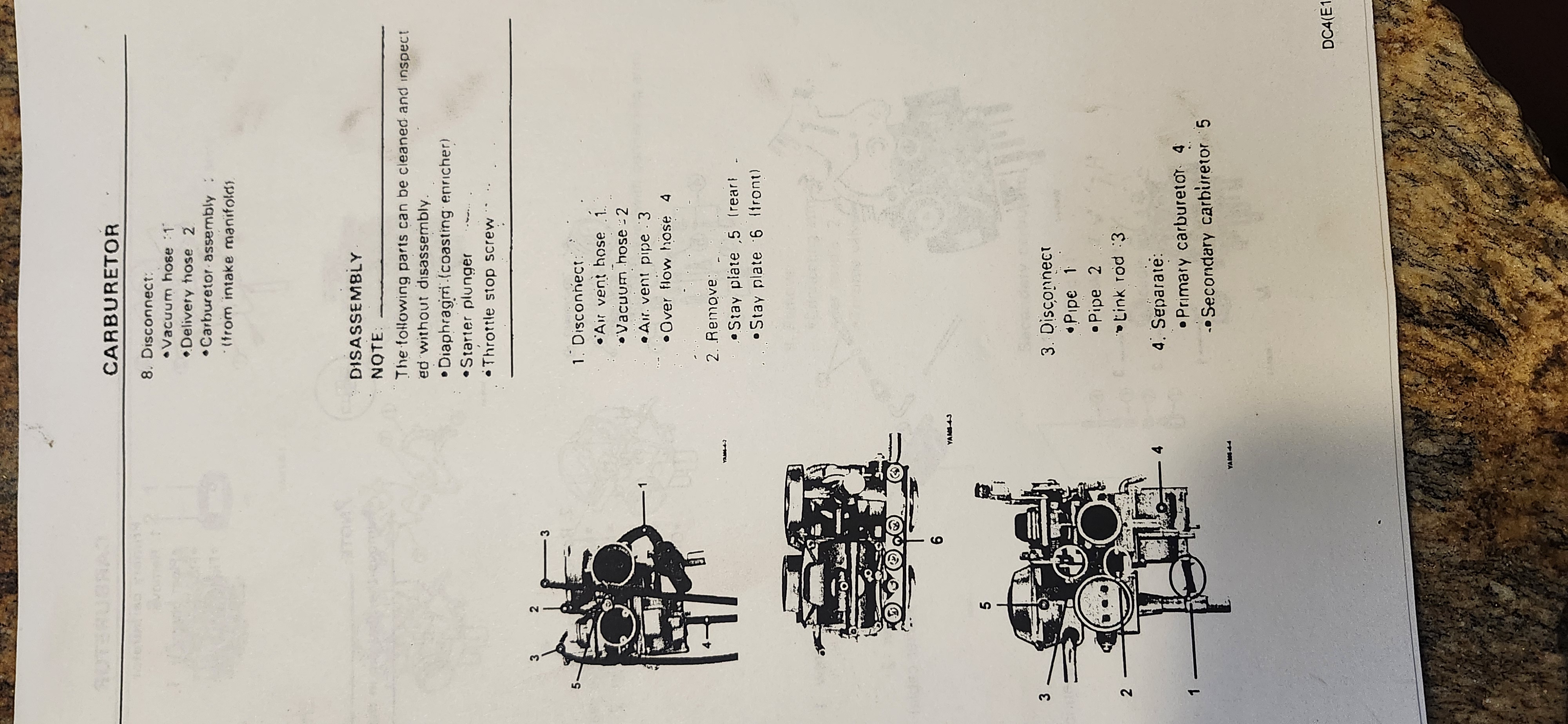

Hi trying to put together a Skorpion basket case ..anyone have a diagram or such that shows the various carburetror hose connections ?
Thanks

I bought a Skorpion a few months ago, and the previous owner who had died, was the service manager at the dealership where the bike came from, and I received an enormous pile of literature with the bike. There is a service manual specifically for the engine, including a carb diagram like you asked for. I'll try to post a picture of the diagram, but it's a miserable mimeograph looking copy that I suspect was taken from a Yamaha document. Hope you can make heads or tails out of it, but if not, I would strongly suggest looking at a Yamaha forum geared towards the 660cc Tenere of those days. This is the same motor.
