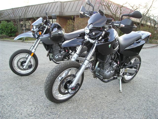

I love mine too!!! it is a 2001 (brian), I have put almost 10,000 miles on it, and have had no problems. I change the oil every 2000-2500 miles, I use synthetic oil, and check it every 500 miles. some parts from the XT carry over (hubs, oil filter, sprockets...) some parts from the KTM LC4's (front brake light switch, some controls and stuff)
I flog the shit out of it, and deffinitely don't baby it. at least 2-5 wheelies every time it leaves the garage (some times just to do wheelies :twisted:) and I commute 60 miles to work on it. It backs in easily, RAILS in the tight stuff, and stops very well. rode my XT600 40k until it shucked the rod, but I don't think I changed or checked the oil more than 4 or 5 times...
here's mine and brians at a parking lot flog session...

...has anyone here put the rollerblade-wheels on the ends of the axles?

Postby 125SMash » Sat Jun 12, 2004 11:49 am
phlats bike in the pic above seems to have those installed.

Fitting roller blade wheels is real easy on teh Baggy. Drill each end of the spindles about 1" deep and tap a tread in it. This tread should match the internal sive of teh roller blade wheel bearings (prob 6mm). Job done.
This is popular in the UK as we have to have them fitted to take part in most track days. Some even insist in them being fitted to the underside of the foot reasts now as well.

Postby phlat65 » Sat Jun 12, 2004 7:25 pm
you can see my skate board wheels in the above picture.. had a buddy center drill them in his lathe..

Postby cat-tard » Sun Jun 13, 2004 3:25 am
OK - I gotchya - went ahead and drilled and tapped M6 even though the bearing ID is 1/4" (it's really really close).
...are you guys leaving the bearings in the things so the wheels spin? It seems kinda apt to snap off the bolt that way...

Postby keithcross » Sun Jun 13, 2004 5:20 am
I would have thought that if the wheel was ridgedley fixed it would be more likely for the bolt to snap. If the bearing is left in then the wheel can obsorb the ititial contact with the ground by spinning. After that I cant see that the bolt would be more likely to snap.
