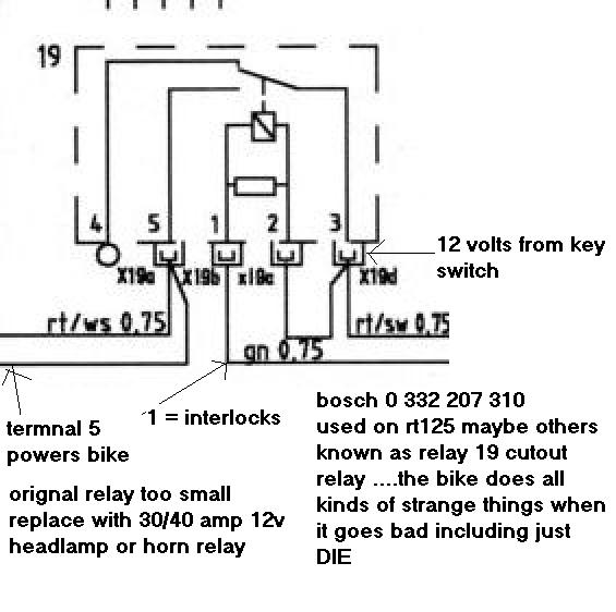

Postby DAVID THOMPSON » Tue Aug 07, 2007 12:37 am
relay 19 (cutout relay) part of side stand interlock wireing and supplys cdi box with power....
look close at this relay it is to small and it failed the other day on my rt125
i have been having funny tach readings most of the summer....
from time to time bike would not start with kick stand down..
then last Thursday it just died
i jumped pin 3 to pin 5 and rode it home
replaced relay and no trouble for 6 days now
ar dave
ps on my rt125 it is mounted beside the battery and it is gray in color
the contacts carry a lot of current and supply's the cdi box on my rt125
so funny tach reading from funny voltage supply to cdi box ????
cdi box drives tach on most bikes
SEE ALSO HERE FOR REPLACEMENT RELAY DRAWING
http://www.mzriders.com/mz/viewtopic.php?p=12180#12180
